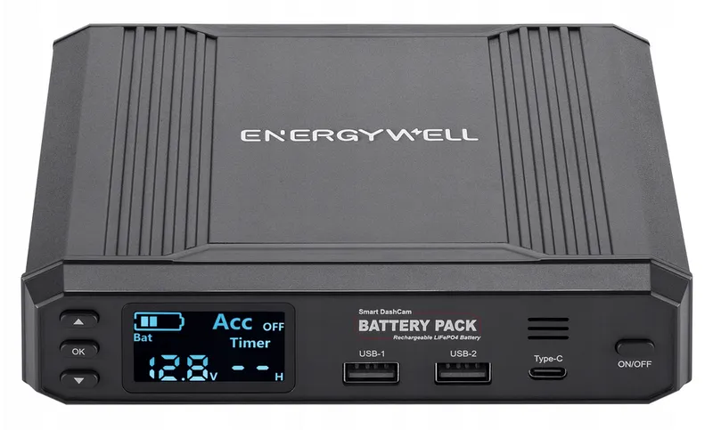

It should also allow for easy input for solar panels for those who have extra cars who park outside.
The only current dash cam battery pack that has this is the Energy Well P6.
The charge input connector is a barrel connector used by some solar panels.
Unfortunately it's not available in the US.
It's only sold in Canada, and EU.
