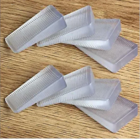

Side windows are usually more upright, (straight up & down) than sloped windshields.
So that may be another challenge.
60deg adjustment might not be enough for upright side windows. An optional 30deg wedge between the mount and the glass could fix that.
