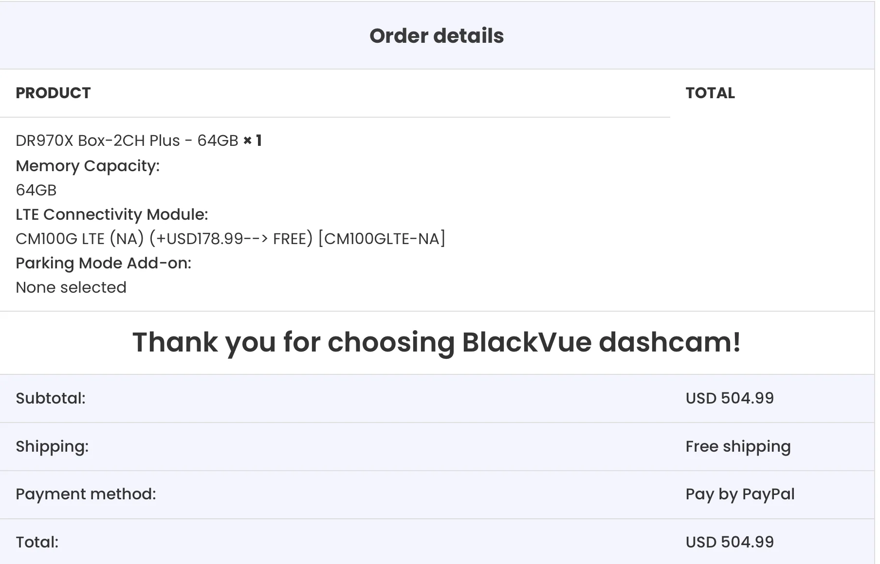

I was looking at the DR970X Box model... for a couple of reasons. Smaller form factor on the windshield, can be installed away from the hottest part of the car (I'm in Florida), and offers some theft protection for the device itself. When I was checking it out, I saw that BlackVue was having a sale. Ordered direct from them... No tax. No shipping. Free CM100LTE module. That's a hard deal to beat if you are in the market. They are also offering a free CM100LTE module on the non-box version, and a free 256GB memory card upgrade on the LTE version.
Their free CM100LTE module offer is great. Especially when they offer 3 versions of it so you can choose that correct one for your country.
You could have got an extra 10% off with code LSEATER10
