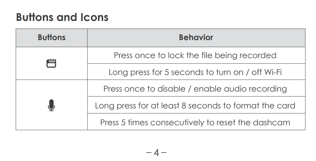

Welcome to the club @sabertr
1.) Are you using VIOFO Brand SD Card?
2.) Can you long press “lock” button for 5 seconds to turn on Wi-Fi?
3.) Can you connect with APP to perform factory reset / default setting using APP?
4.) How did you perform hard reset VS1?
Did you use the procedure listed in User Manual?
Short press Mic button 5 times?
See attached screenshot.
5.) Does VS1 respond to Voice Commands?

To answer each point:
  1. Yes, using the official VIOFO 32GB card that came in the box
  2. No — the camera shuts down immediately after startup, not enough time to long press anything
  3. Same issue — shuts down before I can connect via app
  4. Yes, followed the manual procedure, short pressed mic button 5 times — no difference
  5. No response to voice commands — again, shuts down too fast
Basically the camera doesn't stay on long enough to perform any of these steps. The issue was resolved though — VIOFO support agreed to send a replacement. 👍
