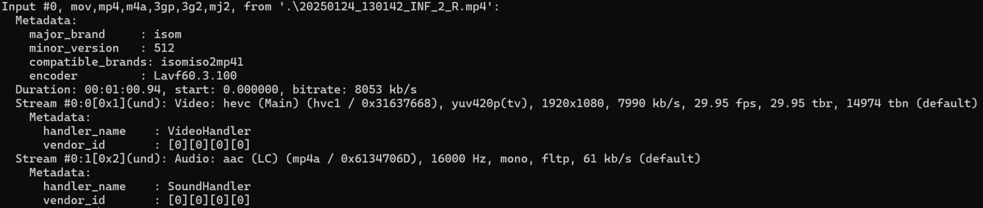

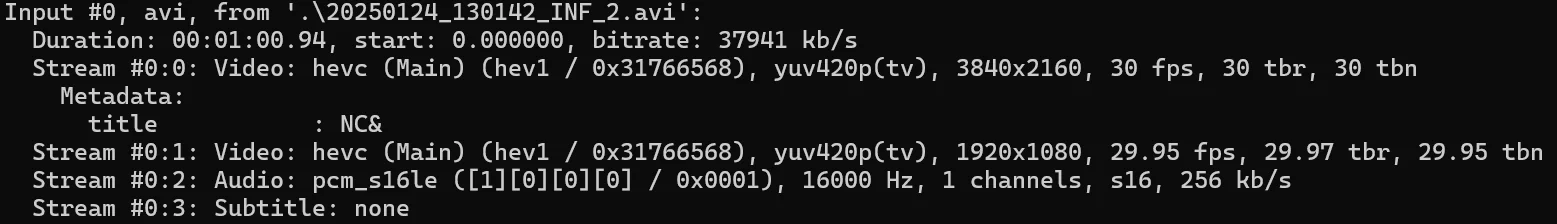

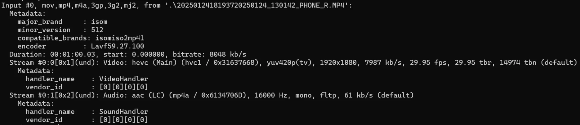

The D21-4K bitrate is low compared to other 4K dash cameras. I'm the image quality on the D21-4K is set to "High" which is the highest setting for that setting. The D21-4K is using the Sony STARVIS 2 IMX678 image sensor just like the A229 Pro / A329, so no it's not being upscaled to 4K.
The Vueroid 4K looks so much worse than Viofo 4K because of the compression choice. 1/3rd less bitrate introduces a LOT more noise into the image. It is visible in both day and nighttime clarity. If the hardware permits, Vueroid Engineers need make serious adjustments to firmware settings to correct the issue.

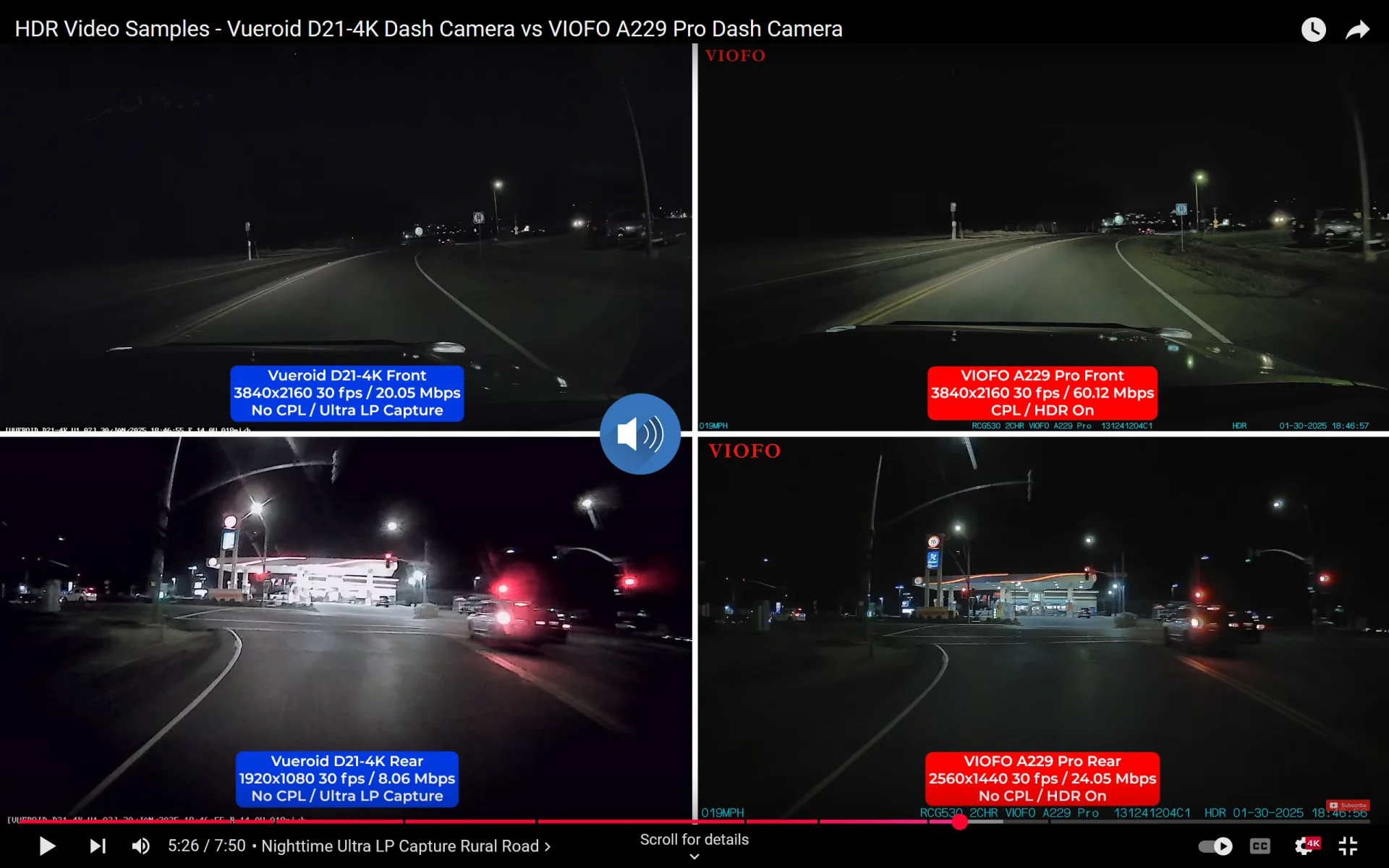

FYI:
In image below: Daytime Viofo you can read true and Car is in Focus. In Vueroid Liberty is hard to read and black car has a more crisp appearance.
In Night time, Vueroid rear is too "Blown Out" and over exposed.
