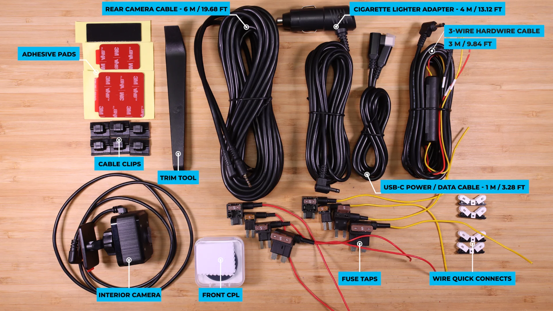

Here are my unboxing pictures for the S1-QHD Infinite 3CH dash camera.
vueroid_s1qhd_unboxing_pics_qhd00.webpvueroid_s1qhd_unboxing_pics_qhd01.webpvueroid_s1qhd_unboxing_pics_qhd04.webp
vueroid_s1qhd_unboxing_pics_qhd09.webpvueroid_s1qhd_unboxing_pics_qhd10.webpvueroid_s1qhd_unboxing_pics_qhd11.webpvueroid_s1qhd_unboxing_pics_qhd12.webp
vueroid_s1qhd_unboxing_pics_qhd05.webpvueroid_s1qhd_unboxing_pics_qhd06.webpvueroid_s1qhd_unboxing_pics_qhd07.webp

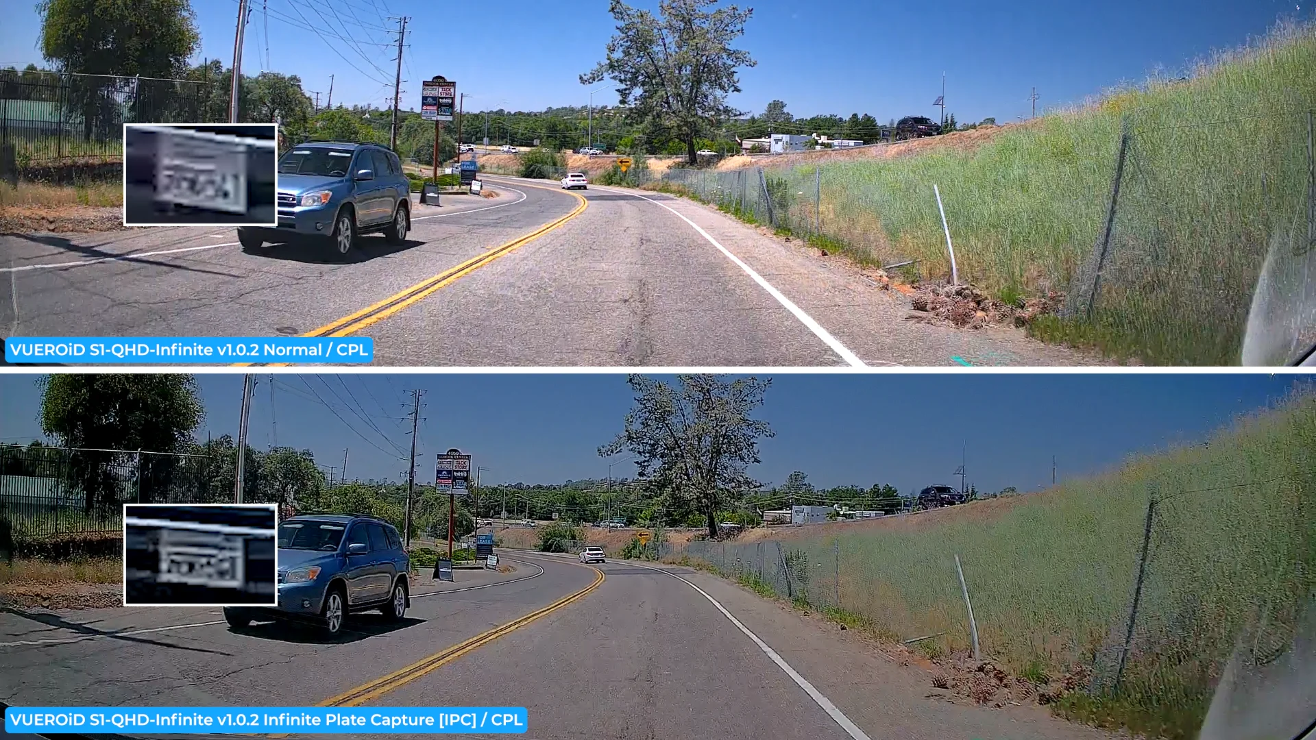

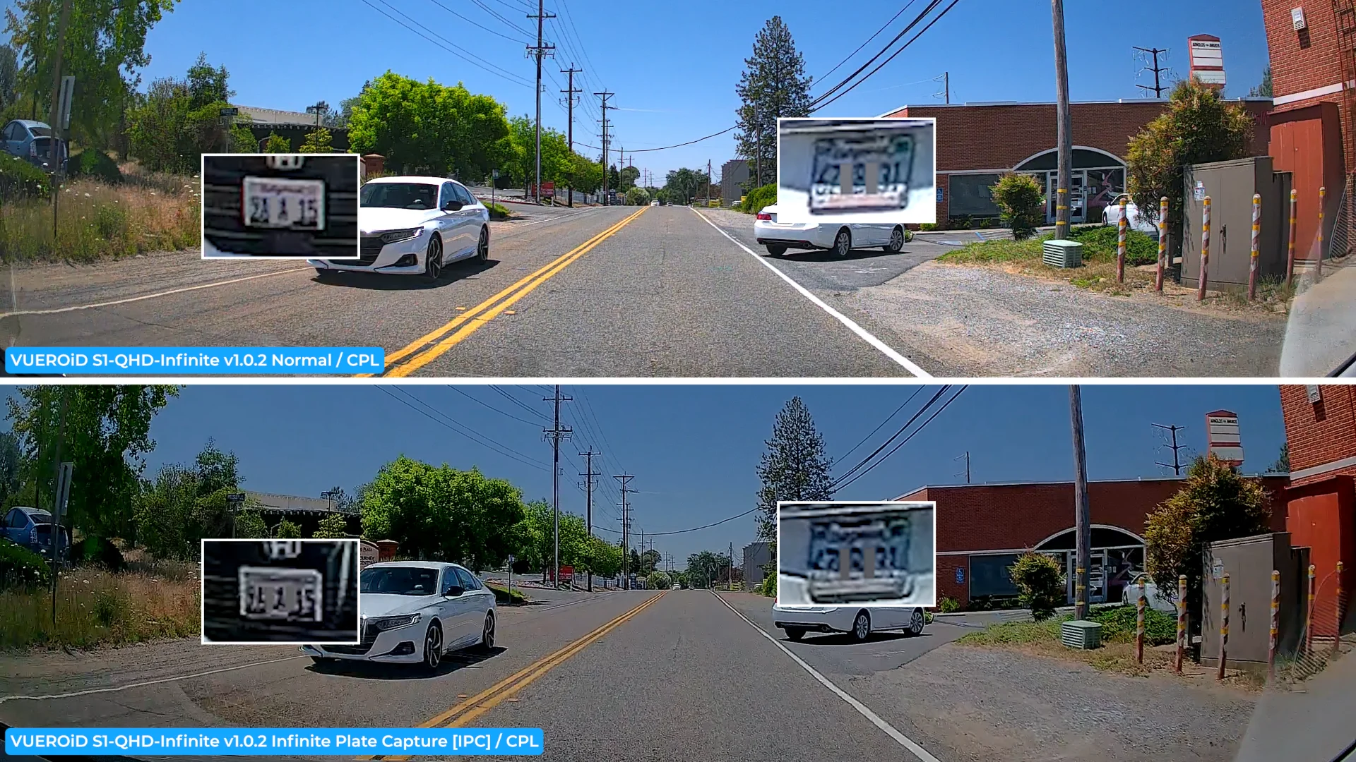

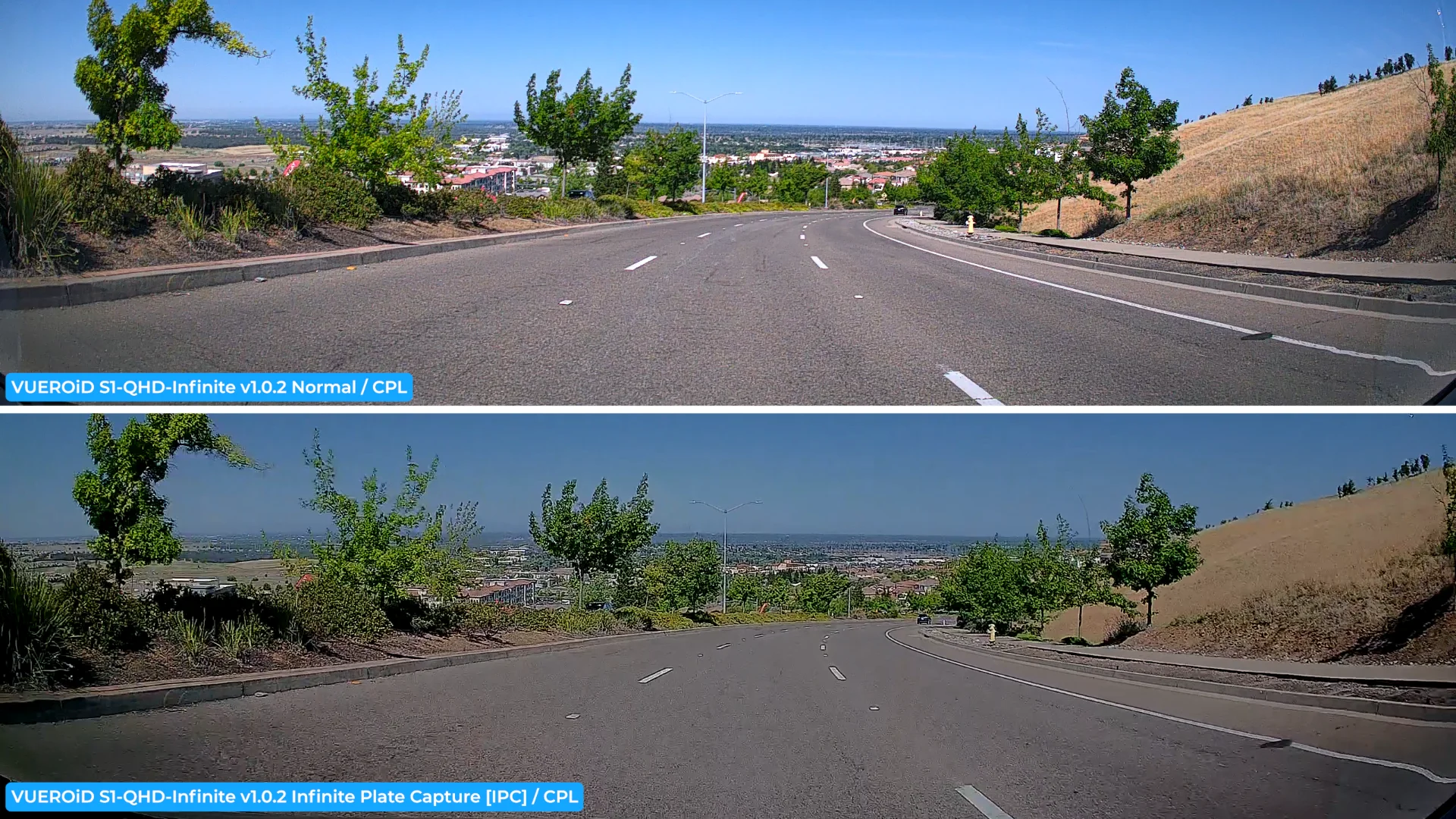

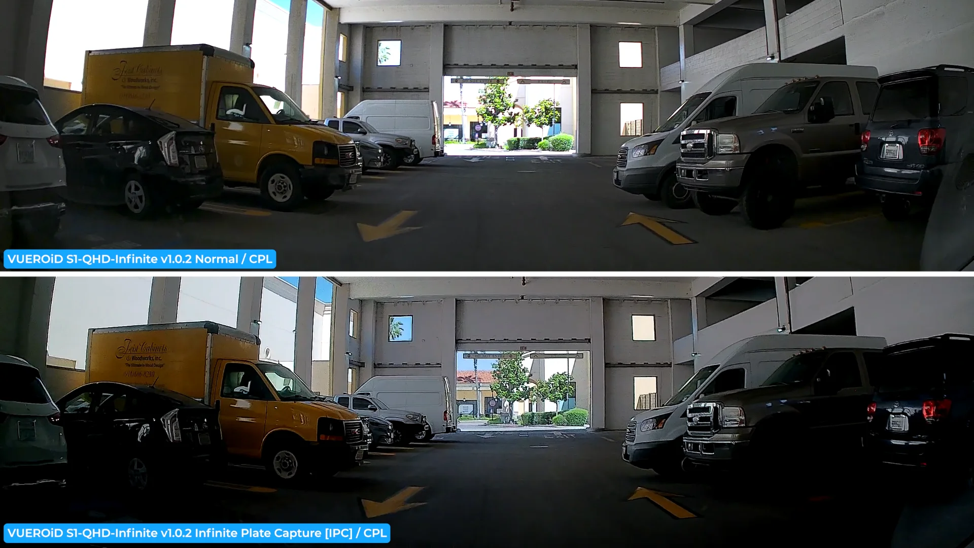

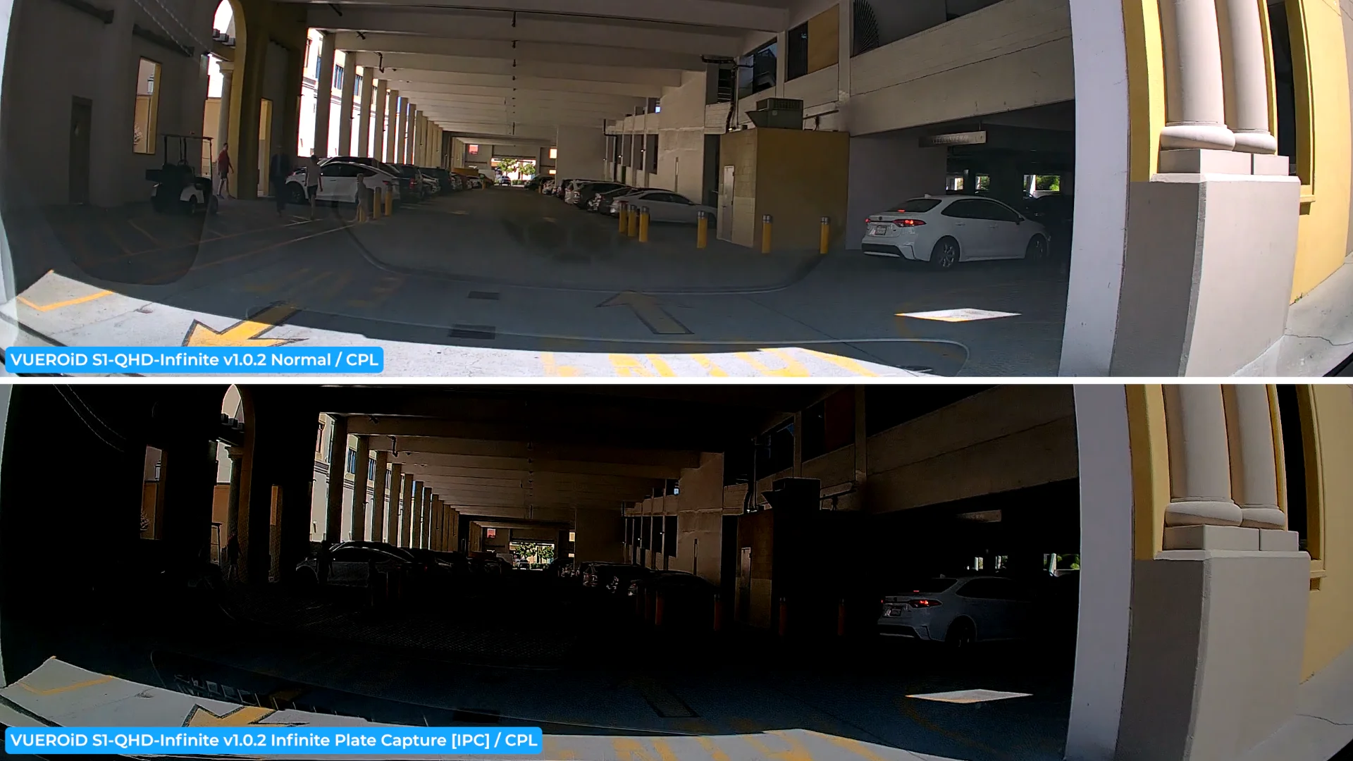

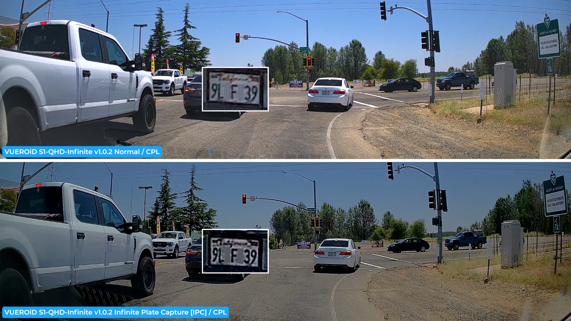

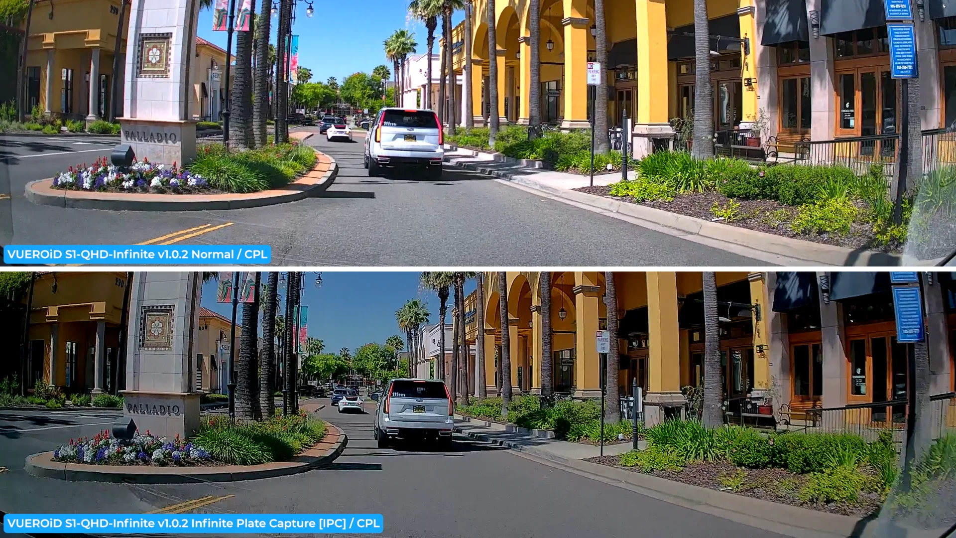

    • Video Enhancing Modes
      • Driving Footage
        • Normal [SDR / No HDR] – Front Camera Only

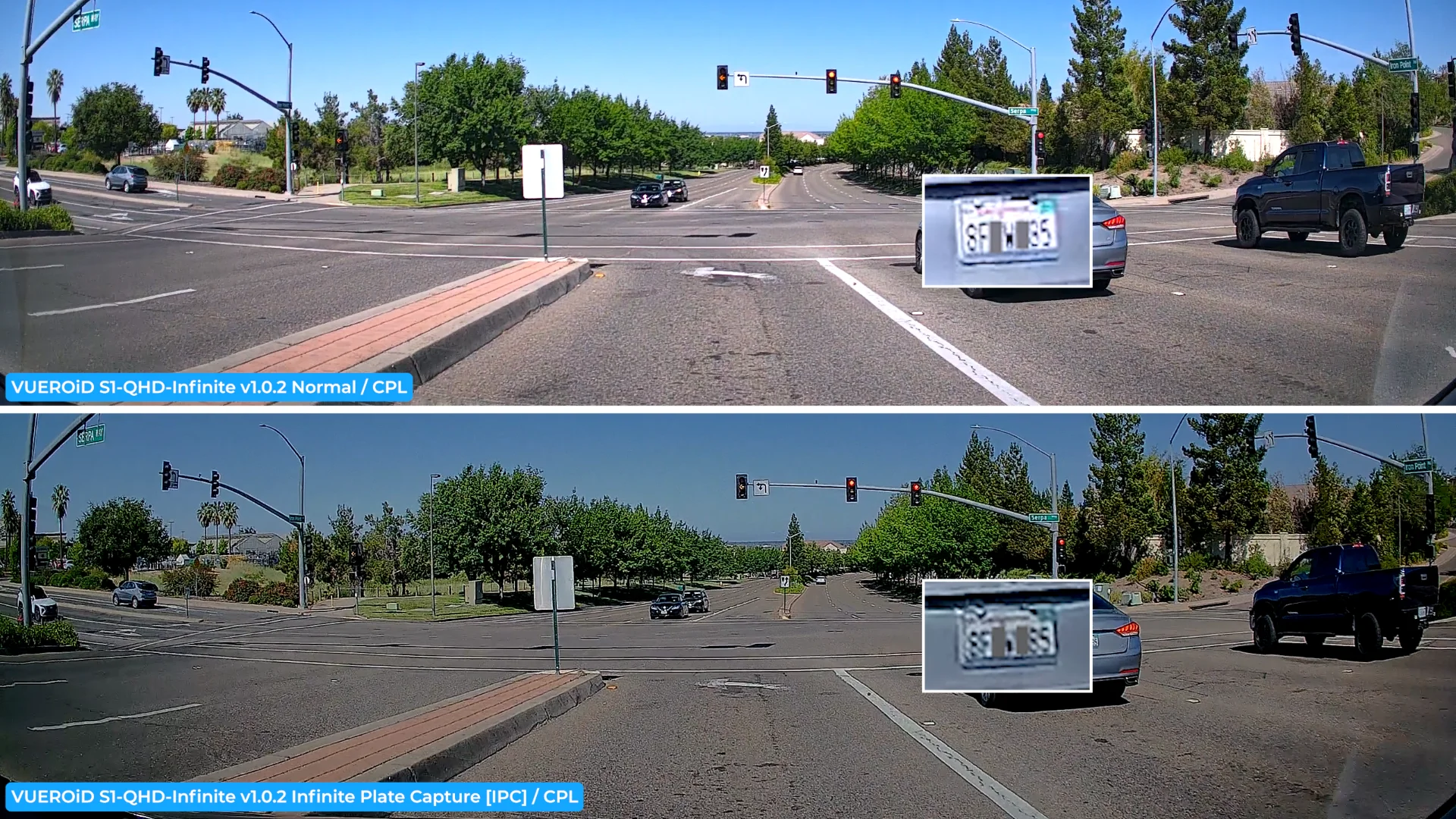

        • Infinite Plate Capture [IPC] – Front Camera Only
          • The front camera status line shows "IPC" when IPC is active.
          • IPC is a specially tuned version of HDR with a focus on trying to capture license plates as clearly as possible.
        • HDR
          • High Dynamic Range [HDR] is supported for the front, rear, and interior cameras. You can configure when HDR is enabled for the front camera, but HDR is always enabled for the rear and interior cameras.
        • HDR or IPC for the front camera can be enabled all the time, or a "Timer" feature is present to enable/disable HDR or IPC based on a time schedule.

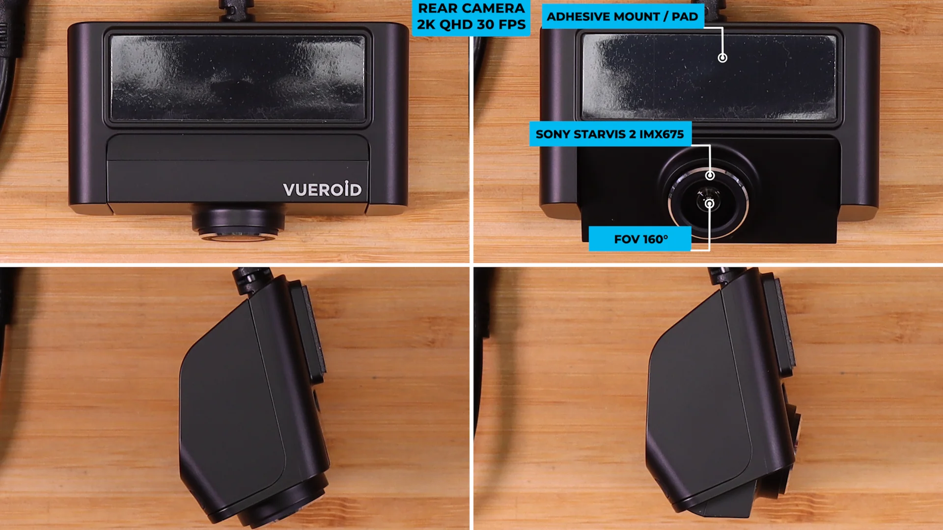

  • Rear Camera
    • Resolution: 2K QHD
    • Image Sensor: Sony STARVIS 2 IMX675
    • Lens FOV: 160 degrees
    • CPL Filter Available: No
    • Rear Camera Cable
      • The S1-QHD Infinite rear camera cable looks like the Vueroid D21-4K rear camera cable, but they are not compatible.
      • If you're upgrading from the D21-4K dash camera, you must use the rear camera cable supplied with the S1-QHD Infinite [6 M / 19.68 FT]

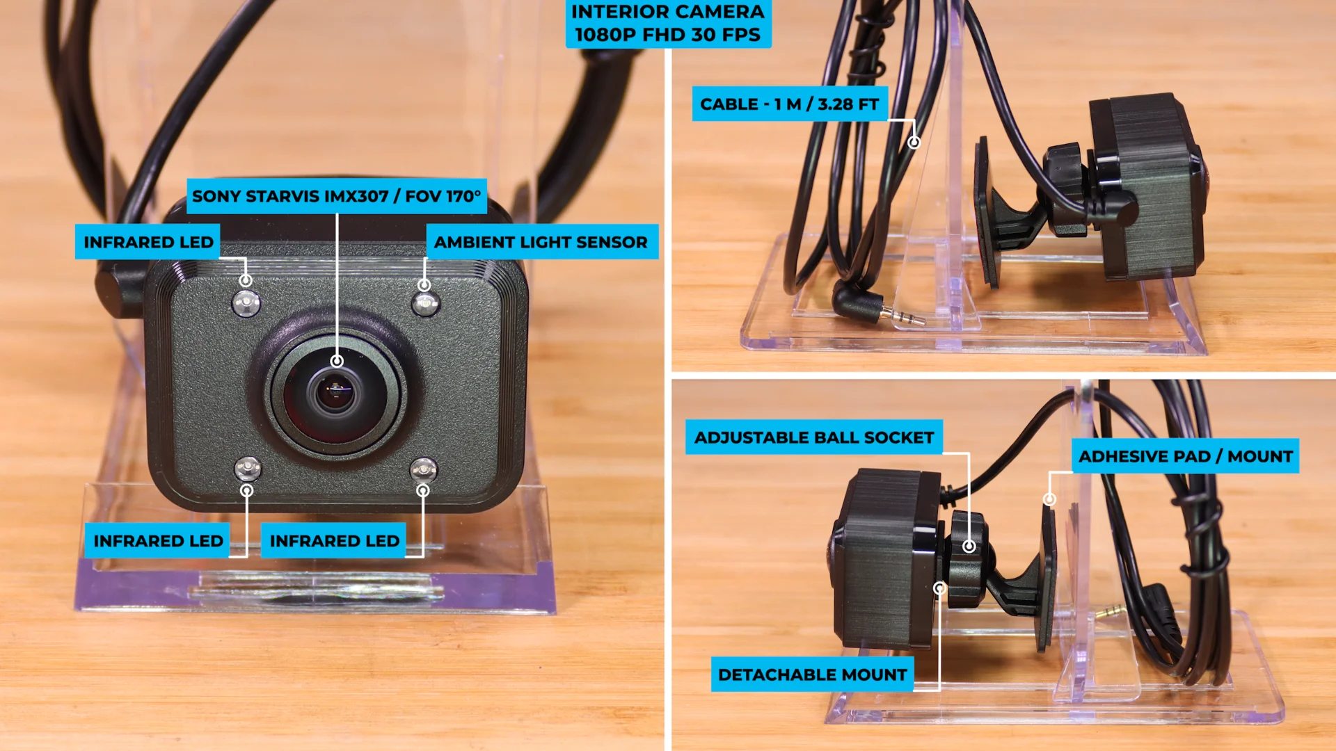

  • Interior Camera [3-Channel configurations]
    • Resolution: 1080p FHD
    • Image Sensor: Sony IMX307
    • Lens FOV: 170 degrees
    • IR LEDs: Three are used to help illuminate the vehicle's passenger compartment at night
    • Ambient Light Sensor: Yes

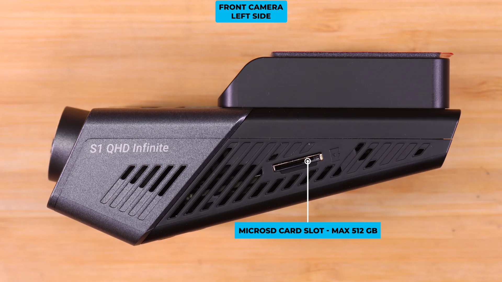

  • Storage
    • MicroSD:
      • Max capacity of 512GB
      • Recommended: 256 GB minimum
    • The microSD card's file system must be formatted by the S1-QHD to configure the TFF [Three Free File] system used by the S1-QHD.
    • The TFF system is a FAT32 compatible file system, so any computer or phone that can read files from a FAT32 formatted microSD card can access the files on the microSD cards formatted by the S1-QHD [just like with the older D21-4K dash camera from Vueroid]

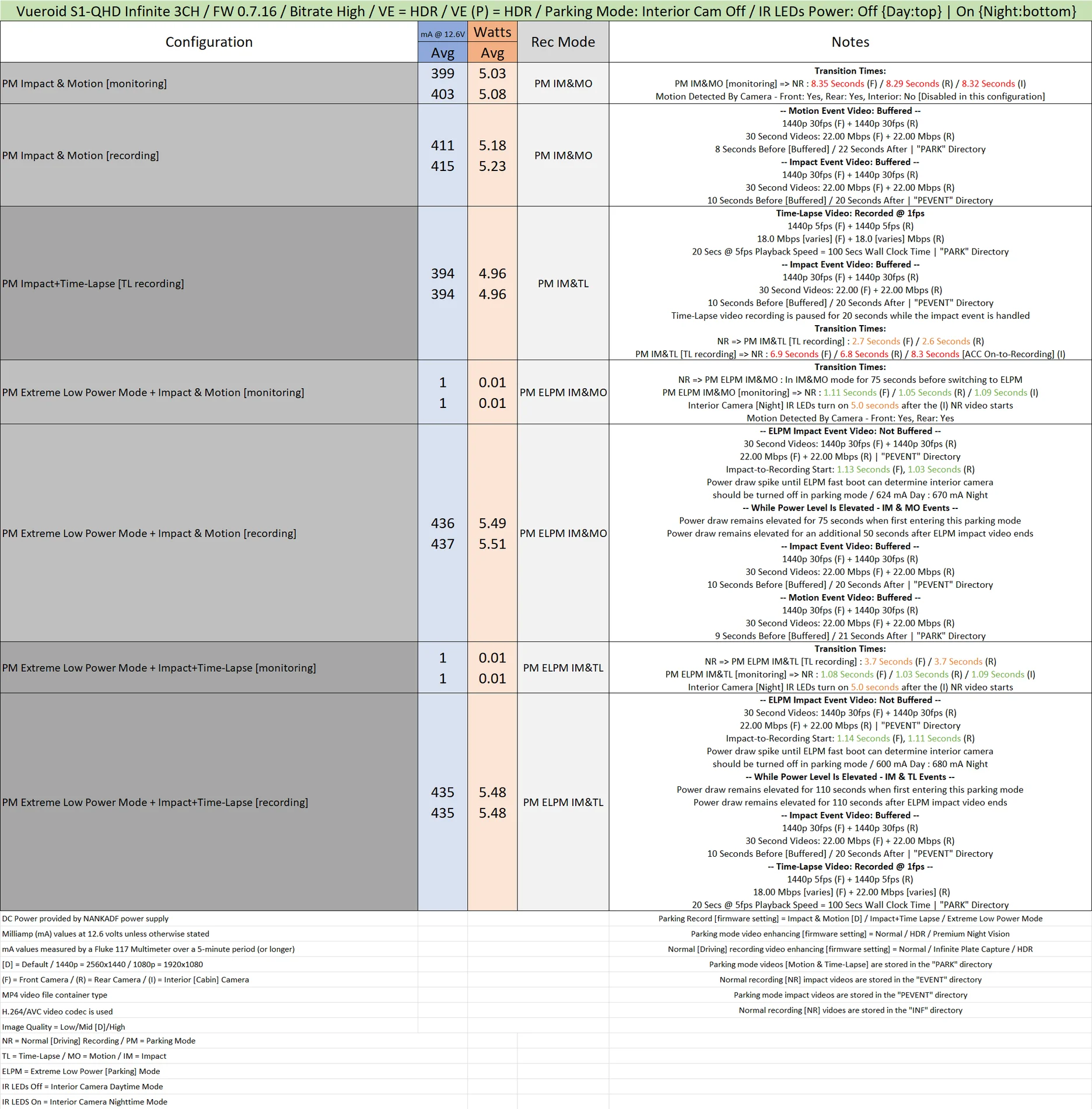

I performed several parking mode tests and power consumption tests for the S1-QHD Infinite dash camera. Here are my findings.

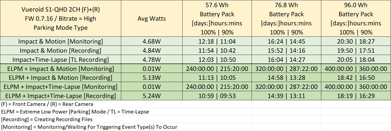

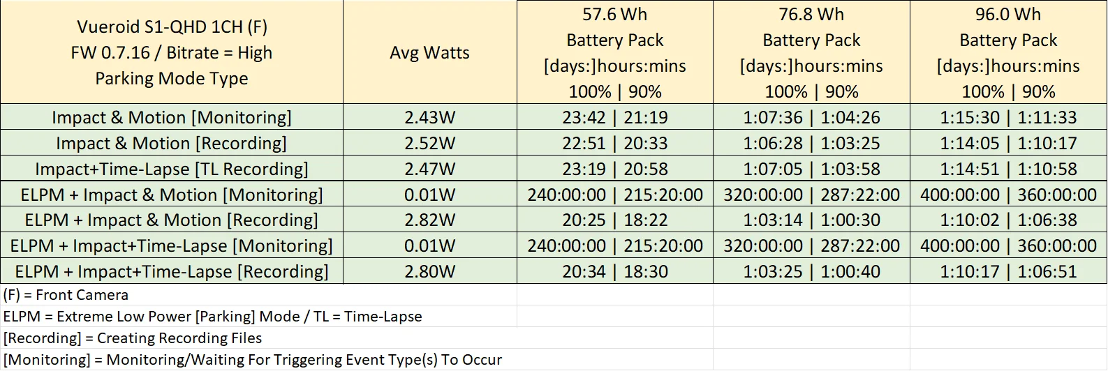

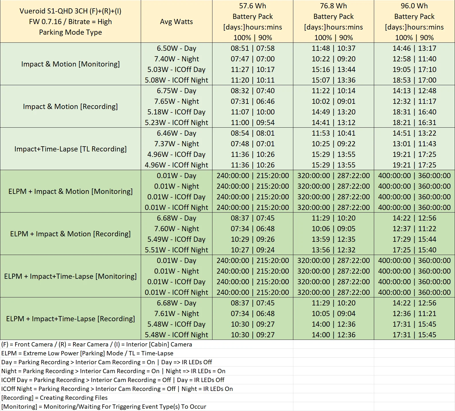

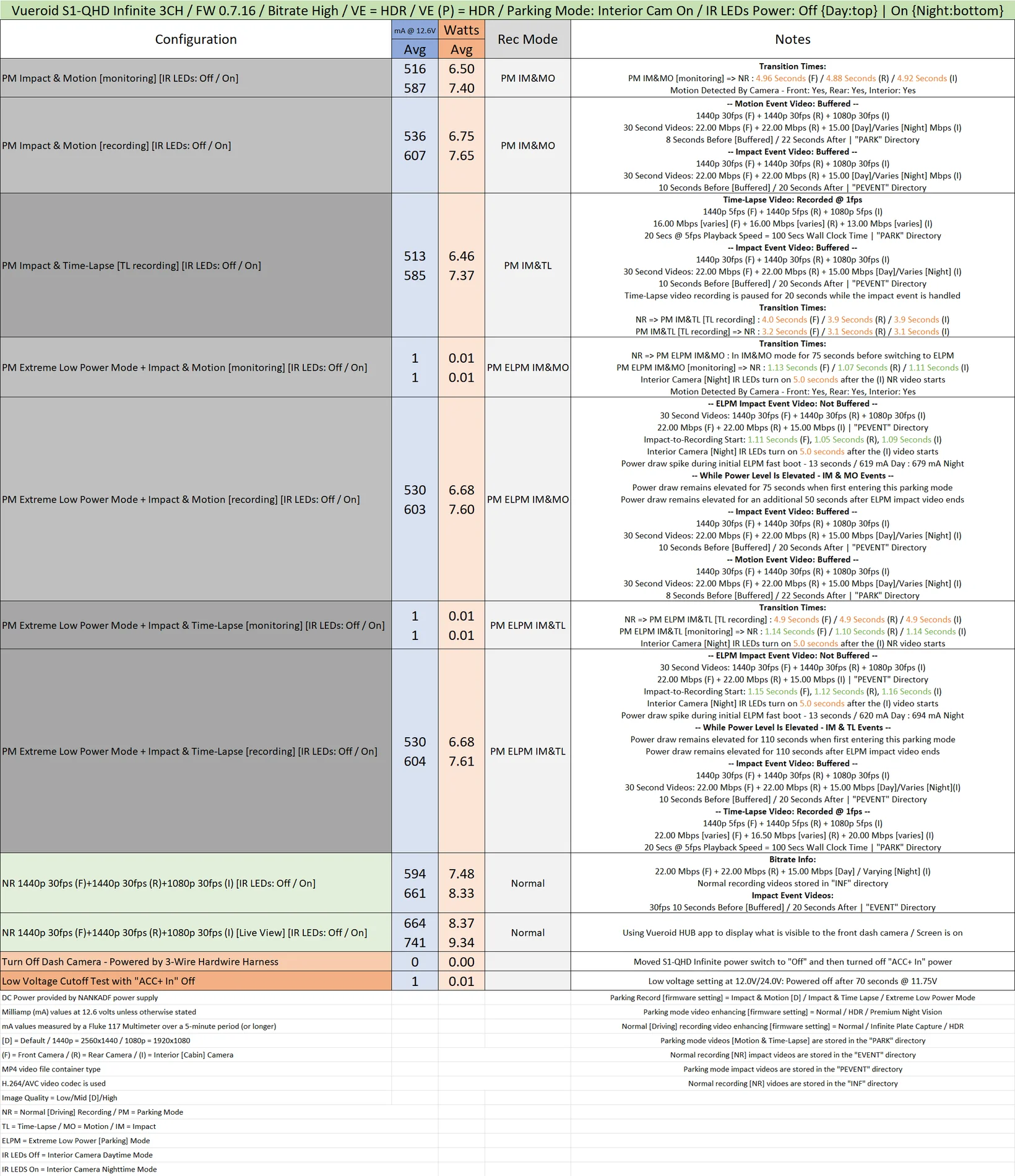

Power Consumption In Parking Mode & Time Estimates
The S1-QHD has a low voltage cut-off feature along with a time-based cut-off feature for parking mode. The lowest low voltage cut-off value available is 11.0V to be used when the S1-QHD is powered by a dash camera battery pack. Based on several tests of dash camera battery packs, they usually will provide power to the dash camera into the mid to low 10V range. This means the dash camera battery pack's internal storage charge will not be fully depleted by the S1-QHD, thus not truly consuming 100% of the battery pack's full storage capacity.
I have included a 100% time estimate column and a 90% time estimate column in my parking mode time estimates. The 90% time estimate is far more likely to be "closer" to what you may see in real world usage. There are other factors that can impact the dash camera battery pack's storage capacity as well [temperature, internal power use {Bluetooth for app monitoring}].
With regard to the ELPM time estimates, it is hard to be confident in such long time estimates for that parking mode. ELPM draws only 1 mA @ 12.6V [0.01W] which makes the calculation for the total runtime to be quite long. As I mentioned above, the battery pack itself will not always provide full storage capacity for long time periods. If the battery pack has very little internal power drain/draw, it should last a long time, but not the 360 to 400 days as the math calculations project. There's just no realistic way to give a fully accurate time estimate when the power draw amount is so low and the power source's [battery pack] storage capacity may change due to issues not related to the dash camera power draw.
ELPM allows this dash camera to be used with vehicles without a dash camera battery pack. Just make sure the low voltage cut-off feature is set to a realistic voltage value that will not leave your vehicle inoperable.
The "Waiting" values are the absolute "best case" situation for that parking mode. The dash camera is waiting for the "triggering" event(s) for that parking mode. The "Recording" values are when the dash camera is busy handling a triggering event for that parking mode type. The "Recording" state should not be the most active state for that parking mode, but it could be a highly used state for that parking mode [especially for motion detection]. If the "Impact" triggering event is the most active state for a parking mode, that vehicle might need to be moved to save it from destruction of that many impacts 🙂or the sensitivity setting needs to be adjusted or they're false positives.
S1-QHD 1-Channel [Front] Parking Mode Time Estimates
S1-QHD 2-Channel [Front+Rear] Parking Mode Time Estimates
S1-QHD 3-Channel [Front+Rear+Interior] Parking Mode Time Estimates
With the addition of the interior camera to the mix, this creates several different parking mode power modes and thus time estimates. In the "Avg Watts" column, there are four different power consumption values.
  • Day
    • Parking Mode - Interior Camera = On / IR LEDs = Off
  • Night [as it would be in dark locations or at night]
    • Parking Mode - Interior Camera = On / IR LEDs = On
  • ICOff Day
    • Parking Mode - Interior Camera = Off
  • ICOff Night [as it would be in dark locations or at night]
The "ICOff Day" and "ICOff Night" were made part of my test suite to confirm whether turning off the interior camera in parking mode would truly save power. Having the interior camera plugged into the S1-QHD front unit will result in a small amount of power being consumed even with the interior camera being disabled in parking mode. That's why the "ICOff" values in the 3-channel chart are not as low as the 2-channel power consumption values when the interior camera is not plugged into the S1-QHD front unit.
When operating in ELPM, the priority for ELPM is to start recording within 1-second of the impact event. To achieve the quick booting and recording start, the quick booting [RTOS] operating system does not turn off the interior camera when it first boots the S1-QHD to start recording. The ELPM "ICOff Day" and ELPM "ICOff Night" environments will result in consumption of slightly more power during the first 20-seconds after the impact event. At the 20-second mark, the S1-QHD is booted enough to reconfigure the interior camera and turn it off if so configured in the parking mode settings.

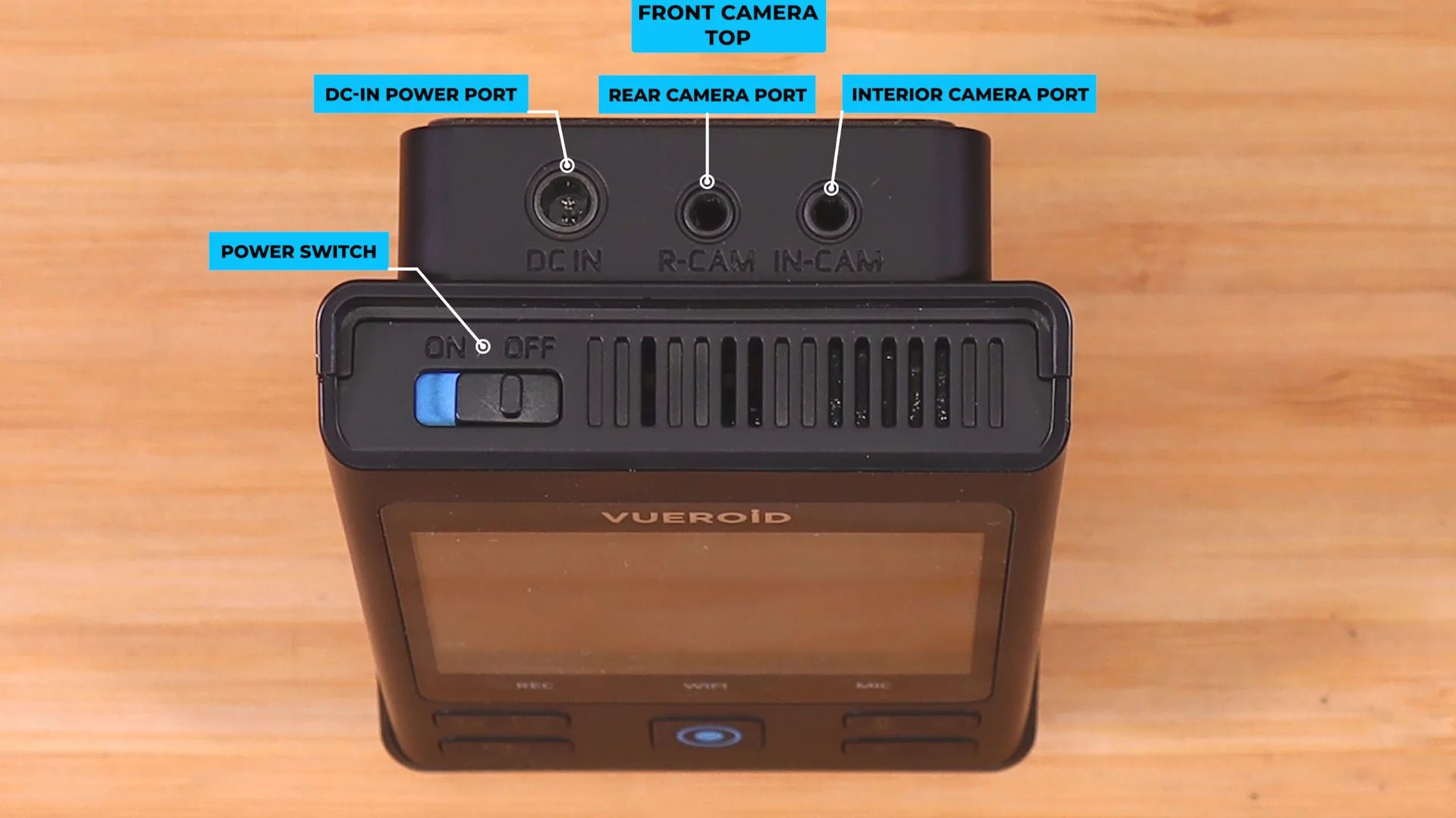

S1-QHD Power Cable / Source Options
What cables / power adapters are in the box:
DC-IN Power Port
3-Wire Hardwire Cable - Connects to S1-QHD's DC-IN port
This power option provides full functionality for the S1-QHD [driving recording, parking recording including low voltage cutoff monitoring].
The 3-Wire hardwire cable can be connected to the vehicle's fuse box or a dash camera battery pack. Make sure to set the S1-QHD's low voltage cut-off setting [Parking Recording > Vehicle Battery Protection > Discharge Cut-off Voltage] to a value that is appropriate for your vehicle or battery pack. There is an 11V setting available which can be used when the S1-QHD is powered by a dash camera battery pack to get the most out of the dash camera battery pack's stored charge.
Cigarette Lighter Adapter [CLA] - Connects to S1-QHD's DC-IN port
This power option provides limited functionality for the S1-QHD [driving recording only].
The CLA should be connected to a cigarette lighter [power] port in the vehicle that has the power turn off when the vehicle's ignition system is turned off. This is to prevent the S1-QHD from operating continuously in driving recording mode and potentially draining the vehicle's battery.
USB-C Power - Connects to the USB-C port on the right side of the S1-QHD
No USB power adapter is provided with the S1-QHD, so the user is responsible for providing a USB power source and cable that will connect with the USB-C port on the right side of the S1-QHD front camera. When in the user's vehicle and depending on the S1-QHD configuration, the maximum power draw can reach up to 12W [3ch, front+rear+interior cameras, IR LEDs on, screen on, LEDs on, speaker active, etc]. The user must provide a USB power adapter or have a USB power port in the vehicle capable of providing 5V @ 2.5A [minimum]. When used in a vehicle, the user is responsible for providing a USB power cable to provide power from the USB power adapter to the USB-C port on the S1-QHD.
Since the S1-QHD does not support parking mode operations when powered by the USB-C port, the USB power supply must turn off power to the S1-QHD when the vehicle's ignition system is turned off. This is to prevent the S1-QHD from operating continuously in driving recording mode and potentially draining the vehicle's battery.
A USB-C data / power cable is provided in the box with the S1-QHD with a length of 1M [3.28 FT]. This cable's primary use is for connecting the S1-QHD to another USB-C capable device [cell phone, computer, or power source]. USB power sources in the vehicle [native to the vehicle or third-party power adapters] must be used with cabling that will support the 5V @ 2.5A power rating.
Optional Power Adapter(s):
VUEROiD OBD-II Power Adapter
This optional accessory can make it easier to install the dash camera in your vehicle since there is no need to deal with the vehicle’s fuse box for the 3-wire hardwire cable installation.
Your vehicle’s OBD-II data link connector port has a dedicated power pin [16] and dedicated ground pin(s) [4 and 5]. The OBD-II data link connector’s specification does not require a vehicle manufacturer to include a pin that has vehicle accessory power [switches on/off based on the vehicle’s running state].
Because there is no pin within the OBD-II data link connector port that is guaranteed to have switched accessory power, all OBD-II power adapters monitor various factors to determine when to turn the dash camera accessory power on [exit parking mode or turn on] and off [enter parking mode or turn off]. This unit monitors several pins within the vehicle’s OBD-II data link connector port to make an educated guess when to toggle the dash camera accessory power on/off. You should test this method of powering the S1-QHD to make sure it’s fully compatible with your vehicle and your driving habits.
Even though it is more difficult to install the 3-wire hardwire cable to power your dash camera, it can be the better solution if your vehicle is not fully compatible with the OBD-II power adapter’s logic for turning the dash camera’s accessory power on/off.
The following information was gathered during my power consumption tests. These tests focus on the four parking mode combinations available with the S1-QHD [see above]. For the tests that involve the use of the interior camera [3CH with interior camera plugged into the front camera] it has two power consumption values. One is for daytime which means the IR LEDs will be off and the other is for nighttime when the IR LEDs will be used.
3-Channel / Parking Mode: Interior Camera = On
[click on thumbnail image to see full size image]
3-Channel / Parking Mode: Interior Camera = Off
Since you can configure whether to use the interior camera while in parking mode, this set of tests were performed with the interior camera turned off in parking mode.
2-Channel : Front + Rear Cameras
1-Channel : Front Camera

4.) Is the REAR camera identical to S1-4K?
Yes

7.) What is Maximum Bitrate, (1CH, 2CH, 3CH)?
My power consumption tests have the bitrate setting set to the "High" setting which is the highest available level. The video bitrate values are listed in my power consumption spreadsheet "Notes" section.
The bitrates in my spreadsheet are with pre-release firmware 0.7.16. I just reviewed video files created with production firmware v1.0.2 and the bitrates look to be the same as with firmware 0.7.16.
S1-QHD 3CH: 22.00 Mbps (F) + 22.00 Mbps (R) + 15.00 Mbps (I)

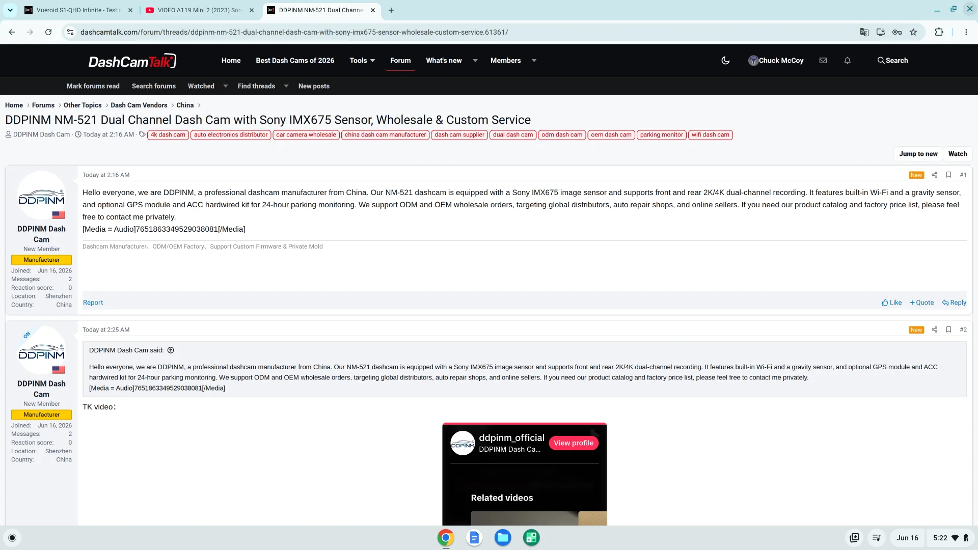

@qusejr2 are the durashift trigger values the same for the S1-QHD and the S1-4K?
I wonder why you ask it ? novatek NT98529
Basic specification.
When car shopping, do you not ask what kind of engine?
In past years Thinkware & BlackVue did not have HDR because they did not use Novatek.
You should be proud to show your high quality component specifications to show customers the difference between all the counterfeit / junk on the market.
All counterfeit / junk dashcam brands "never" disclose component specifications because they know they are old & low quality.
Here is a perfect example.
It says 4K with IMX675

Here are some daytime S1-QHD front camera frame grabs along with plate captures with firmware v1.0.2 installed. The image on the top 1/2 is from the S1-QHD with its "Video Enhancing" mode set to "Normal". The image on the bottom 1/2 is from the S1-QHD with its "Video Enhancing" setting set to "Infinite Plate Capture" [IPC]. The horizon alignment is set to about 60% sky / 40% ground using the VUEROiD HUB app alignment bar/band.
The "Normal" video enhancing mode tends to capture plates a bit better than the IPC video enhancing mode during the day. This suggests that using the "IPC/HDR Timer" feature would be helpful to enable IPC or HDR only during nighttime hours.
I have nighttime S1-QHD footage, but it was created with a pre-production firmware installed. I will be gathering some nighttime footage over the next week with firmware v1.0.3 installed.
01_20260522_102_normal_vs_ipc.webp02_20260522_102_normal_vs_ipc.webp03_20260522_102_normal_vs_ipc.webp04_20260522_102_normal_vs_ipc.webp05_20260522_102_normal_vs_ipc.webp
06_20260522_102_normal_vs_ipc.webp07_20260522_102_normal_vs_ipc.webp08_20260522_102_normal_vs_ipc.webp09_20260522_102_normal_vs_ipc.webp10_20260522_102_normal_vs_ipc.webp
