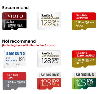

just a little confused with card size but i guess all depends on the size of recording what ive set it too? do i stick with a class 10 card or anything else brand wise?
