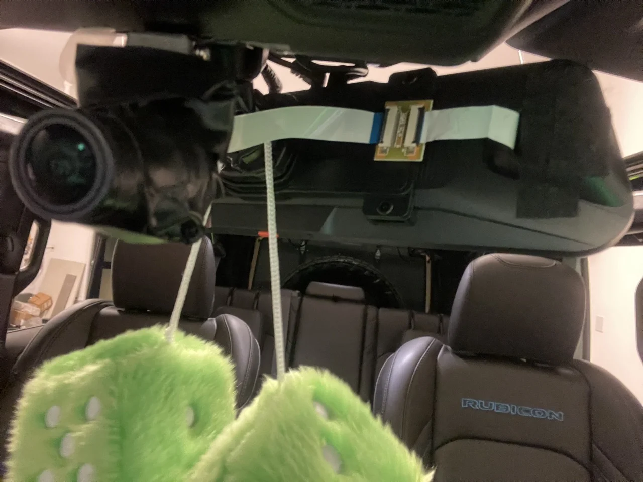

The Wrangler's ACC box in the top-center of the windshield obstructs a solid 30% of the view when using a RVM mounted forward-facing dashcam, like the Wolfbox G900. In order to get around this, I:
- Purchased a $7 26-pin FFC male-to-male connector from Amazon (Amazon.com)
- Purchased a bag of 6" 26-pin Type A connectors from Amazon (Amazon.com)
- Used a pry tool to open the RVM unit
- Disconnected the 26-pin Type A FFC cable connecting to the lens
- Unscrewed the lens mount from the assembly
- Pushed the cable through the lens mount hole
- Reassembled the unit - wired up the connector to the old dangly cable and my new cable, covering the giant lensmount hole with some electrical tape and securing the cable to the unit a bit
- Jerry-rigged a hinge with electrical tape to hold the now-extended lens housing and keep it adjustable
- Used a command strip to hold the hinge in place mounted directly to the bottom of the ACC
- Got super-annoyed when Wolfbox immediately announced the new G900Pro so I'll have to do it all again (and see if the cables are the same)
