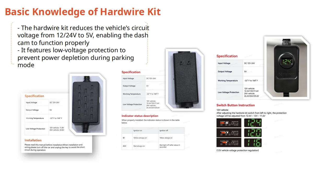

A hardwire kit is a power cable designed to connect your dash cam directly to your vehicle’s fuse box. It allows the dash cam to draw power even when the engine is off, enabling features like parking mode. This ensures your car is always protected, even when you’re not driving.

  3. Battery Safety: Hardwire kits with low-voltage protection prevent your car battery from draining.

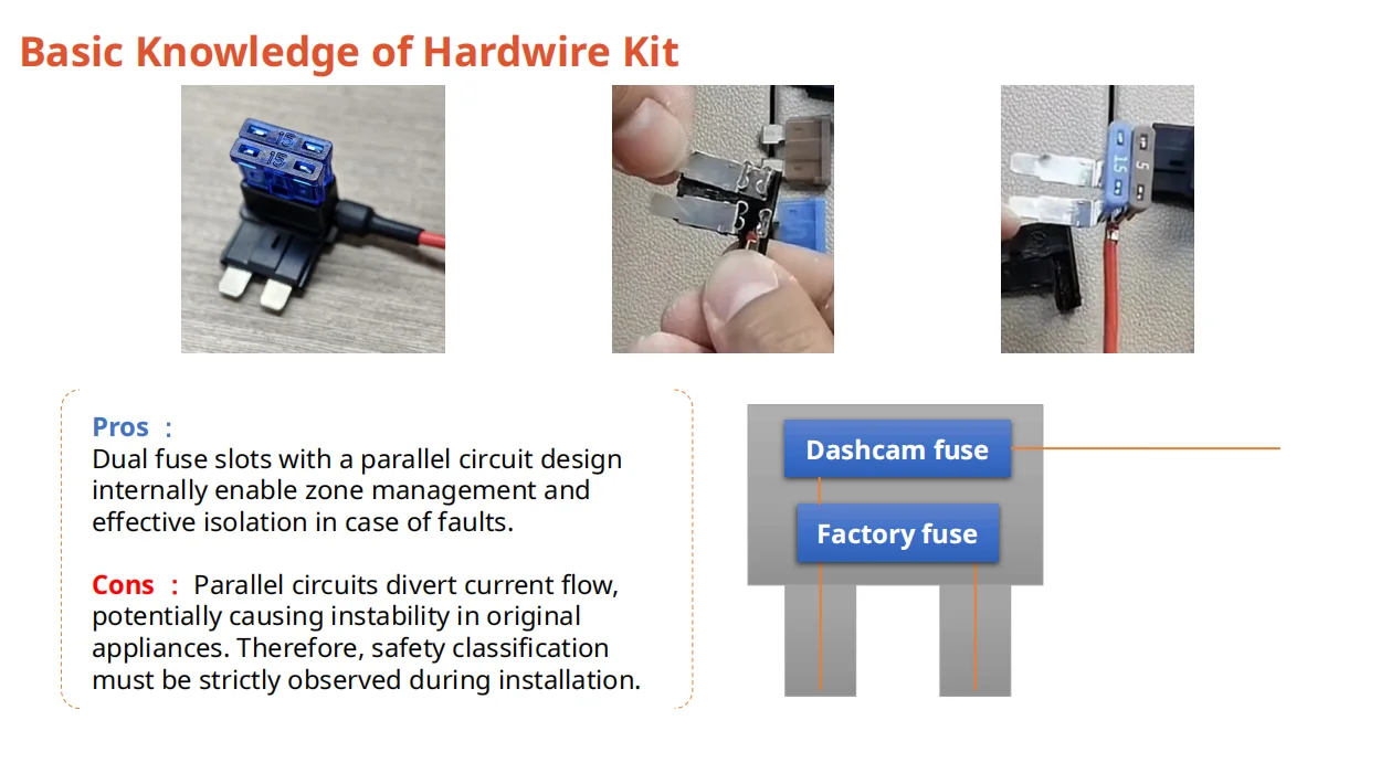

  2. Choose the Right Fuse Slot: Select a fuse slot that provides power only when the car is on (ACC) and another that’s always powered (BAT).

  4. Add Low-Voltage Protection: Ensure the hardwire kit has built-in low-voltage protection to safeguard your car battery.
