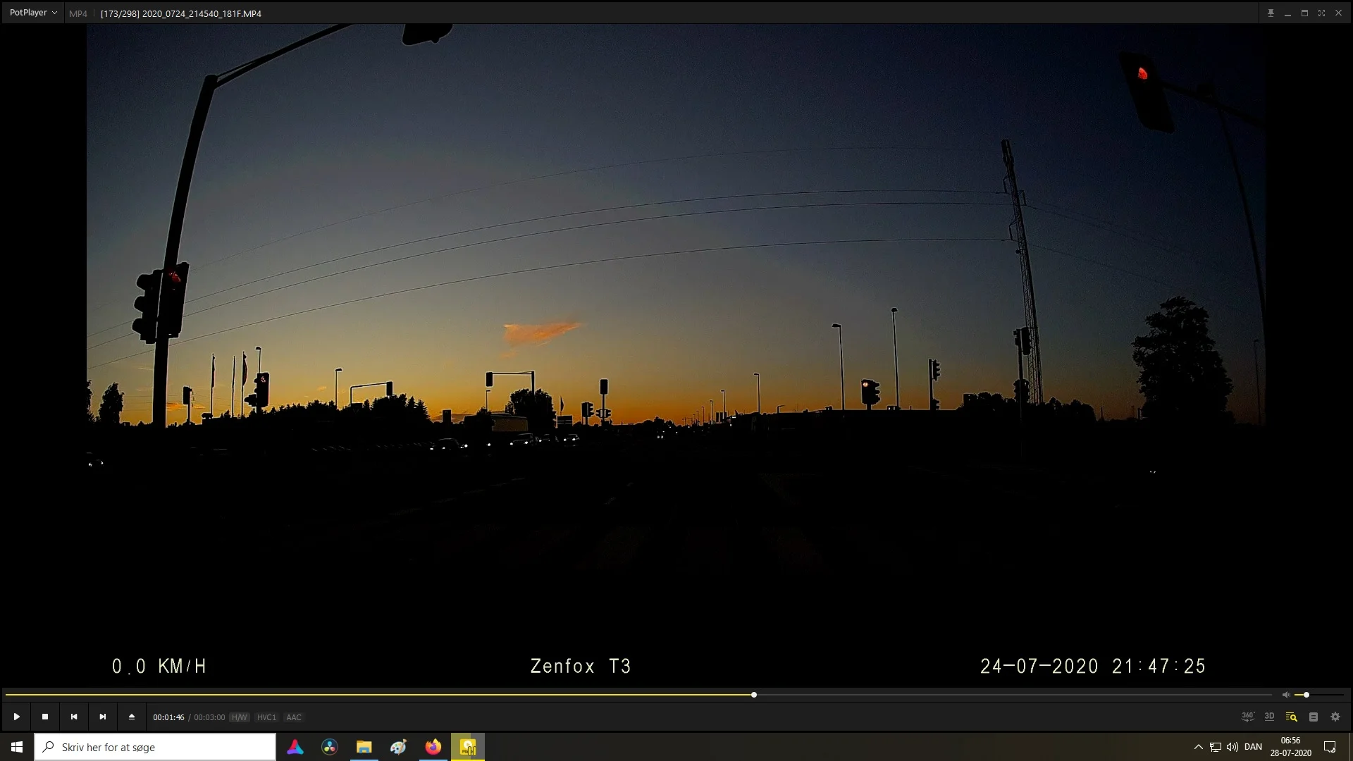

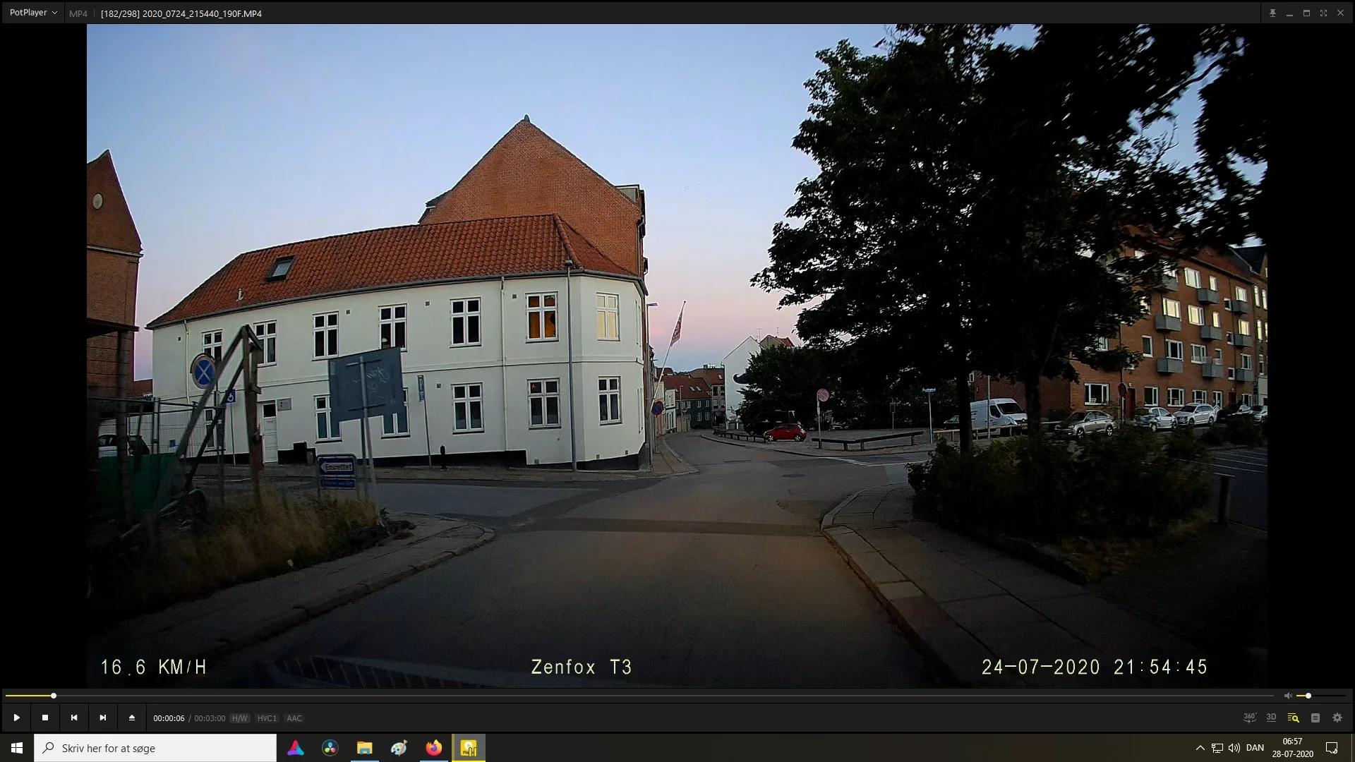

Actually looking over my T3 footage yesterday i saw darkness filmed granted around sunset, but the problem was my front lens was aimed a bit too high.
Note time/date stamp

@kamkar1
The lens is probably pointed too high, but yes, the T3 produces a very dark low light image. Probably some filters involved in smoothing out the noise (my guess). However, I would try adjusting the lens some, as that is very dark with the sky being that light.
None the less, night time is a myth according to @Nigel

Yeah just freaked me that footage would be that dark there, when minutes later in downtown it do a much more realistic footage.

well all the glass in a rifle scope tend to block out a lot of light, so used that to say there was still plenty light at the time of the video.
Yeah will of course adjust the lens, i think i might have touched in the last time i cleaaned the inside of my windscreen ( taking the T3 off its mount to do that )
