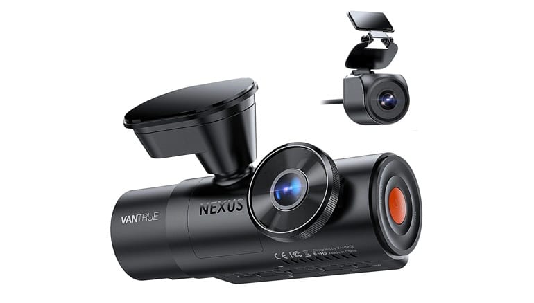

The Vantrue N4 Pro S, also called the Nexus 4 Pro S, is a Chinese built, 3-channel rideshare camera launched in July 2025. Vantrue has been a pioneer with 3-channel dash cams releasing the original N4 in 2020 and N4 Pro in 2023. The current N4 Pro S improves on this line of cameras.
The Vantrue N4 Pro S is based on the Novatek NT98529 processor. It uses a Sony STARVIS 2 IMX678 CMOS sensor for the front camera, Sony STARVIS 2 IMX675 CMOS sensor for the rear camera and Sony STARVIS 2 IMX662 CMOS sensor for the cabin camera. The introduction of the STARVIS 2 sensor across all three cameras is a significant improvement from a hardware perspective.

The Vantrue N4 Pro S comes with both an adhesive mount and a suction cup mount. For most installations the adhesive mount is preferred as the installation is more compact. The camera connects to the mount using a magnet which allows for easy removal.
The N4 Pro S has a 3.19″ screen, g-sensor, GPS, 5 GHz WiFi and free apps for Android and iOS. A new feature for 2025 is cloud support. If you purchase the optional Vantrue LTE module, you can connect to your dash cam remotely.
One area which can be seen as a negative for the N4 Pro S is its size. This dash cam is even larger than the N4 Pro at 123 x 58 x 44mm. However this does include the front facing camera, cabin camera and a 3.19″ screen.
The N4 Pro S build quality is very good and the camera comes with screen error notifications. The dash cam also comes with voice control supporting numerous voice commands such as “Take Photo”, “Turn on Wifi” and “Lock the video”.
Vantrue has also introduced PlatePix technology to improve license plate readability. In some scenarios this provides a little bit of improvement but if license plate readability is a key feature you are looking for, consider a camera with a telephoto lens.
