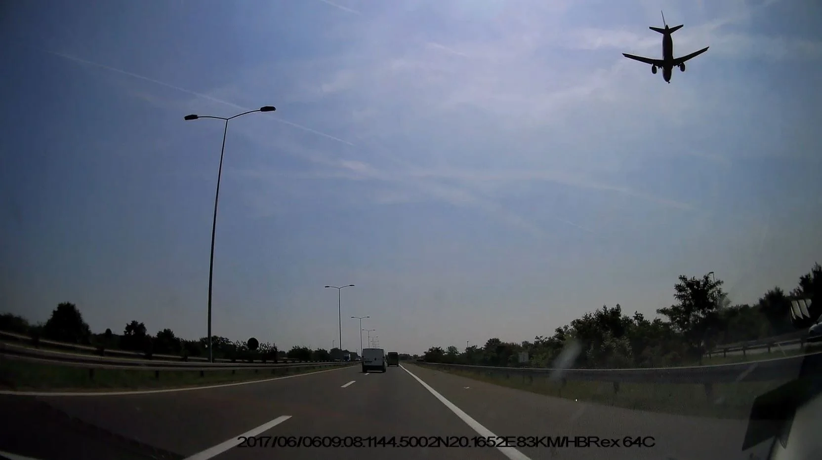

In footage text are now black making it hard to impossible to read even in daytime as i have a black dashmat on my dashbord.

Yes indeed, these black fonts without any space between the different data is very annoying.

Speed is there ( 83 km/h in the photo ) but its almost a guessing game due to the black font and no spacing in between things.
But this i think are a easy fix ( font color and spacing between information )
Not on the recorded one (as on the attached picture).I meant on DashCams display, when its recording
Aaaa okay, well that i will not be able to say, first of all due to my old eyes, and i had to move the camera over on the passenger side of the mirror.
