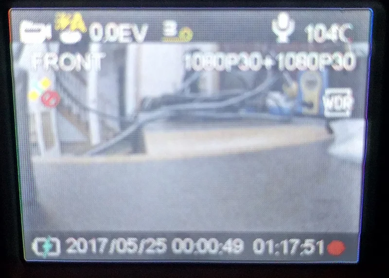

EDIT: After exceeding 104°C OSD it shuts off
Mine is off by ~8°C inside my room (temperature: 21°, osd says 29°C)

Camera still gets very hot (or it's not reporting correct value) Had it running in my office for about 2 hours (both channels) and it was hovering at around 90C.
The OSD display is a mess ("needs optimizing" is putting it very mildly) 🙂
the new firmware must work with the mod resistor to get correct temperature value.
for the rear image, please set the REAR CAM FLIP in menu
So is the resistor (thermistor) used to measure the temperature?
Most likely it is used as a bias resistor for thermistor which actually measures temperature. (two different components)
correct
