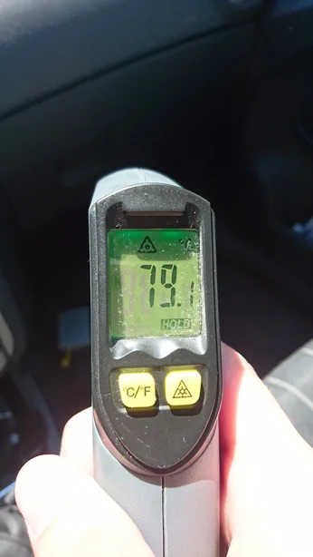

That screen is a bit warm!After 40 minutes of recording in direct sunlight I get this result (original latest firmware):
Measured the temperature of the screen:

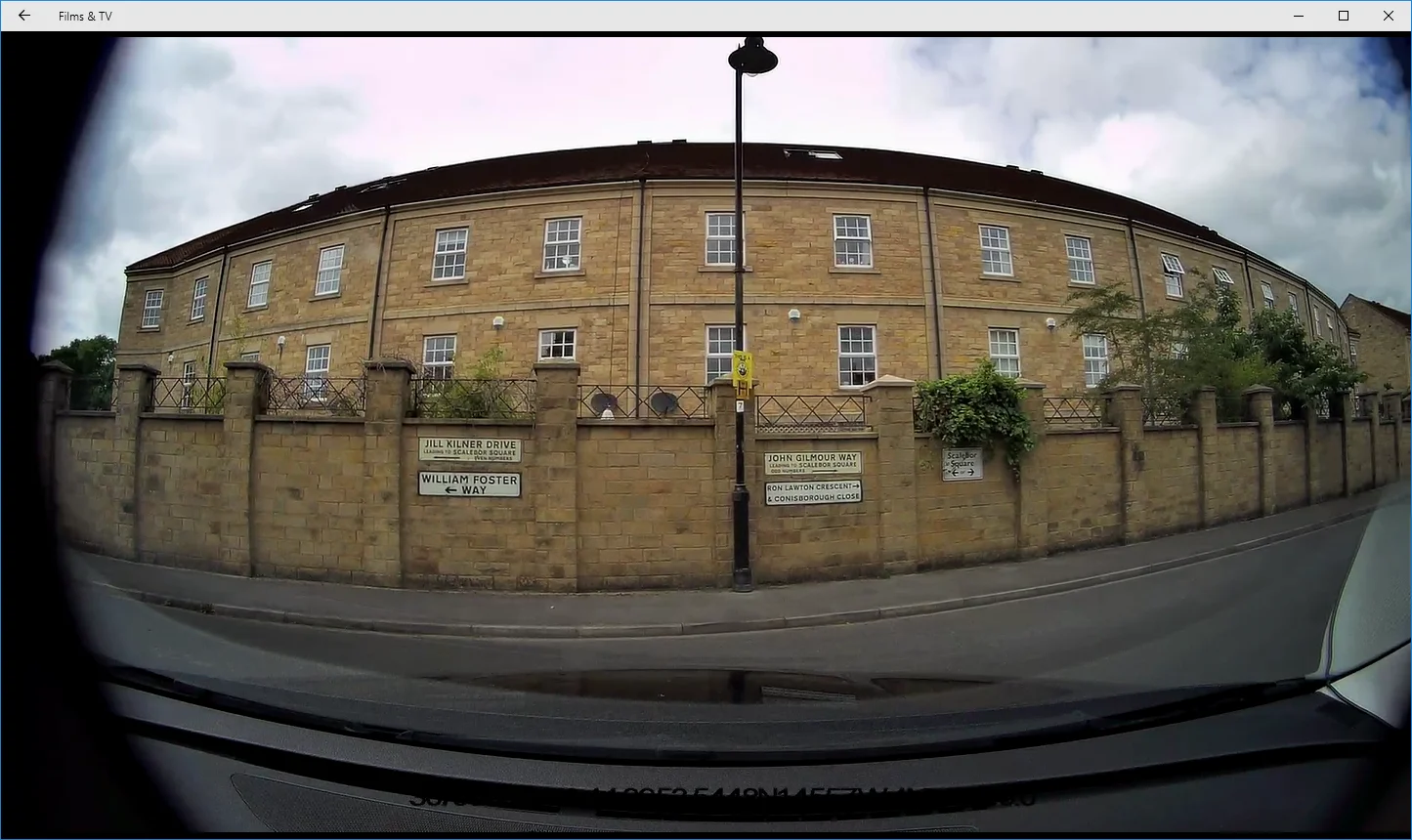

The rear image no longer flips on power button press but It seems the default is now upside down. I am assuming the up is the side closer to the cable. Any reasoning why it's "down" now?added on 5.27:
3, mirror the rear image basing on 5.24 update
9, reduce G-sensor sensitivity,
13, memory error for large card, added a format button, it is the first crude attempt
18,19, added temperature stamping and setting, but need further optimizing
http://www.mini0906.com/firmware/FIRMWARE_20170527.zip
So is the resistor (thermistor) used to measure the temperature?the new firmware must work with the mod resistor to get correct temperature value.
for the rear image, please set the REAR CAM FLIP in menu
