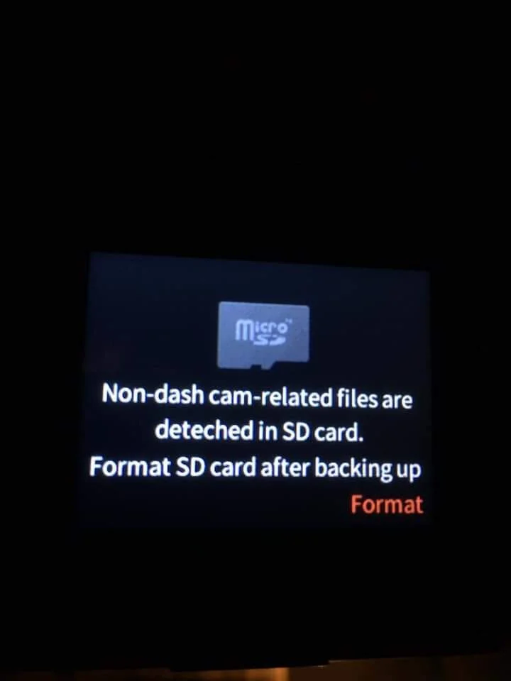

After updating to 1.05 I'm constantly getting the error message that I need to format my SD card.
I format it and after a few minutes the same thing.
I'm using SANDISK ULTRA® microSD UHS-I CARD C10, U1 64GB card. Checked the card on my PC, no errors.
After a few hours of messing about, I've finally decided to downgrade to 1.04 and everything is working fine, as it used to.
Anyone else having this kind of issues?

Formatted it with windows, Rufus, multiple times.
Nothing helped but rollback to 1.04.
Since then 0 issues.

i had some issues with my sd card after firmware update. and also when i downgrade the firmware, camera works fine. but some recorded videos have lags, gaps and sometimes jumps about 10-15 seconds.
my friend has the same dashcam (we have bought together) and he doesnt have any problem.when we change sd cards to each other's cam, my camera works pretty fine, and he has sd card issues and needs to format it again and again.
i was using class 10 sdcard 64 gb (as suggested in the manual) but had issues. as i see my friend has no issue (he uses U1 sdcard), i bought another sd card U3 we both have no problem.
i think that the main problem here is not the firmware but sd card in fact. try changing your card with a faster one and test the new firmware again.
the manual should be updated i think. class10 is not fast enough for this dashcam ;)

While on 1.05na, I purchased a new 64GB Samsung EVO Plus card (UHS-I card). When I inserted the new card, it asked for it to be formatted but the formatting failed.
The new card was formatted as FAT32.
I removed the card and from a laptop, I created the following folders on the empty card:
Event
Normal
Parking
I re-inserted the card on the 70mai pro, and it again asked for the card to be formatted, but this time, the format did work and I was able to successfully use the new card.
Just wanted to share this approach, which worked for me.
Cheers.
I had to rever to 1.04 to work.
After 1.06 it works fine again.
