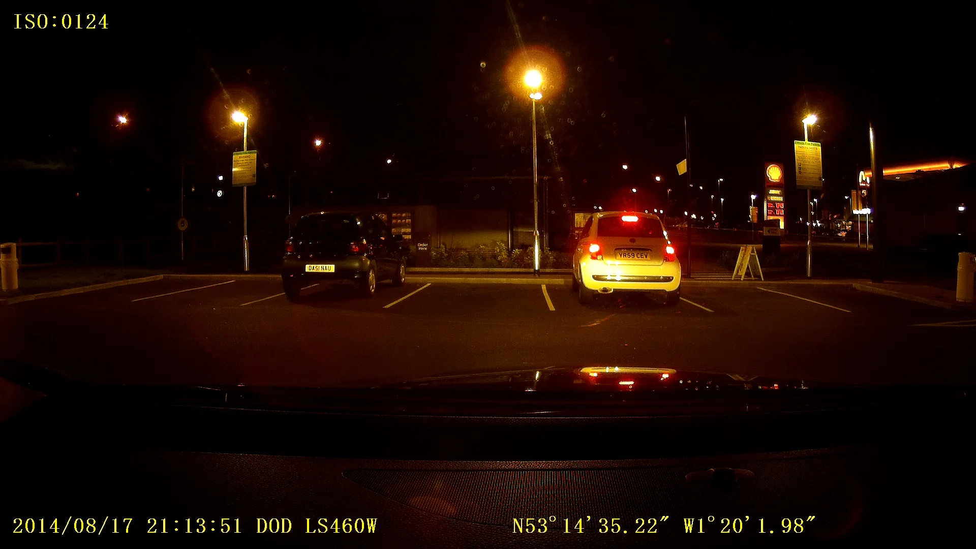

Yours does show the same blurring of plates when they're up close - I'm actually trying with a lower EV setting at the moment to see what that does - but really need to do a side by side to see if it affects the LS460W and the LS430W the same.
Well I've tried it with EV at -3 and -2 and at -3 it can actually start to read numberplates with my HID headlights which makes a change, but it's dark video - swings and roundabouts really.

You can see numberplates are more legible with xenon headlights with EV set to -3, but at a cost of a dark video.
I've just done an A/B comparison with the G90 and this is finally now better at plate reading and across the board, albeit with a darker image - it looks like I'm finally seeing the extra dynamic range of the Sony sensor come in to play.

I've also attached two photos below to show the difference between EV-3 and EV-2 - I should have done more to show all values in hindsight but I was in a hurry 🙂
In a nutshell I think the current firmware is trying too aggressively to get a bright image, at the expense of sharpness. Maybe instead of the F1.6 lens they should have taken a leaf from the Panorama book and gone for a 2.0 or 2.8?
