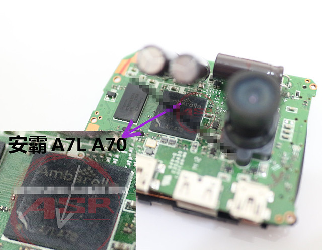

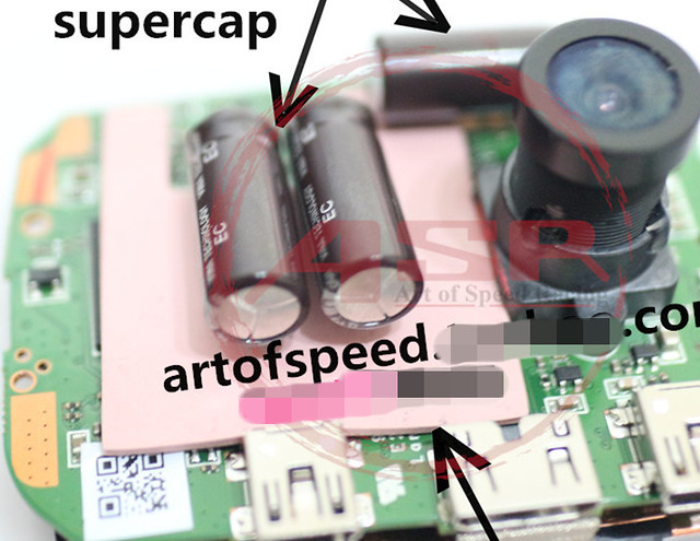

Just disassembled a Vico Marcus 3 and see the internal hardwares. I do not really understand why they put a piece of black paper cover the chipset. Could someone explain that?
-Pizdys-
Retailer
Jul 21, 2013
151
194
better than yours....
this black paper is actually double sided sticky tape which is use for transferring heat from CPU to this pink thermal tape.
...A7 CPU getting hot when operate so this is necessary and standard solution.
