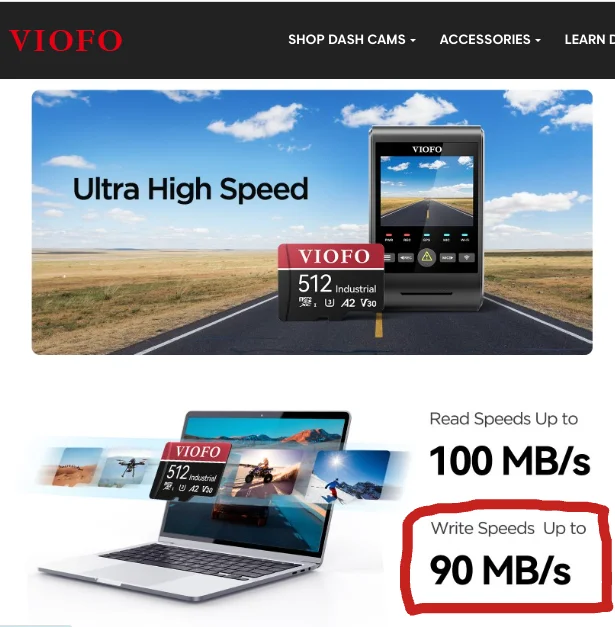

I purposely listed the 150 Mbps Total Bitrate of this “fantasy” dash cam to exceed the current capabilities of the Viofo brand SD Card, (90 Mbps write speed);
I was hoping this “memory issue” could be solved by something like the proposed SD Express cards capable of 600 Mbps write speed from up to 8 channels of data.
Along with the new / incoming 2TB Micro SD Cards.
But after reading your guys’ posts about all these exotic memory protocols it doesn’t sounds like that’s possible.
Is a 2TB (E600) SD Express micro sd card really not a viable solution?

The memory card supports 90 MBytes/second while you're asking if the dash camera exceeds 90 Mbits/second which is 11.25 MBytes/second. (?)

I’m confused.
I thought 90 MB/s is the same thing as 90 Mbps.
It that not the case?
If so, let’s say the A229 Pro in 1-CH configuration requires 60 Mbps of data writing speed, what is the total number of channels at that rate the current Viofo Brand SD Card can support simultaneously?

The lowercase "b" is bits and the uppercase "B" is bytes (8 bits per byte). The maximum write speed of the memory card is 90 MB/sec which is the same as (90 x 8 bits) 720 Mbps. If there were no memory card management overhead to account for, 720 Mbps divided by 60 Mbps per video camera would result in 12 cameras. There will be some amount of overhead to account for making that only a theoretical number of cameras it can support. The memory card sales info states "write speeds up to" which means under ideal conditions. It also depends on how fast writes can be passed from the dash camera, through the memory card reader/writer and then onto the memory card.
I don't know what the total overhead is related to each write taking place for multiple open files, file system management to allocate blocks to each file as they're extended, file system management to delete the oldest files to make room for the new files for loop recording, but my guess would be that it would be a non trivial amount of overhead.
And I was hoping for 10 bit video, recorded in HDR10 format, for this dream dash cam! 🤔
Wow, thank you so much for the explanation.
If I had known the theoretical limit was 720 Mbps I would have “dreamed” IMX678 sensors for all 5 cameras at 100 Mbps each for a total of 500 Mbps. lol
That is only a theoretical limit, not a practical limit. In reality you will never achieve the theoretical limit for various reasons.
Currently we don't have any dashcams that produce more than 90Mb/s(?), I assume due to memory card issues, so you are already well above what can be achieved currently.

90MB/s * 8 / 60Mb/s = 12 channels, but that is never going to actually work.
I suspect the real answer is 1, due to overheating if you had 2. Maybe with a box camera and some form of active cooling, and one of the higher capacity (faster) cards, you could have 2.
