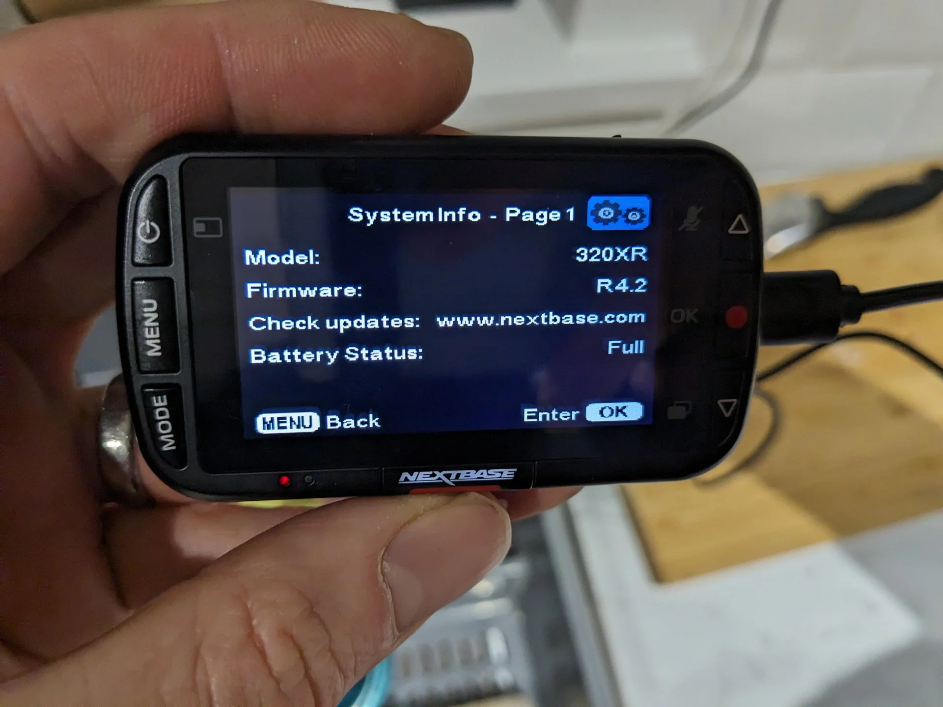

According to the camera status, the battery is fully charged.
So I have the following questions:
  • What does the camera battery actually do? The blue LED is illuminated if it is charging, so no LED and the camera saying it is full sounds correct. But if the camera is recording and the power supplied by the car is cut, shouldn't it carry on recording using the internal battery?
