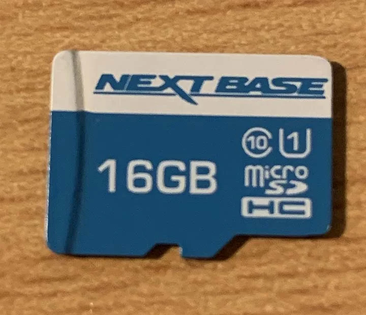

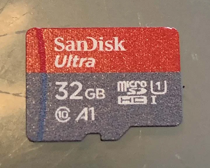

My Daughter has a 612GW which ran ok for the last 12 months with a sandisk 32GB U1 (10mb/sec write). When I turn on the dash cam, it prompts me to insert an sd card, even though the sandisk card is already inserted. I reset the dash cam to factory default, but the problem persists. I can see the contents of the sd card on a PC, but I cannot format it because it comes up as read only. I tried another micro sd (Nextbase 16gb U1) and again, the 612GW did not recognise it, and the card subsequently became read only when I mounted it on a PC. From reading threads on this forum, I know I have the wrong card for this dash cam model, and I will buy the correct card tomorrow (Nextbase 64gb U3), but I`m curious to know if anybody has seen this problem before.
