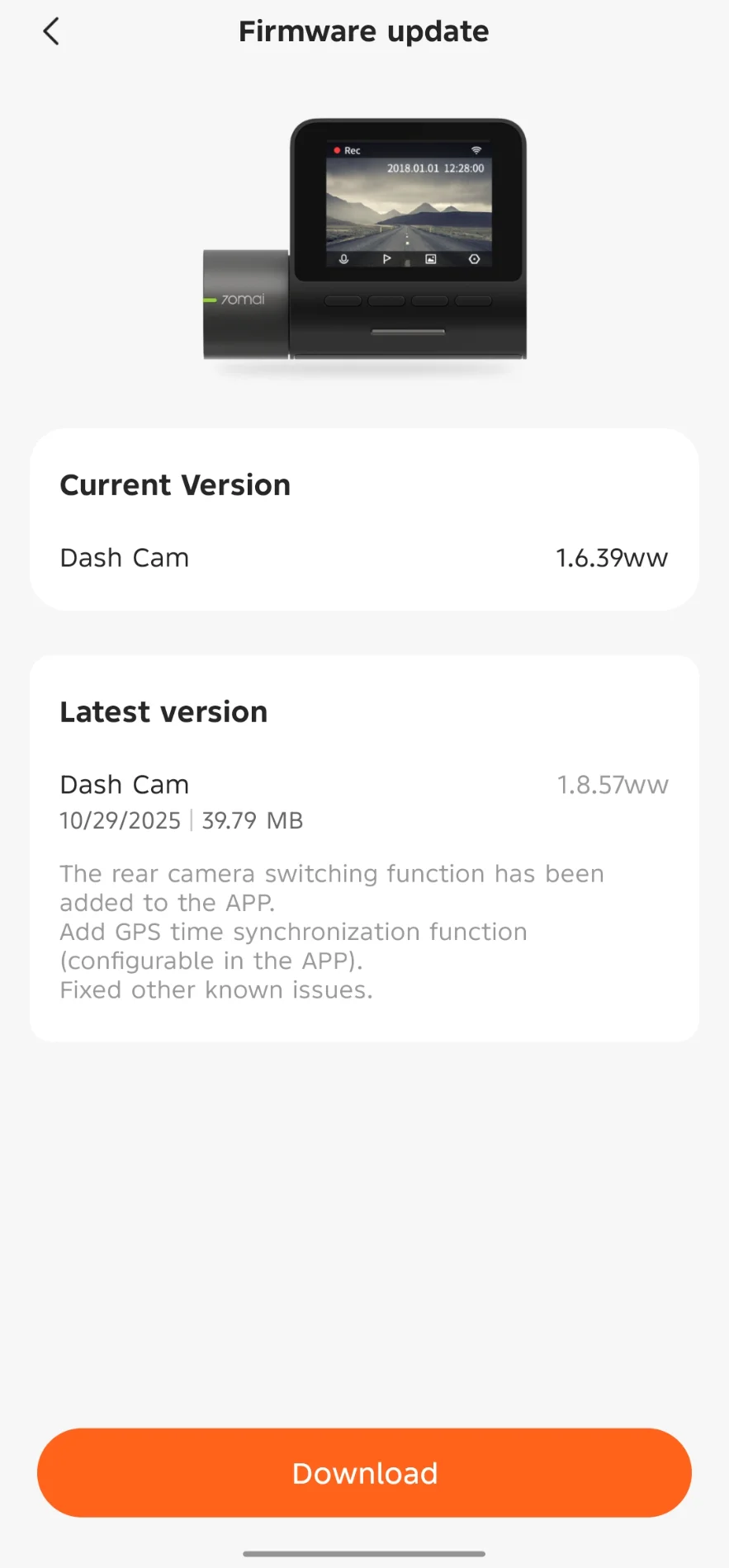

I'm using version a500s_1.6.39_ch due to a firmware mismatch error. Is there any problem with downloading the new update?
