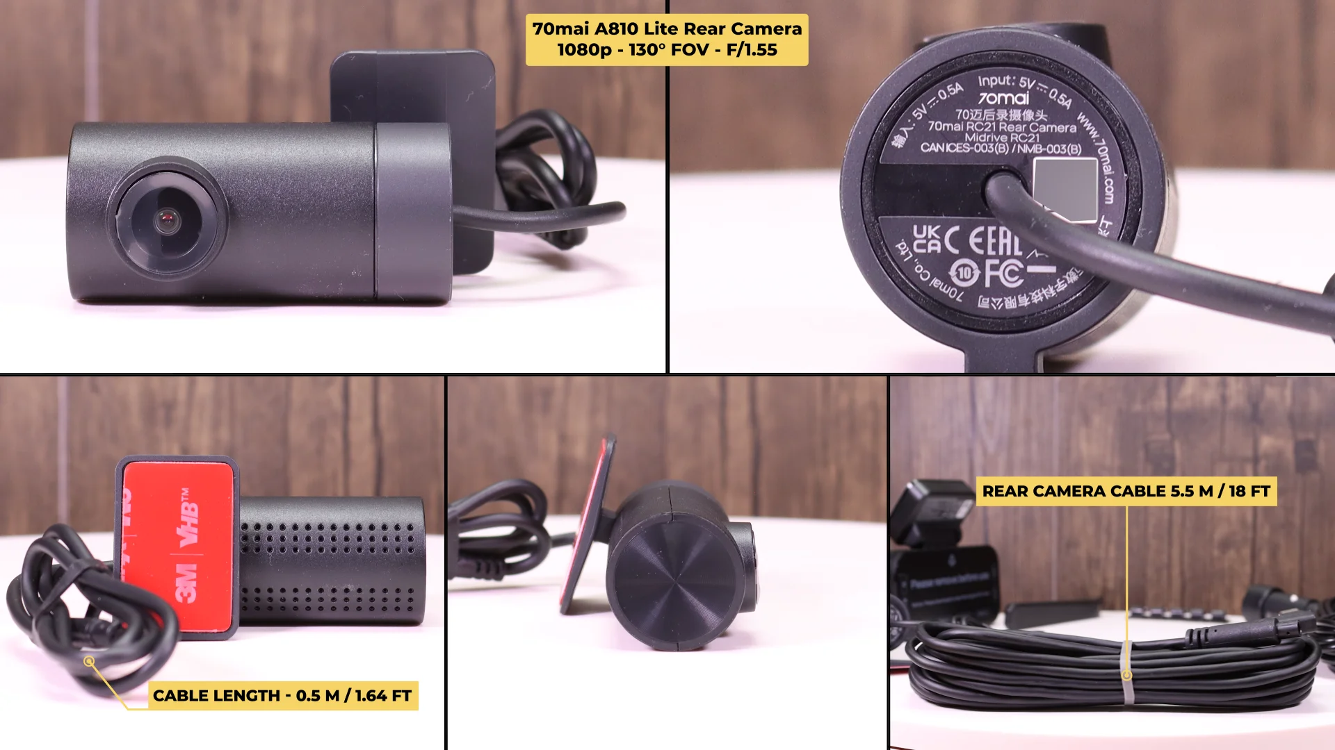

  • Rear 1080p Camera
    • RC21 rear camera creates videos with acceptable video quality for a 1080p camera.
    • The image is not super sharp, but it's better than some other 1080p rear cameras.

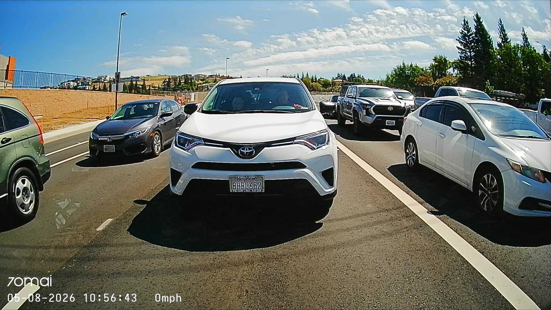

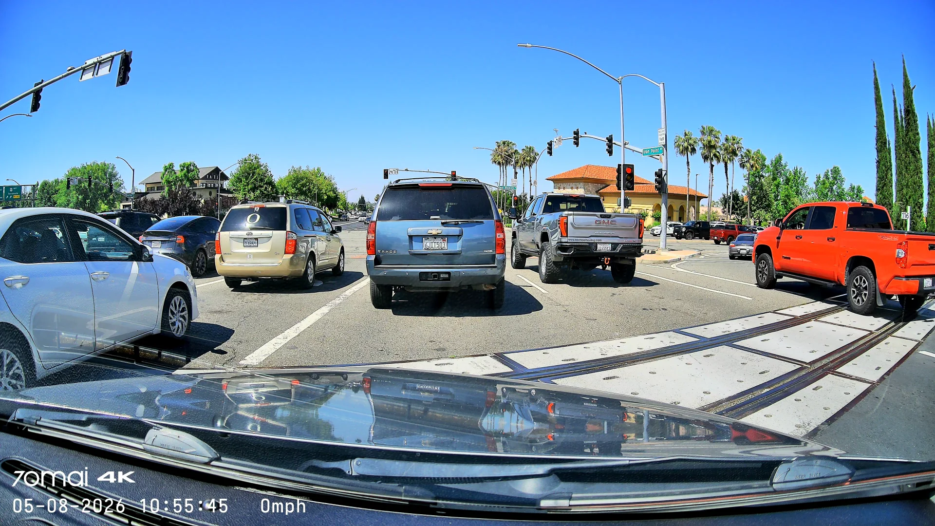

  • Daytime frame grabs
    • Here are two frame grabs from my drive today [click on thumbnail to see full size image]
    • a810lite_front_NO20260508-105543-000047F.MP4_snapshot_00.02.webp a810lite_rear_NO20260508-105543-000047R.MP4_snapshot_01.00.webp

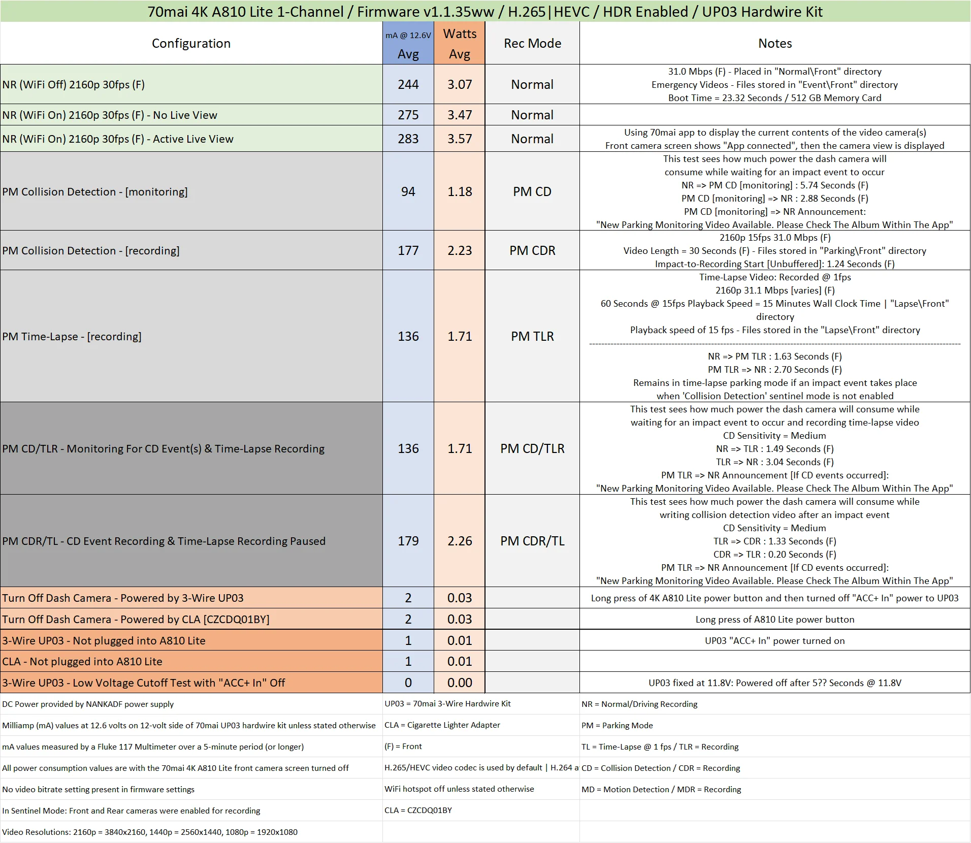

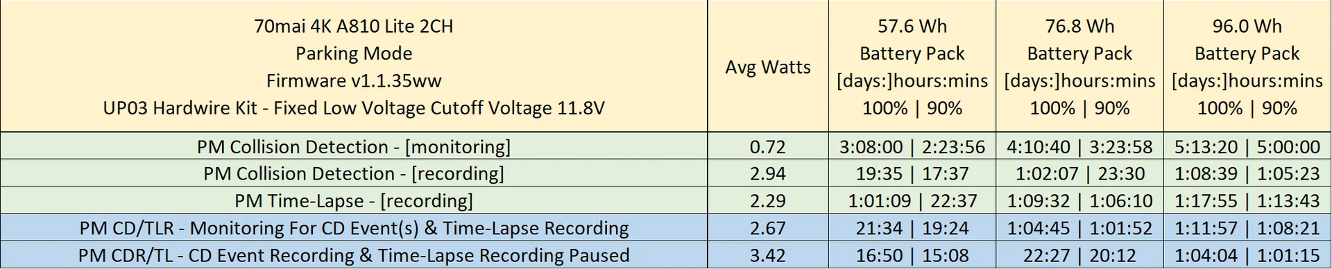

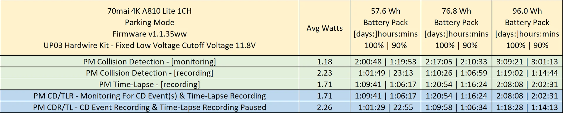

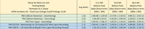

70mai A810 Lite 1-Channel Power Consumption Tests - UP03 Hardwire Kit / Parking Mode Time Estimates
[click on thumbnail image to see full size image]

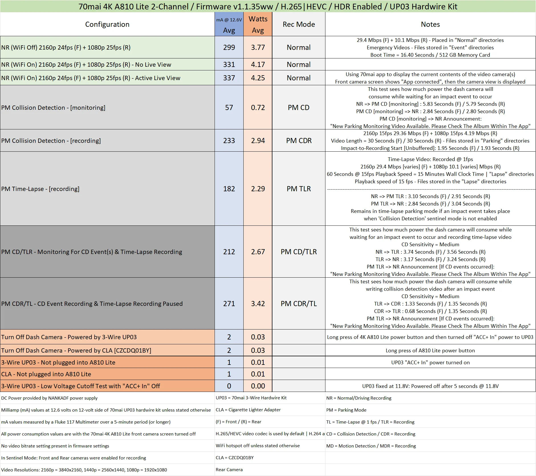

70mai A810 Lite 2-Channel Power Consumption Tests - UP03 Hardwire Kit / Parking Mode Time Estimates

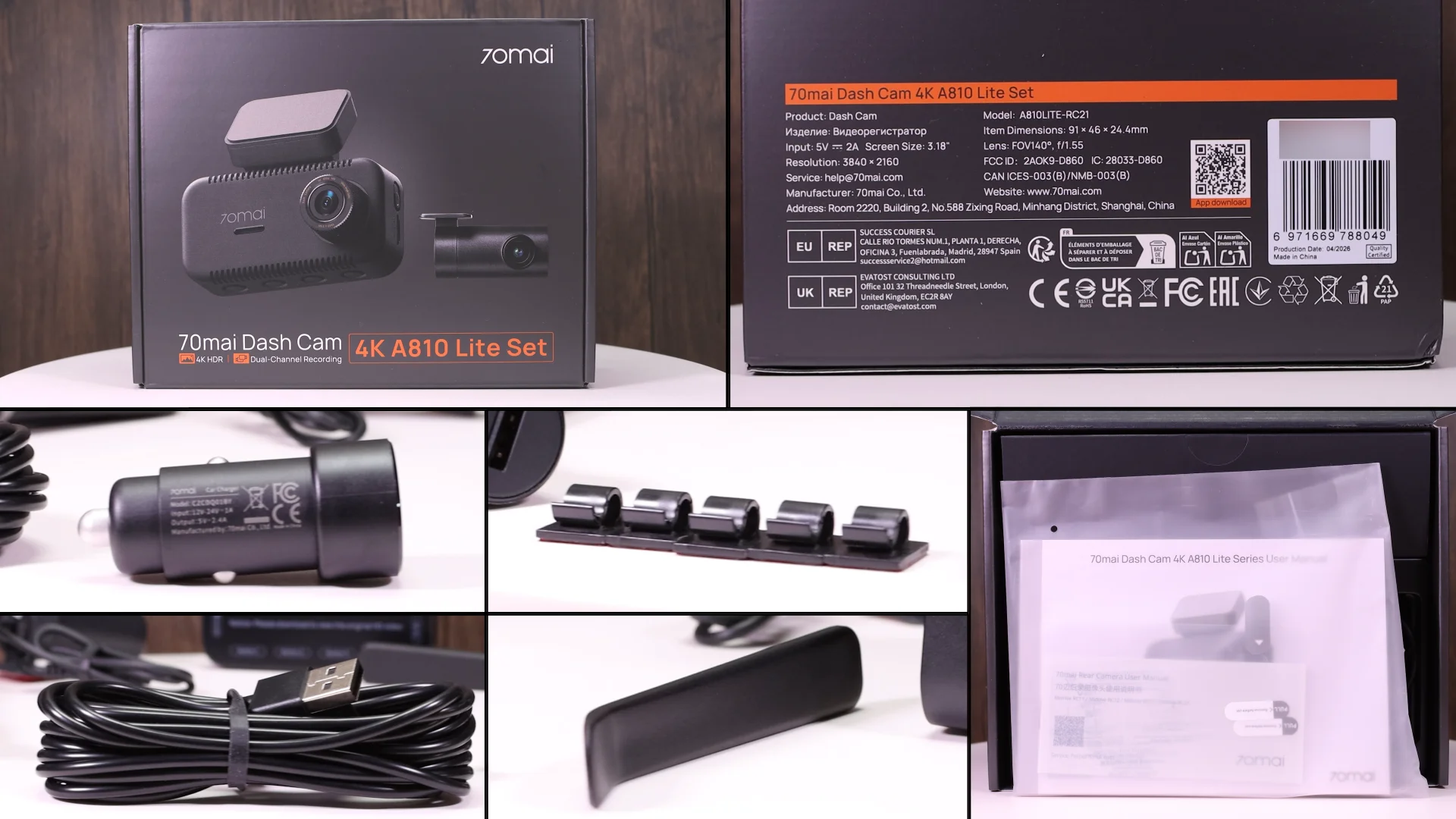

4K A810 Lite - Unboxing Pics
[click on thumbnail image(s) to see full size image]
70mai_A810_Lite_Unboxing0.webp70mai_A810_Lite_Unboxing1.webp70mai_A810_Lite_Unboxing2.webp70mai_A810_Lite_Unboxing3.webp
