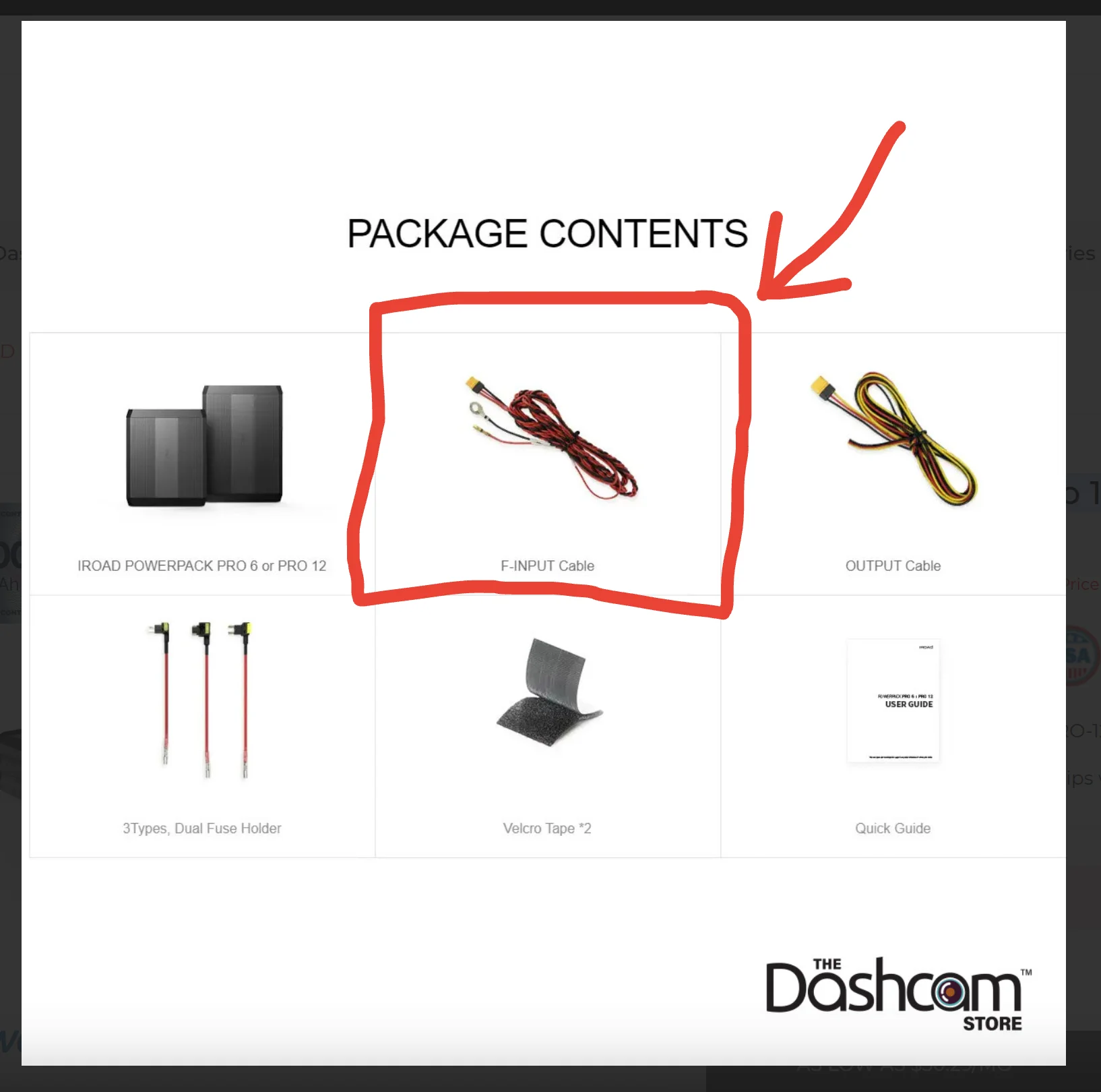

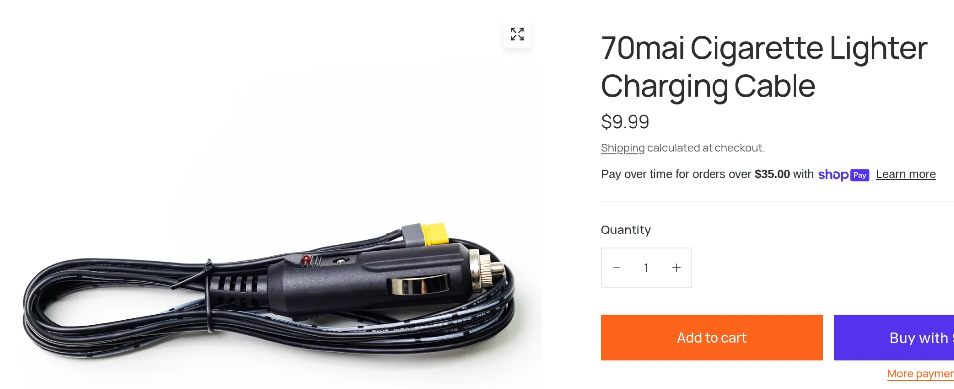

I do not have an IROAD Powerpack Pro 12 to confirm & verify.
It looks like they both use the same MR30 connector, but I’m not sure polarity of pins are same.
Option #1
Order 70mai Cigarette Lighter Charging Cable, and hope it works;
https://70mai.store/products/cigarette-lighter-charging-cable

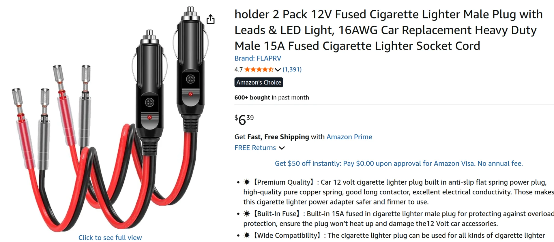

Option #2
Contact thedashcamstore.com and see if they can sell you an additional F-INPUT Cable.
Also order CLA Male Plug, and connect the two;
https://www.amazon.com/gp/B0963QJLRG

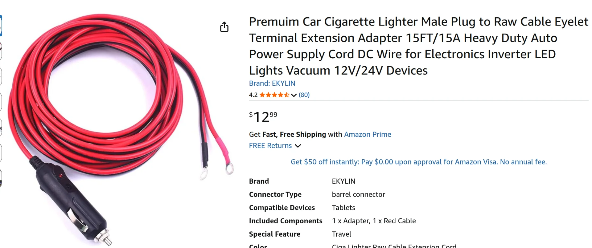

Option #3
Order CLA Male Plug 15ft, and MR30 connectors, and connect the two;
https://www.amazon.com/gp/B073XQG1QY-
https://www.amazon.com/gp/B0CB6JTF9J
Option #4
Contact @SafeDriveSolutions

I should have stated they are MR30 connectors but they are pinned differently.

The f-input and the c-input are different ( male vs female) so I dont think ordering another f input cable will work since I need to use the c inpi-ut port which is different.
