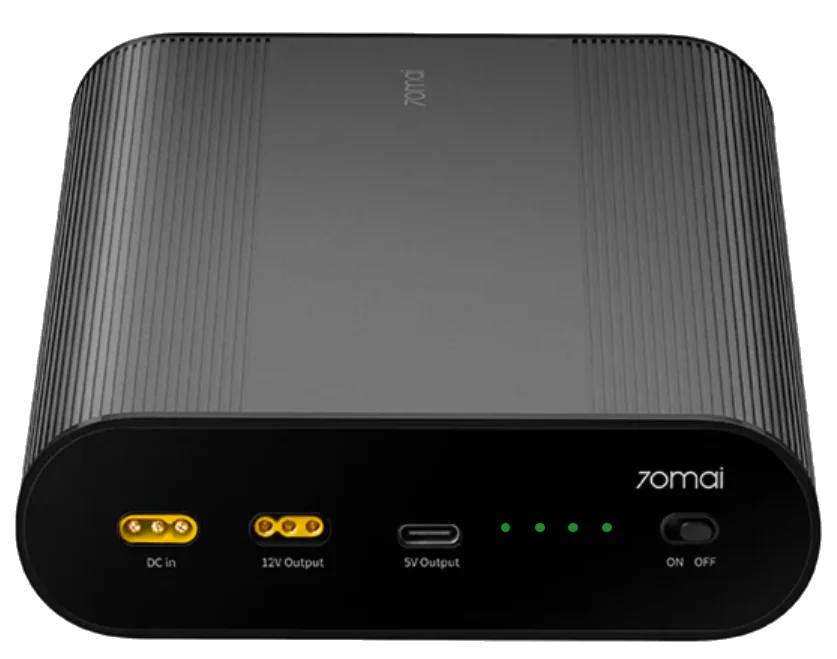

The 70mai 7500mAh Power Bank Model: BL96NNX
The 70mai power bank delivers reliable energy storage, suitable for 12-volt devices and USB-C 5-volt powered use. Here's an overview of its features and test results:

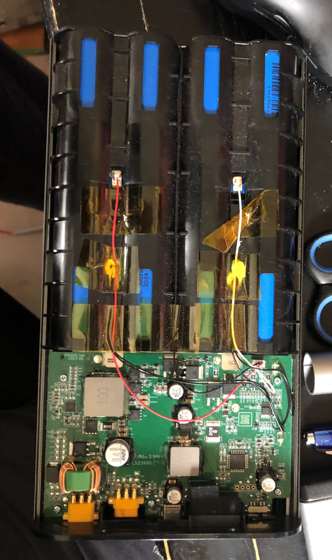

Internals of the 70mai Powerbank
Build and Design
The power bank measures 11.95 × 21.94 × 3.45 cm and weighs 1.4 kg. It has a solid build with the batteries encased in an oval aluminium case. While compact, the weight might be a consideration when mounting it in a car.

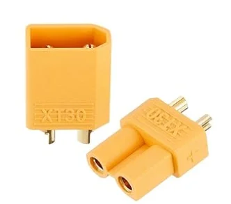

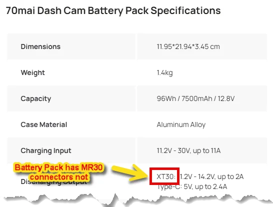

The **XT30 Correction MR30 connectors** are small and less prone to damage; however, placing the unit under a seat may, in some vehicles, expose the cables to being kicked and damaged. This risk is worse for a USB-C connector that is not at a right angle.
70mai manual states incorrectly XT30 actually MR30
The aluminium alloy case provides excellent durability and likely helps with heat dissipation, making it well-suited for regular use in varied environments.
A set of **4 green LED lights** on the unit indicate the battery's charge level, providing a quick and clear way to monitor its remaining power.

Even though the 70mai documentation states that battery pack has XT30 connectors, it actually uses MR30 connectors. I've reported this to 70mai a few times.
This is what a XT30 connector looks like:
MR30 connectors (the ones used with the 70mai battery pack):
@rcg530 Thanks for picking that up. Fixed.
I have altered it to reflect the correct item used.

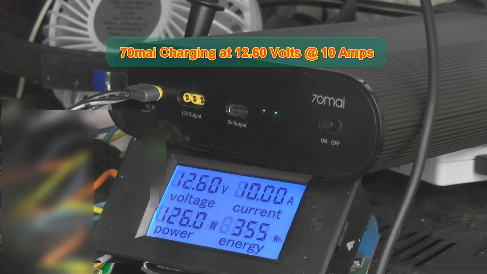

I just did a little more testing. Was checking which DMM are the most accurate lol.
I found the power bank starts to respond to power beginning connected at 11.6V but never starts to draw any current. (Not necessarily a hard finding just approx)
When I nudge it up to 11.7V is when it responds with a charging process. It looks like it is 1A but that's me reading my analogue meter!

Follow up on the question and your above comment I found this.
When my linear power supply is connected to the cigarette light socket at 11.7 Volts the approx current supplied is 1.5 Amps
This seem to be a stable result as it went for over an hour.
Then pushing the voltage to 12.8 Volts the current increased to 6.5 Amps approx.
The unit has almost finished charging.
Attempting to charge below 12.nn voltage will take a long time something close to 7 hours.
At 6.5Amps it should take less than an hour.

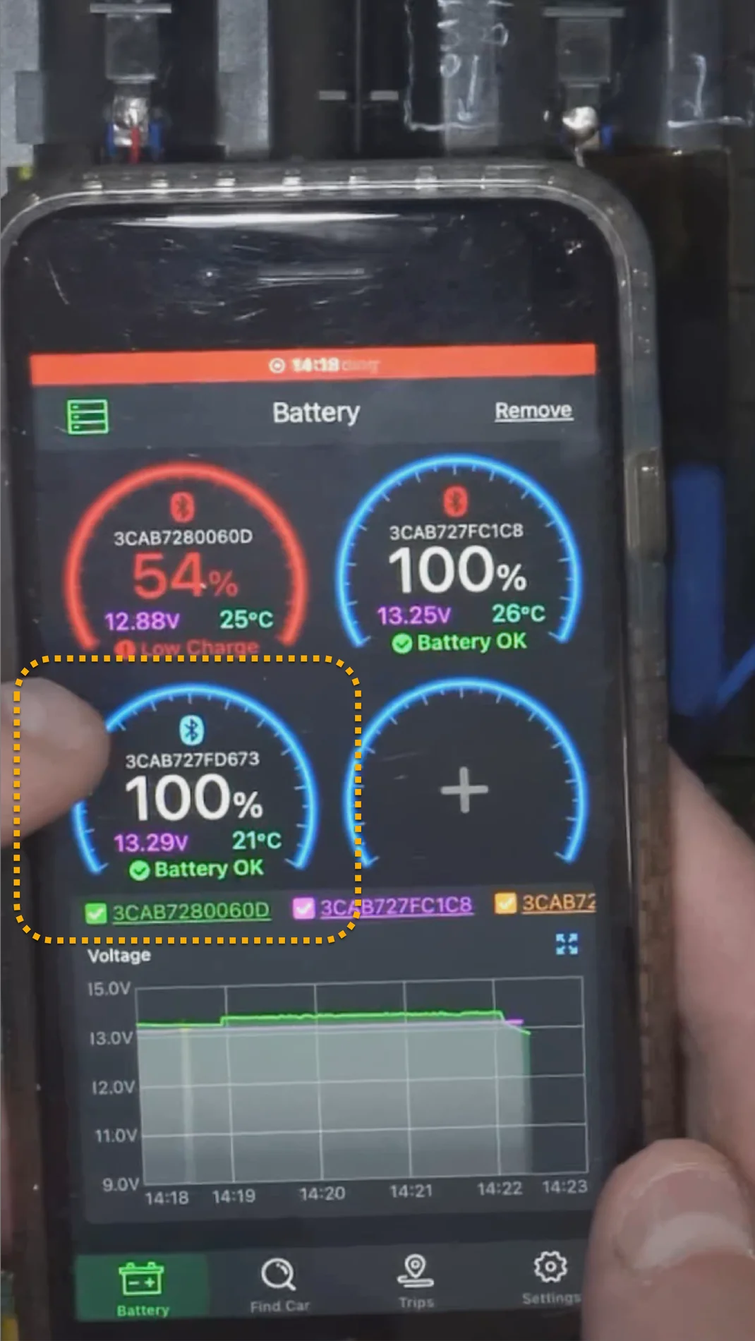

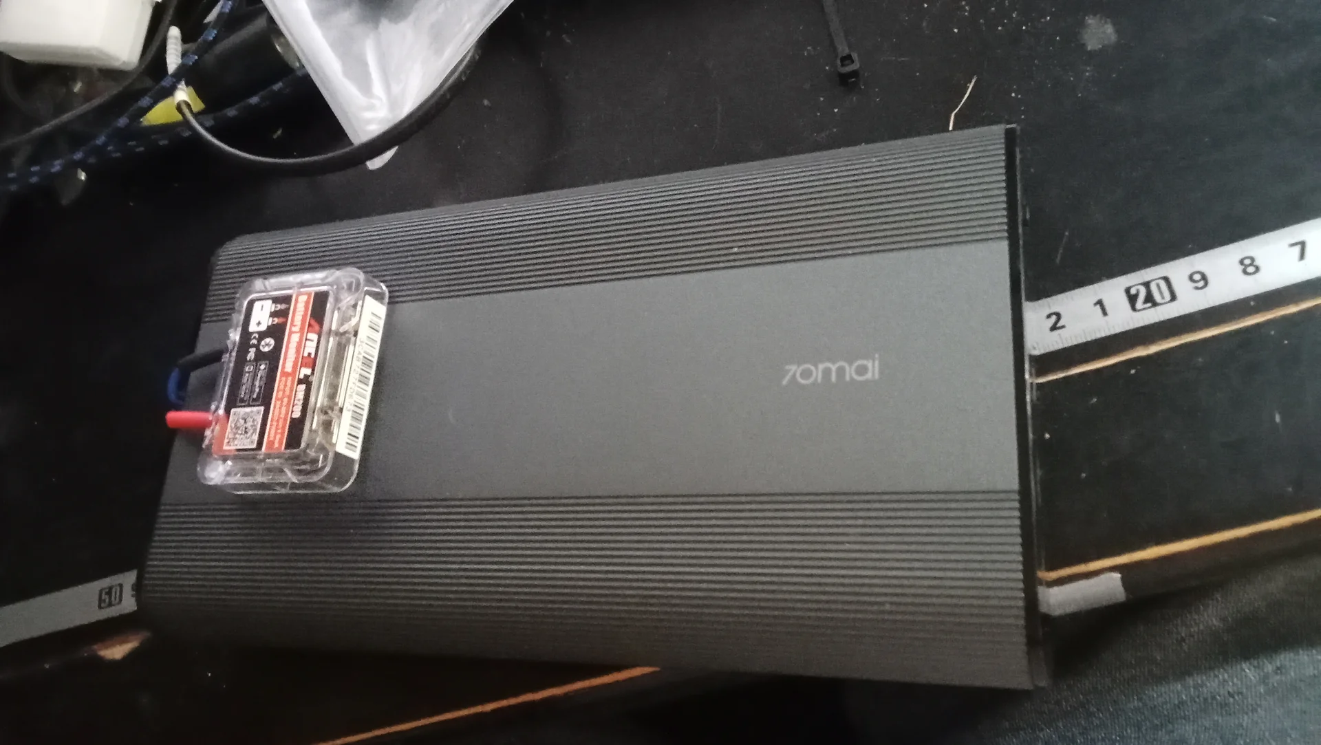

Out of curiosity I thought I would try adding Bluetooth battery monitoring to the 70mai Powerbank.
This device I have on a couple of cars and I have found it handy to check my battery state so why not add it to the 70mai battery pack that is missing this feature.
*I don't recommend attempting this mod if you are not confident in handling electronic equipment and batteries.
Now I can check the voltage of the powerbank while standing outside the car at a distance of at least 1 metre. (claimed range of 10 M )
I have it in the glovebox, but now I can place it under the seat as I don't need to see the 4 little lights on the front panel to check what voltage level it is at.
