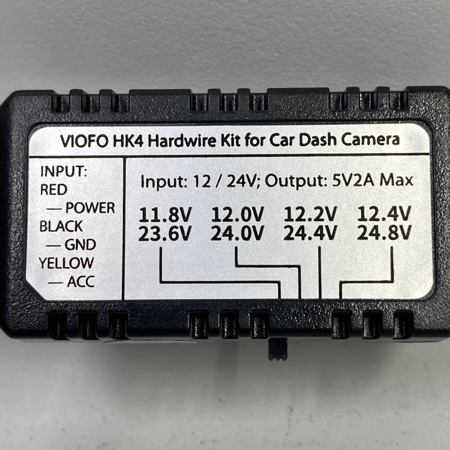

Using the PC8’s Output Cable “unspliced” with Viofo Hardwire Kit HK4, the A119 Mini had a “Low Bitrate Parking Mode” run time of;
40 Hours 2 Minutes
I noticed during the last 2 hours of the A119 Mini’s run time test in NORMAL recording mode using the CLA socket, the Cellink Neo Plus APP indicated Output voltage at 11.5 Volts, (see attached screenshot).
In PARKING MODE the PC8 remained powered up for 1 Hour 29 Minutes after the A119 Mini was powered down by the Hardwire Kit’s low voltage cut off set at 11.8 Volts.

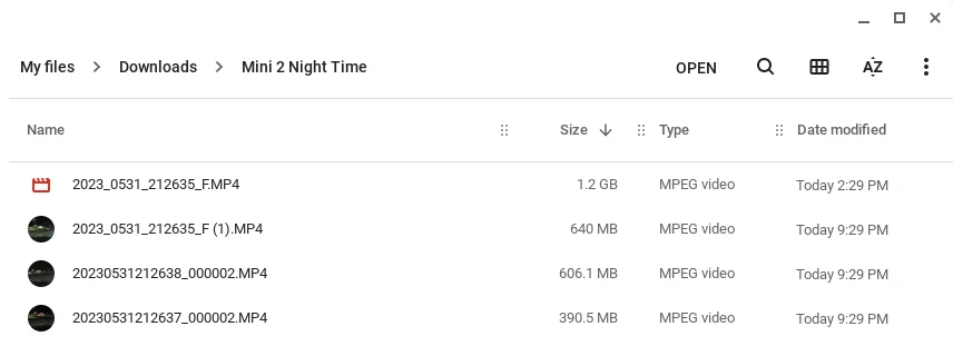

As an interesting side note take a look at the difference in file size for these 3 minute clips.
A139 Pro: 1.2 GB
A229 Duo: 640 MB
A119 Mini 2: 606 MB
A119 Mini: 390 MB

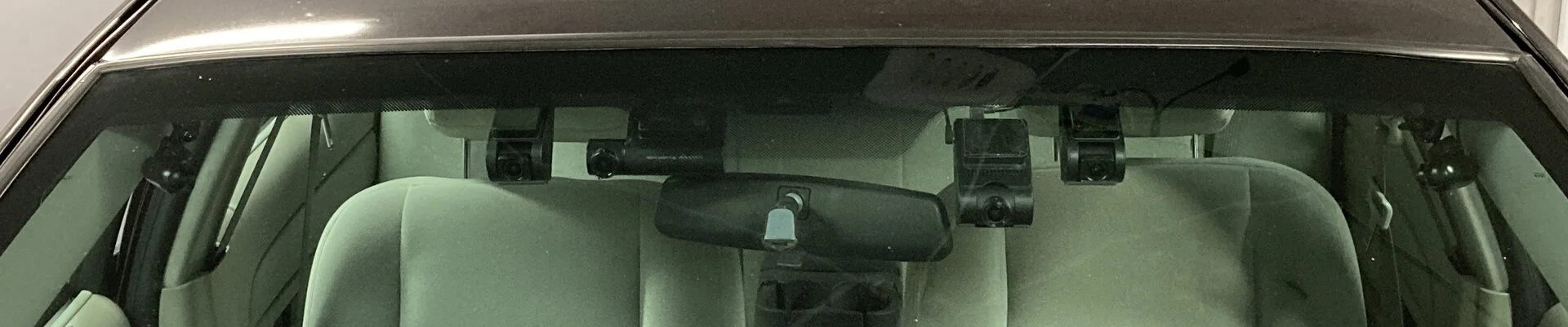

Here’s some daytime test footage of the A119 Mini 2, Original A119 Mini, A139 Pro, and A229 on the front windshield.

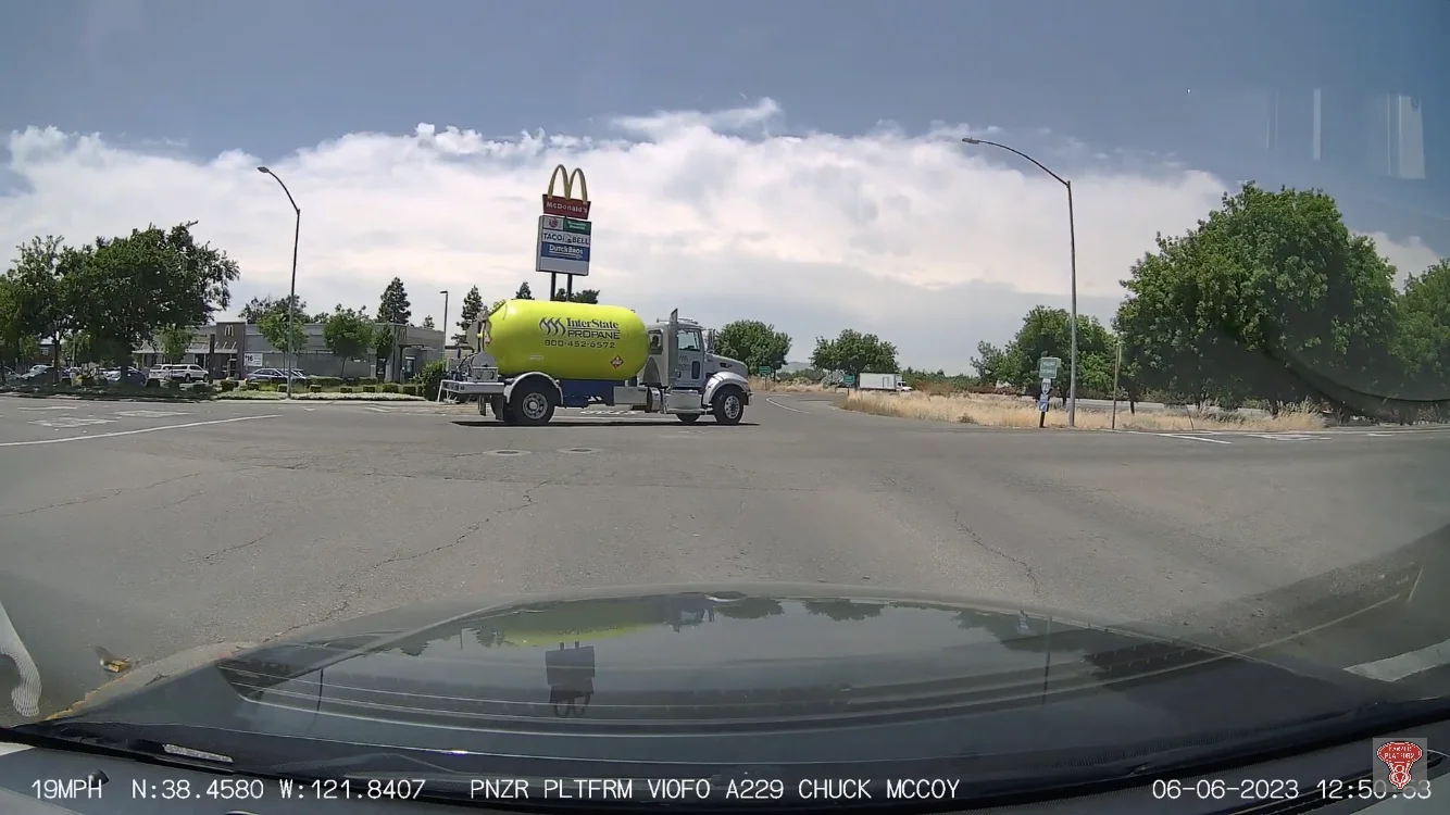

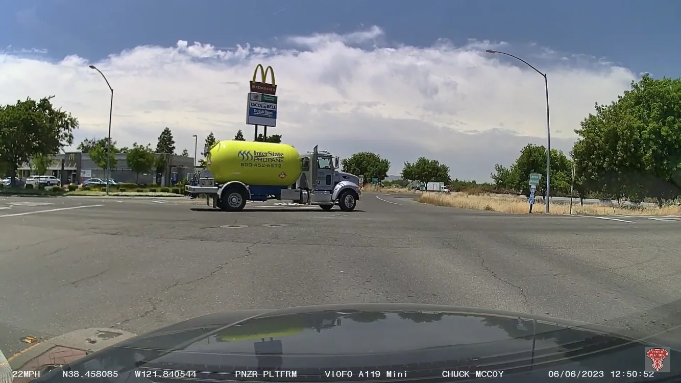

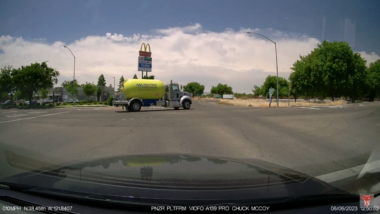

Here’s some daytime Highway test footage of the A119 Mini 2, Original A119 Mini, A139 Pro, and A229 on the front windshield.
Check out these screenshots from the A119 Mini 2, Original Mini, A139 Pro, A229.
I really like the narrow FOV of the Original Mini.
I wish all my dash cams were that narrow.
