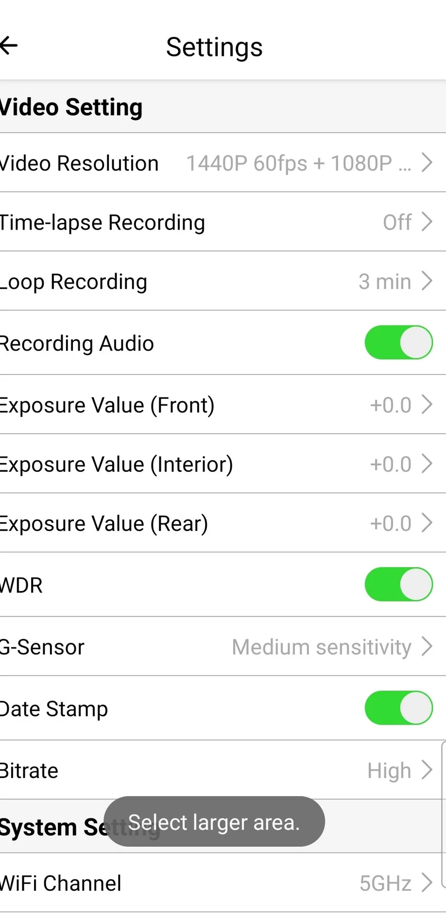

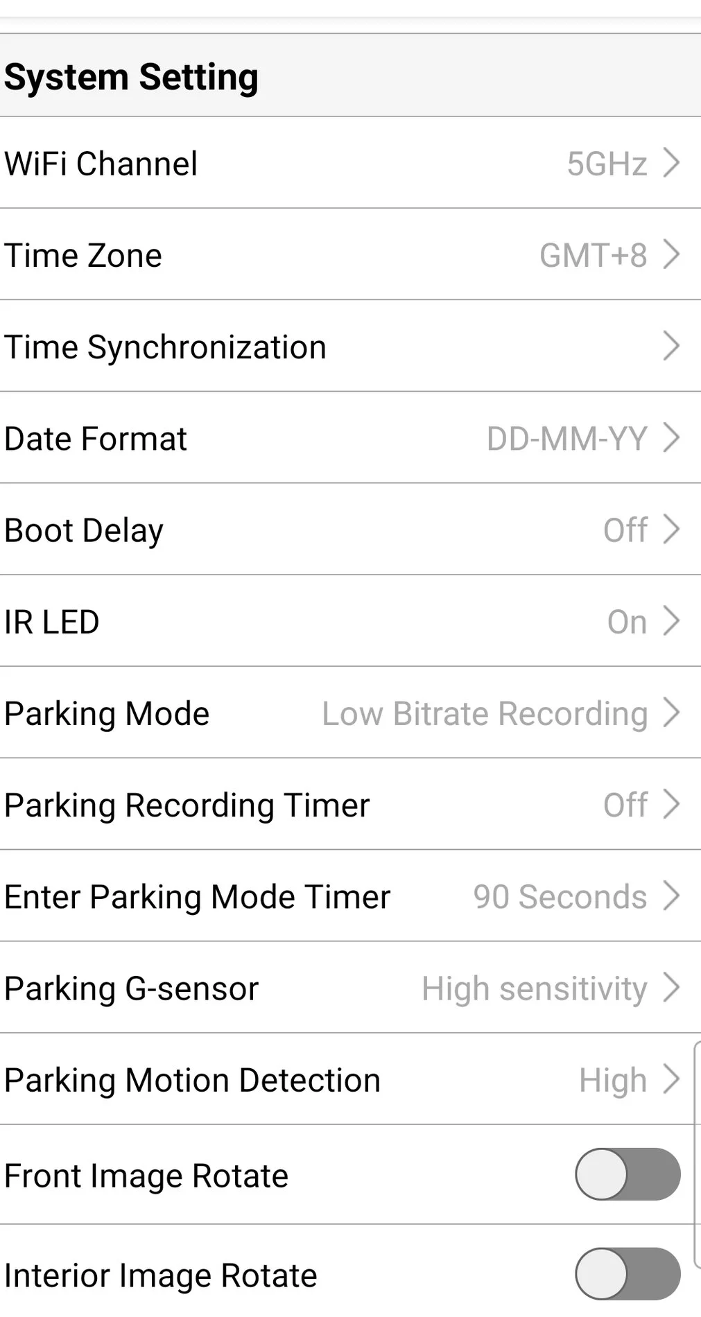

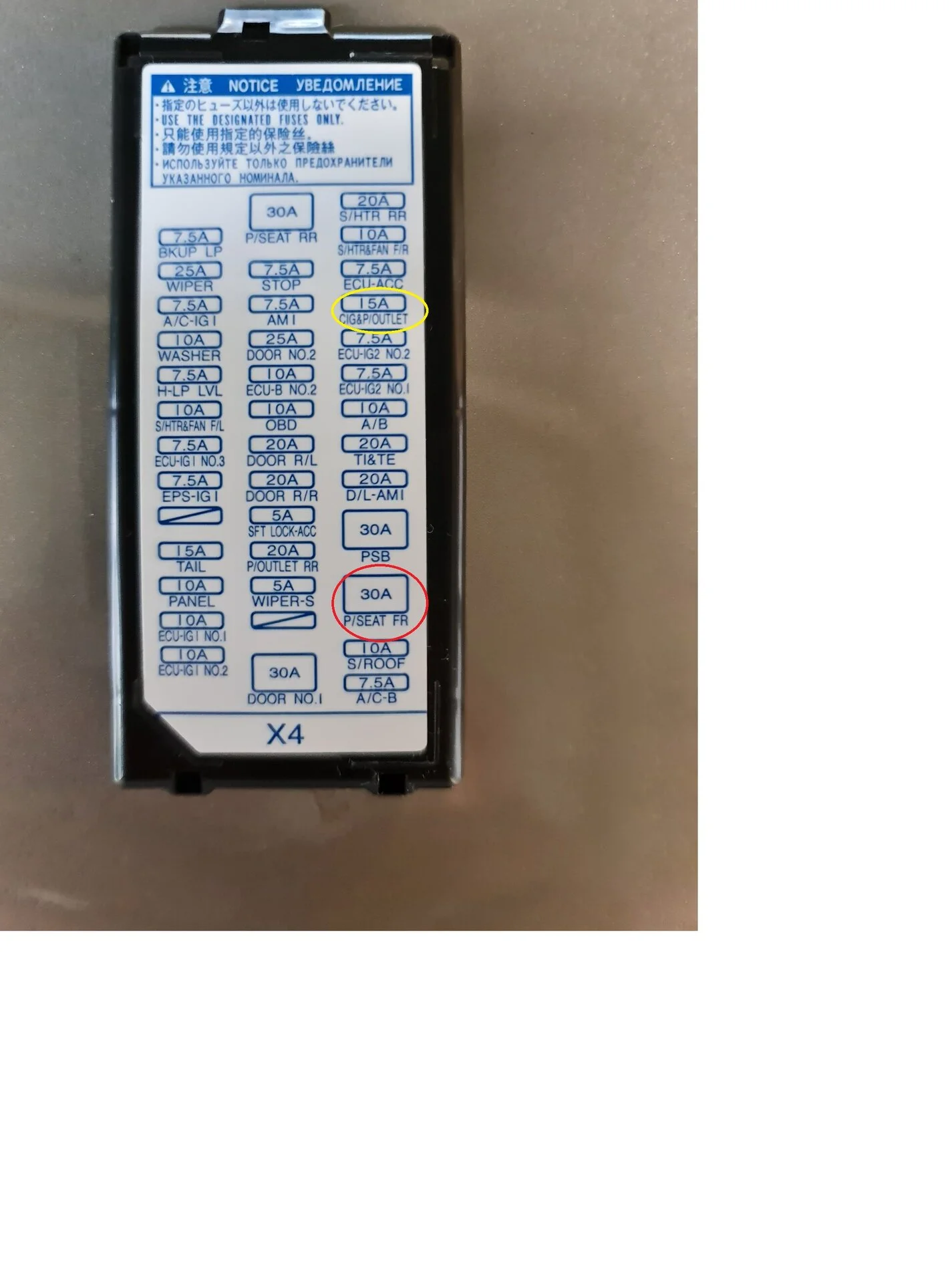

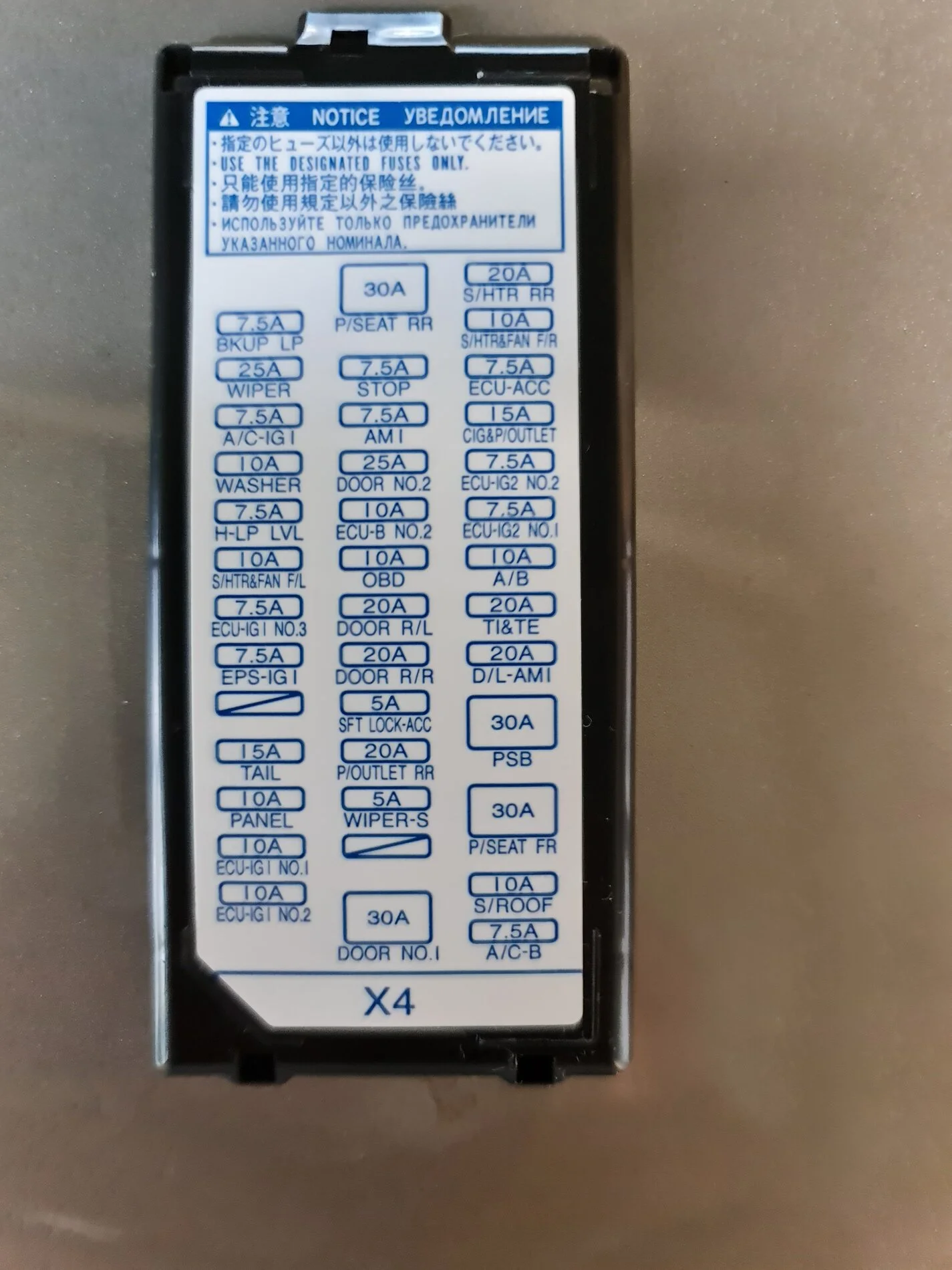

I have just bought Viofo A139 (3ch) (Interior Camera not connected yet). I also bought Viofo hardwire kit. I have connected the Battery wire (Red) to "ECU-B No.2" fuse and ACC wire (Yellow) to "CIG&P/OUTLET". Have set Parking Mode to "Low Bitrate Recording", but it turns off 2 minutes after I have turned off the car. Please see attached images of my settings. What am I doing wrong?

Welcome to the forum KPK.
You are probably driving a car with canbus or some other smarts in the wire harness, this complicate install of things like hard wire kits for dashcams.
As it is winter down your way i doubt it is heat that do it, and so fast, and if it do it after 2 minutes every time, it is probably some smart in your wires that do it.
My advise would be to try another fuse for the 12 V battery / always on fuse, you can also try and test the one you use now after some minutes where something shut off, personally i use a cheap LED probe from the dollar store.
I can see you have the parking mode timer set to off, this mean parking mode will be on until the camera hit the cut off value you have selected on the hard wire kit.

It seems that the 'bat' wire is connected to a fuse whioch is dropping power after you switch the car off. It's a common problem with today's cars having computer-controlled power schemes. You need to try tapping power from another circuit.
Suggested Fuses: Red Circle for Battery. Yellow for ACC.
Those should work I believe.
