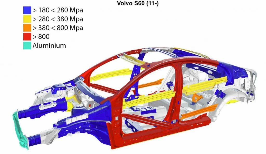

I drive a 2015 Volvo S60 that's dealer maintained and genuine parts. We're not talking a crap car. But yes, the doors are very heavy on a Volvo. So that could be one reason that shutting the door "normally" but slightly hard triggers enough vibration.
Volvo uses Boron Steel, not the lightest Material
