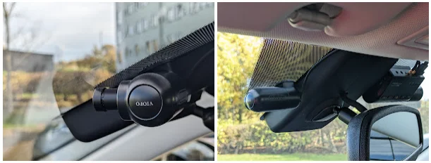

A couple of days ago I repositioned the 6mm camera. It was high on the driver's side (right) at the very top of the wiper arc, but rather obvious from both inside and outside of the car.
1667221041332-png.62185
Now it is mounted on the frit on the left side and barely visible from the outside. As you can see, the lens is almost touching the glass. If I want to try a larger 8mm lens I will need to modify the mount with spacers.

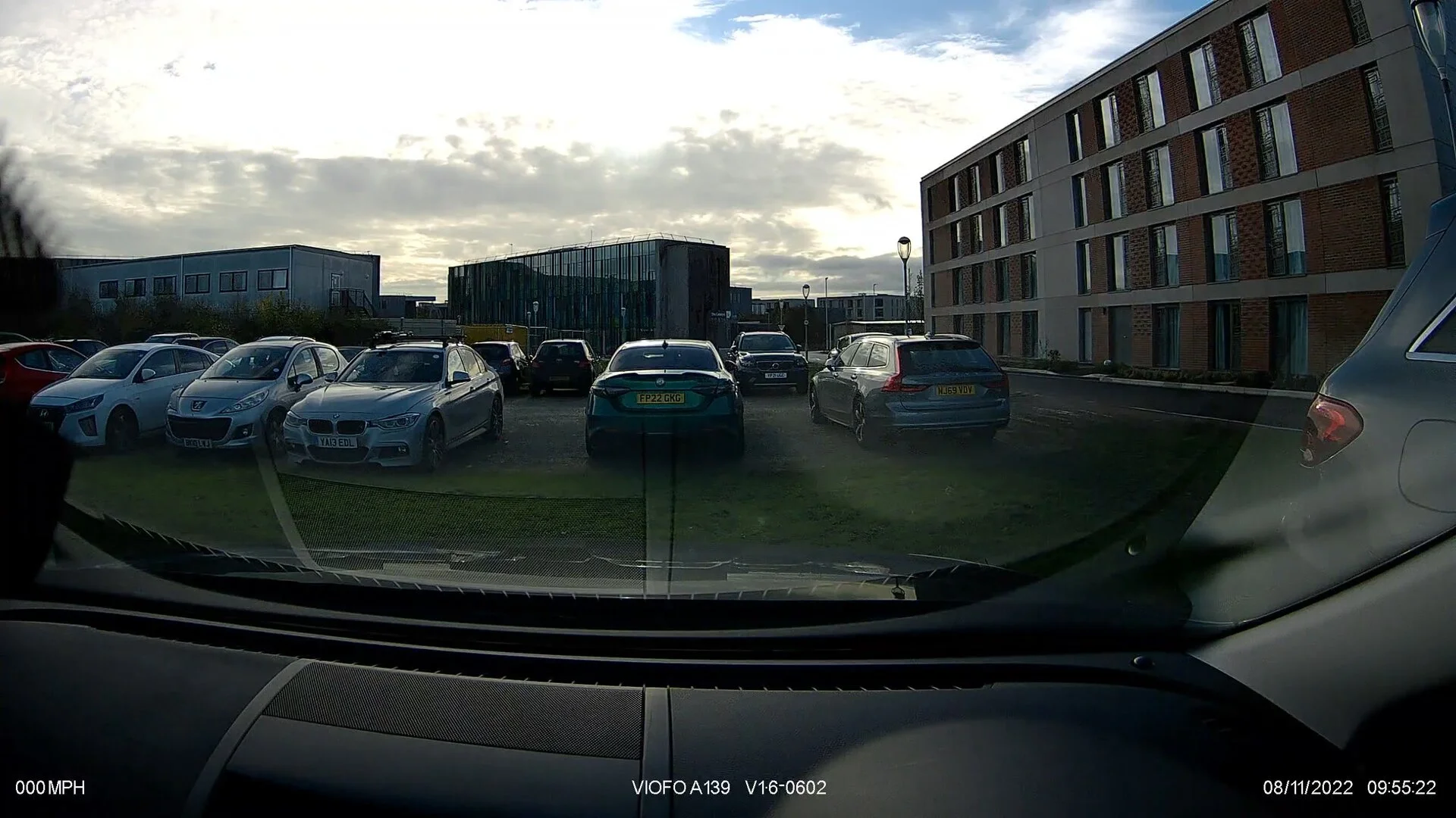

Moving the camera down a bit now shows the front edge of the car along the bottom of the video, as seen in this comparison with the A139 main camera. Whilst I think this is useful to show context in a telephoto video if viewed on its own, I would rather have a bit more reach from an 8mm lens.
This example looking towards the sun also demonstrates how the metering on a telephoto camera is less affected by bright areas in the sky (no CPL on either camera, both set to EV+0).

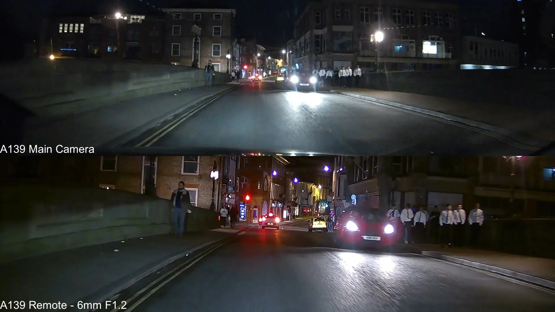

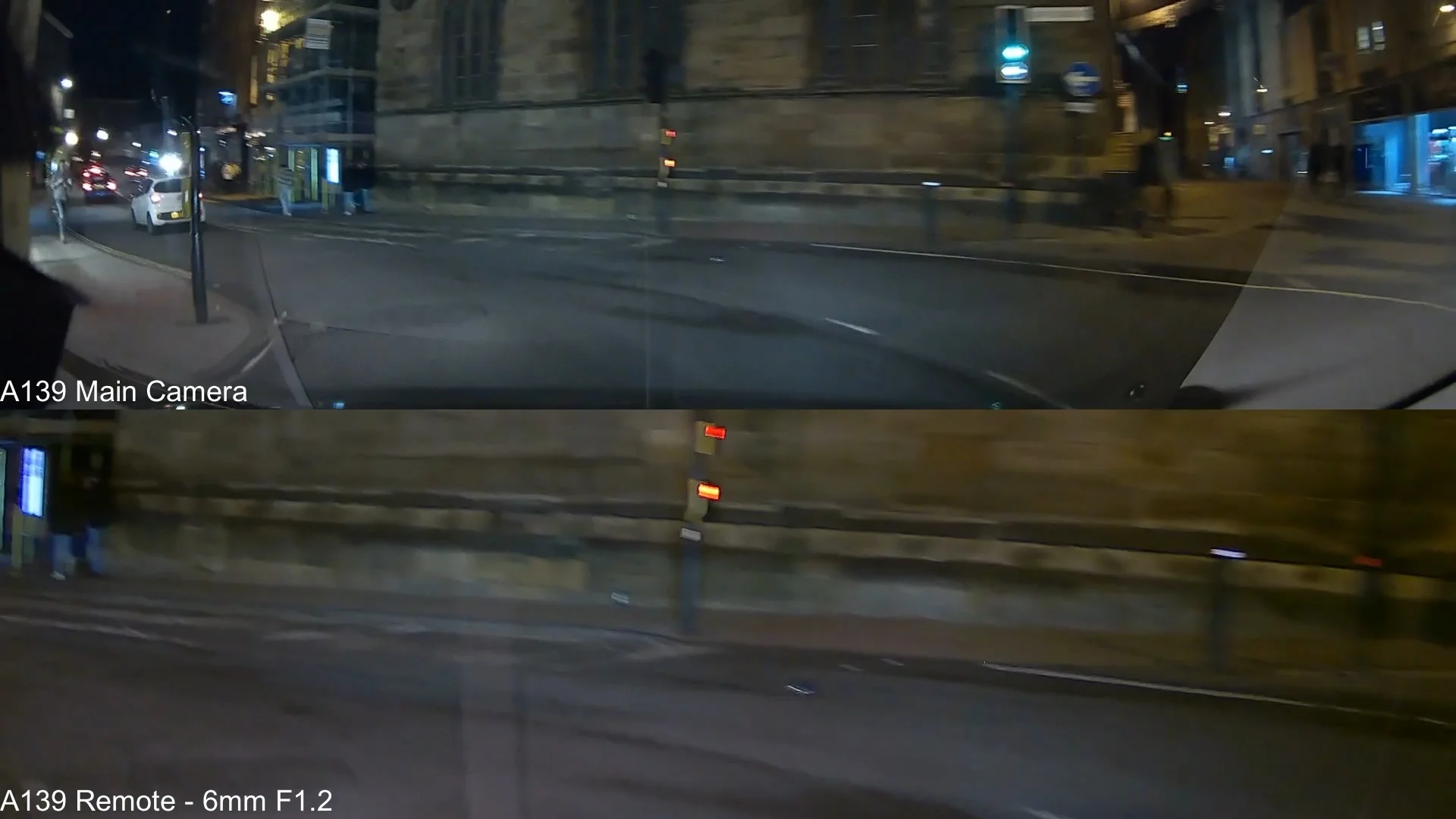

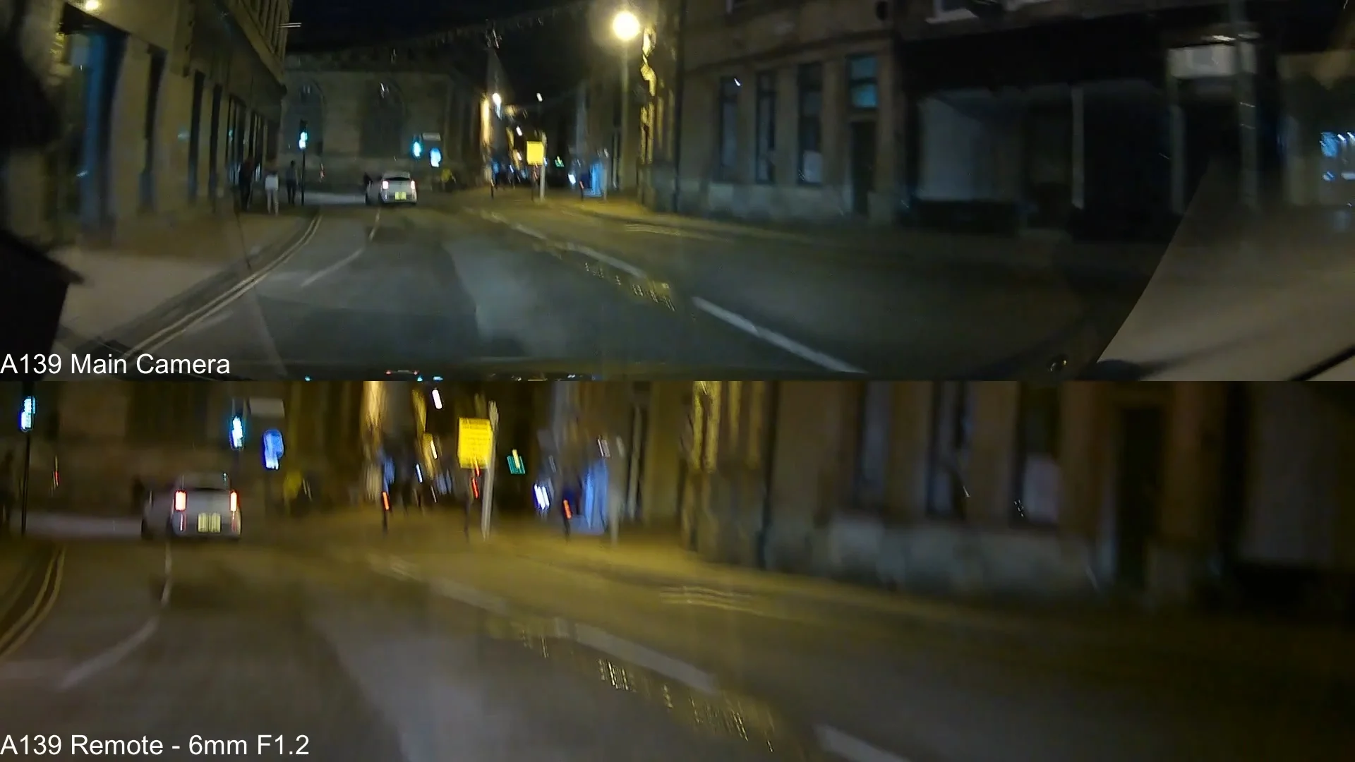

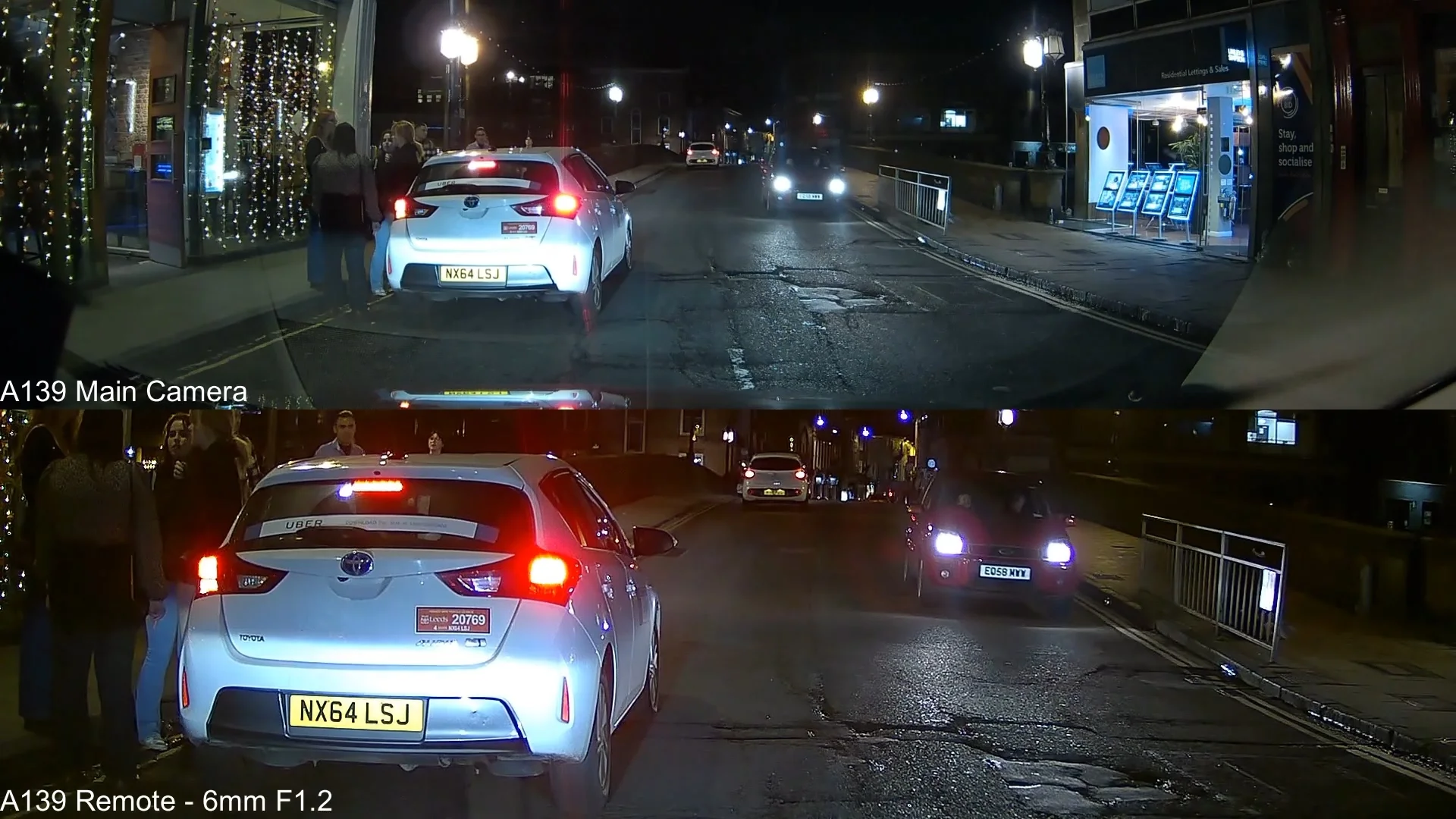

A139 Main Camera & Remote 6mm F1.2
I think this side-by-side example shows some of the positive and negative things about using a telephoto dashcam. However, when used in combination with a primary camera, together they have the potential to complement each other rather than simply duplicate the same information in both video streams.
Positive:
- Increased detail in the middle of the view directly ahead of the car
- Increased chance of plate capture - we can identify the first red car, but not the second one
- Bright highlights are a larger part of the scene, so the metering adjusts and captures highlight detail
Negative:
- Cropped view loses information at the sides, particularly when driving around corners
- Exaggerated movement when bouncing over bumps or turning sharp corners
- Metering for highlights means that shadows are very dark
