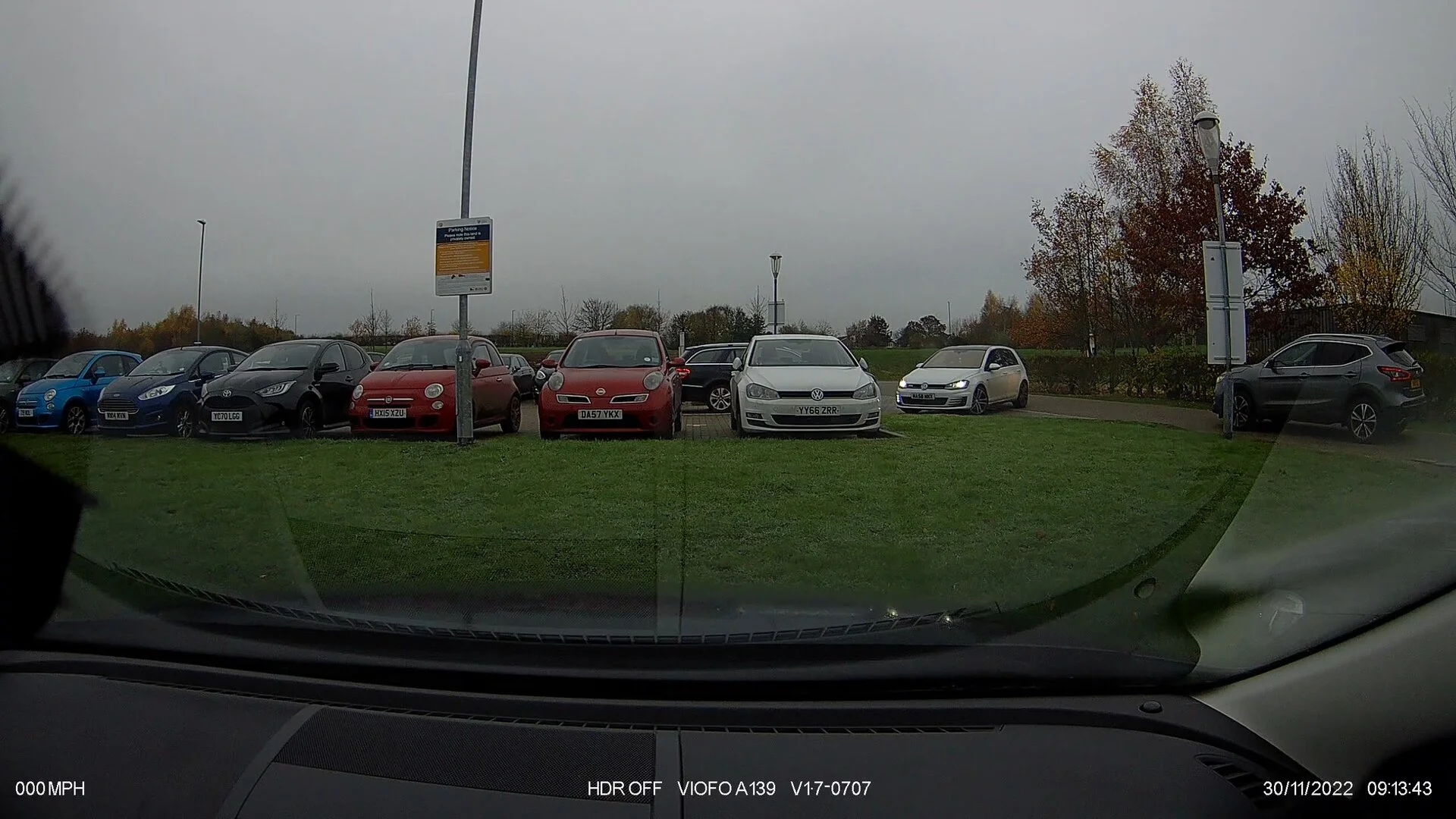

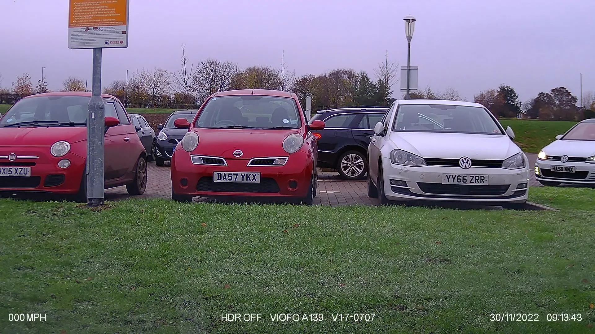

Moving the camera down a bit now shows the front edge of the car along the bottom of the video, as seen in this comparison with the A139 main camera. Whilst I think this is useful to show context in a telephoto video if viewed on its own, I would rather have a bit more reach from an 8mm lens.
This example looking towards the sun also demonstrates how the metering on a telephoto camera is less affected by bright areas in the sky (no CPL on either camera, both set to EV+0).

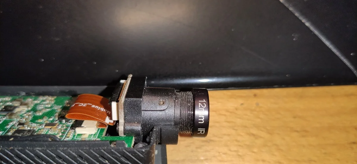

The long "barrel" is a challenge i think, i dont think you could sell something that look like that.
The 12 mm lens i use in my tele camera are short.
I tend to agree that most consumers will not want a long lens, even for telephoto purposes. After all, they now have telephoto lenses in smart phones, without a big lens sticking out.

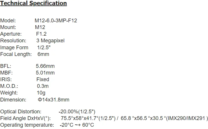

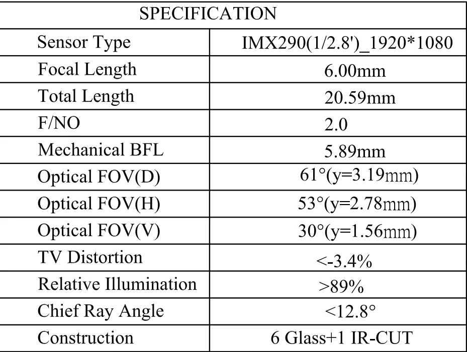

What do you think about this version, it is much shorter than your version.
That is about 10mm shorter in physical length than my 6mm lens, so it would work for a larger range of windscreen slope angles and would be less obvious to others. I think a shorter lens is attractive for a consumer product.
The main performance difference is that it is F2.0 aperture, compared to my lens at F1.2. On a positive note the F2.0 lens has less distortion, although I don't really notice any distortion on my telephoto so that might not make much difference.
The Mechanical BFL of 5.89mm should be OK to use in the A139 remote camera without an extender.

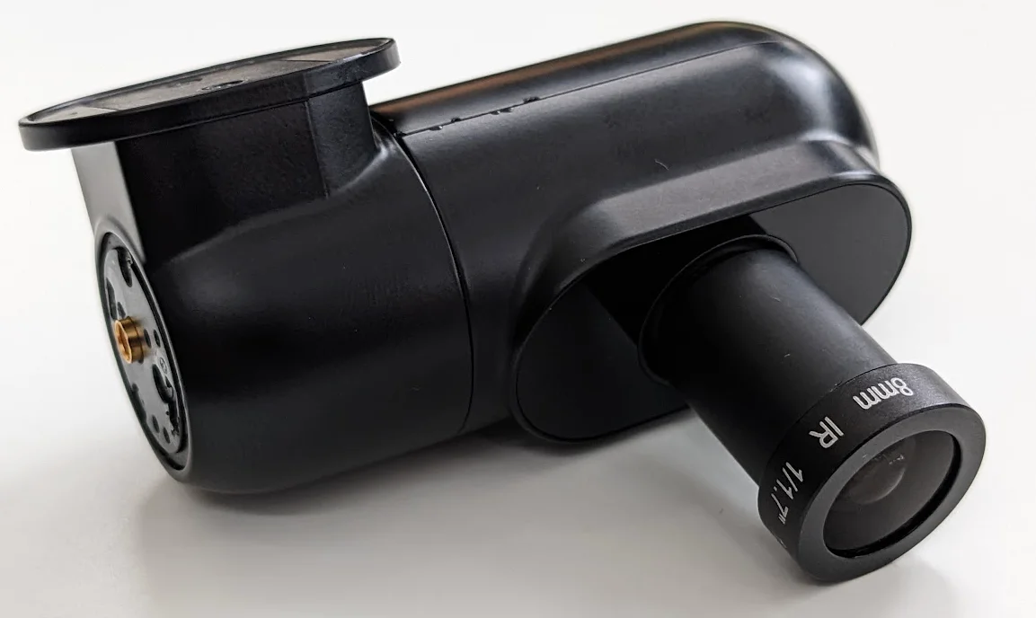

A139 Remote Camera - 8mm Focal Length Telephoto
A few weeks ago I ordered an 8mm focal length lens from AliExpress, which arrived at the weekend:
4K Lens 12Megapixel M12 1/1.7" 8mm
The 14mm barrel diameter is 'just' small enough to slide through the existing opening on the A139 rear camera, which was a consideration in my purchase.

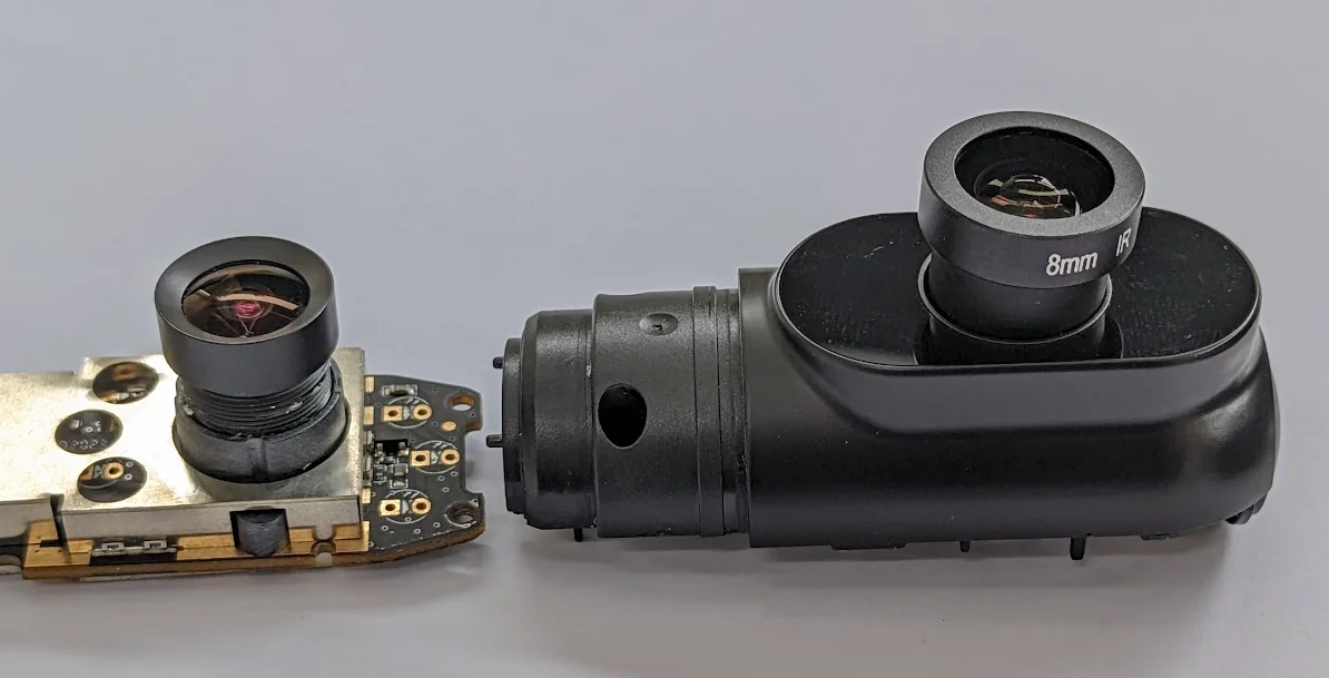

Original rear lens still in holder on the left / new 8mm lens within the camera housing on the right.

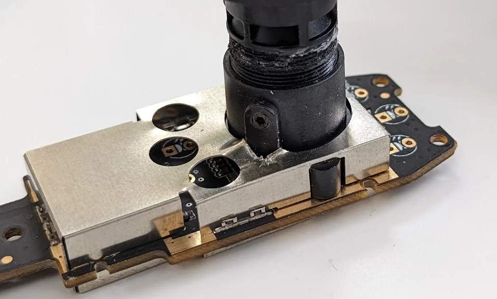

The MBF of 6.8mm is only 1.7mm more than the 6mm F1.2 lens I have been using so far, but it was just enough difference that the new lens did not engage the threads of the M12 holder. I had measured the depth of the lens holder at 8.8mm before buying the lens which I thought would be enough, however the sensor has a certain thickness which I did not measure and this turned out to be an oversight on my part.
I do have an M12 extender, but that pushed the lens too far away from the sensor. So, the only real solution was to replace the lens holder. Thankfully, I have a few boxes of spare parts 🙂
It turns out that the 12mm deep lens holder from a Mobius C2 camera fits exactly! Well, nearly exactly. I did have to make a 1x1mm snip out of the RF shield for the moulding on the side of the lens holder. I was surprised that the PCB fixing screw centres were identical (17.5mm?), as was the 15mm square base which as you can see was crucial to fit within the RF shield.
The good thing about this lens holder is that it has a tiny grub screw to secure the lens, which is just as well because there was not enough space within the housing to fit a threaded lens collar. After some testing to determine the best focus position I will secure the lens with some UV glue.
Thankfully it all fits together neatly without any modification to the camera housing 👍

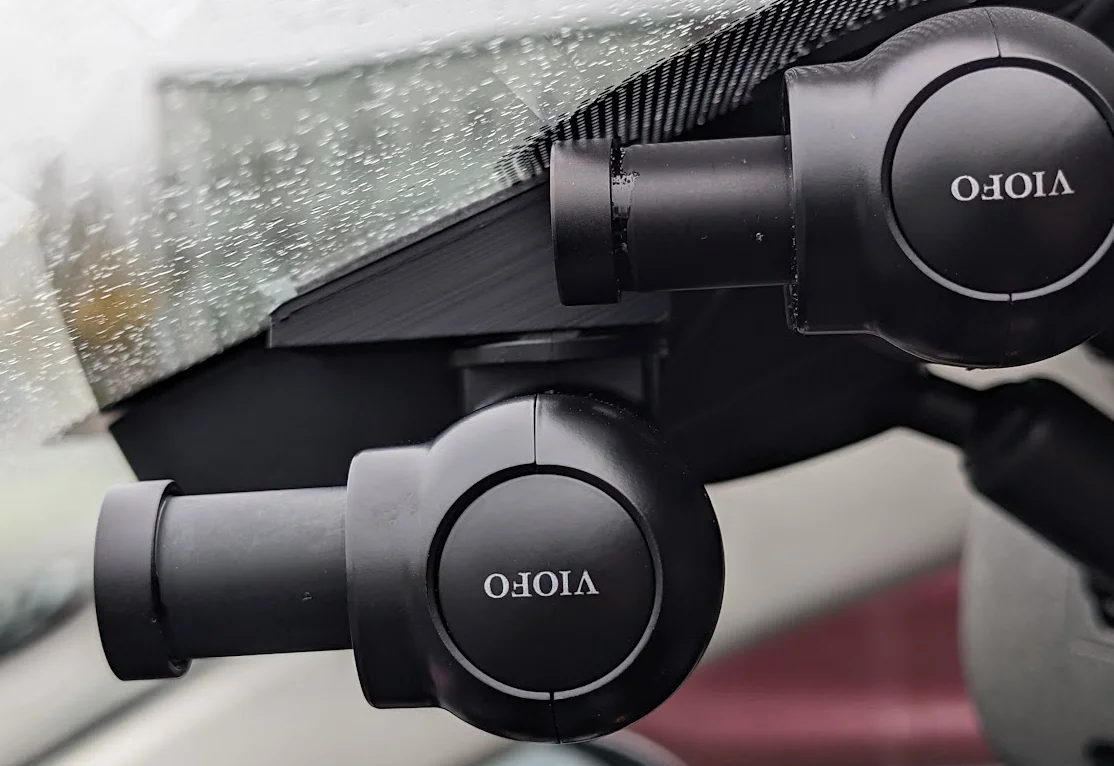

A139 Remote Cameras - 6mm & 8mm Lenses
I have both 6mm and 8mm remote cameras installed together on the passenger side (left) - the main A139 is on the driver's side (right). And yes, I have the 6m long rear camera coax cable stuffed into the headliner!
Due to the extra length of the 8mm lens, I mounted it using a small 3d-printed wedge to ensure clearance to the glass. A shorter 8mm lens would be preferable for cosmetic reasons, however I can mount this long lens on the frit where the 6mm camera is now, and then it will be hard to see from the outside.

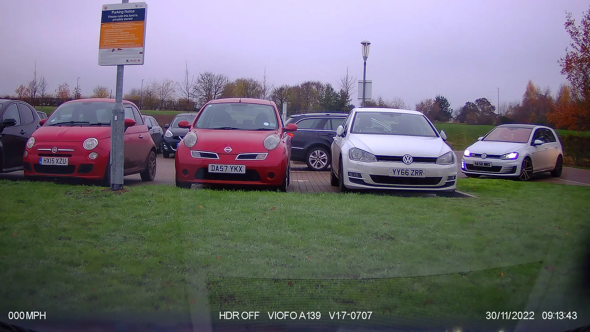

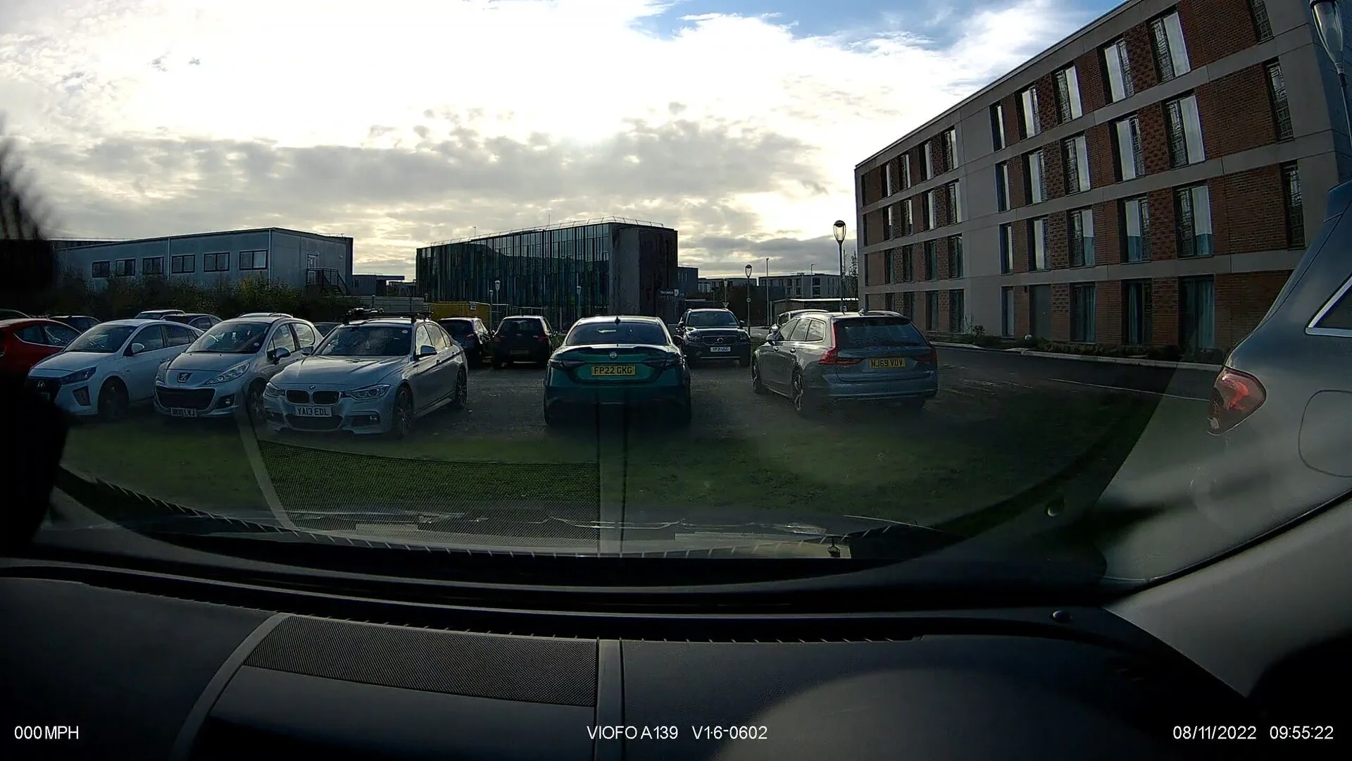

6mm vs 8mm - Field of View Comparison (6mm left / 8mm right)
There is not a big difference in the width of the scene recorded by each camera. The front edge of my car appears along the bottom edge of the 6mm video which could be useful to provide context if used as a standalone video. However my intention is only for the telephoto to complement the main wide angle camera, so I don't think I need that context within the telephoto video. The reflection of my dashboard is less intrusive in the 8mm image, which might be because the 6mm lens is almost touching the glass. That dashboard reflection may also be the reason for less contrast on the 6mm camera.
For reference, this is the wide angle view on the A139. It is interesting that both telephoto cameras have a similar colour profile, including the magenta tint which is not apparent in the wide angle video that has a neutral grey overcast sky. Unfortunately the A139 does not offer the user any options to adjust the white balance or any other IQ parameters apart from the EV. I have the 6mm F1.2 camera set to EV-0.3 because I found that at EV=0 it was over-exposed and used longer exposure times than necessary.

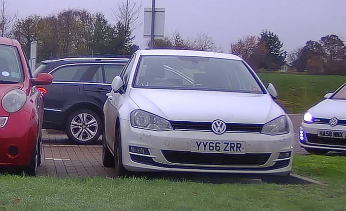

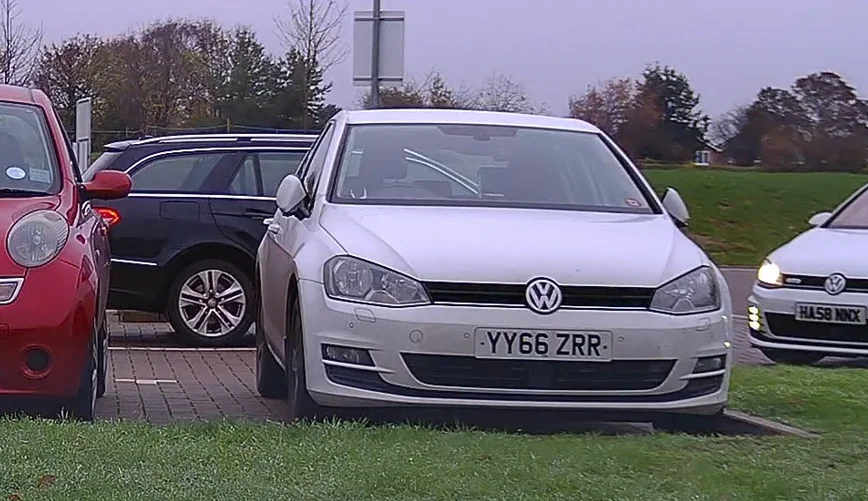

100% Crop Comparison - (6mm left / 8mm right)
The 8mm lens records finer detail, as expected. The 12MP rating and F1.8 aperture also help in this regard, compared to 3MP and F1.2 for the 6mm. I can also see that the 6mm has significant chromatic aberration and less contrast.
I expect the 6mm F1.2 to have less motion blur than the 8mm F1.8, so it will be interesting to compare performance on the road rather than in a car park.

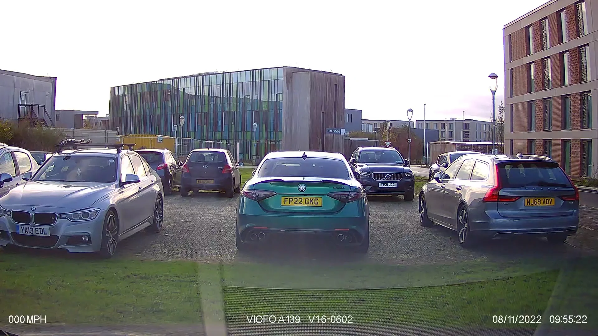

A139 Pro 4K HDR and 8mm Telephoto Remote - Into Low Sunlight
I bought an A139 Pro to replace the regular A139. I am using the same 8mm telephoto remote camera.
Although the 4K wide-angle and 1080p telephoto lens capture the scene with a similar pixel density, I have found that the differences in metering and HDR on vs. off result in two quite different video versions. Sometimes one is better than the other, but I like having both.
In this example I could identify 9 out of 13 oncoming vehicle number plates with both cameras, but it is the difference in exposure that stands out.
4K30 46Mbps, HDR-ON, CPL-OFF, EV=0
1080p30 16Mbps, EV-0.3
