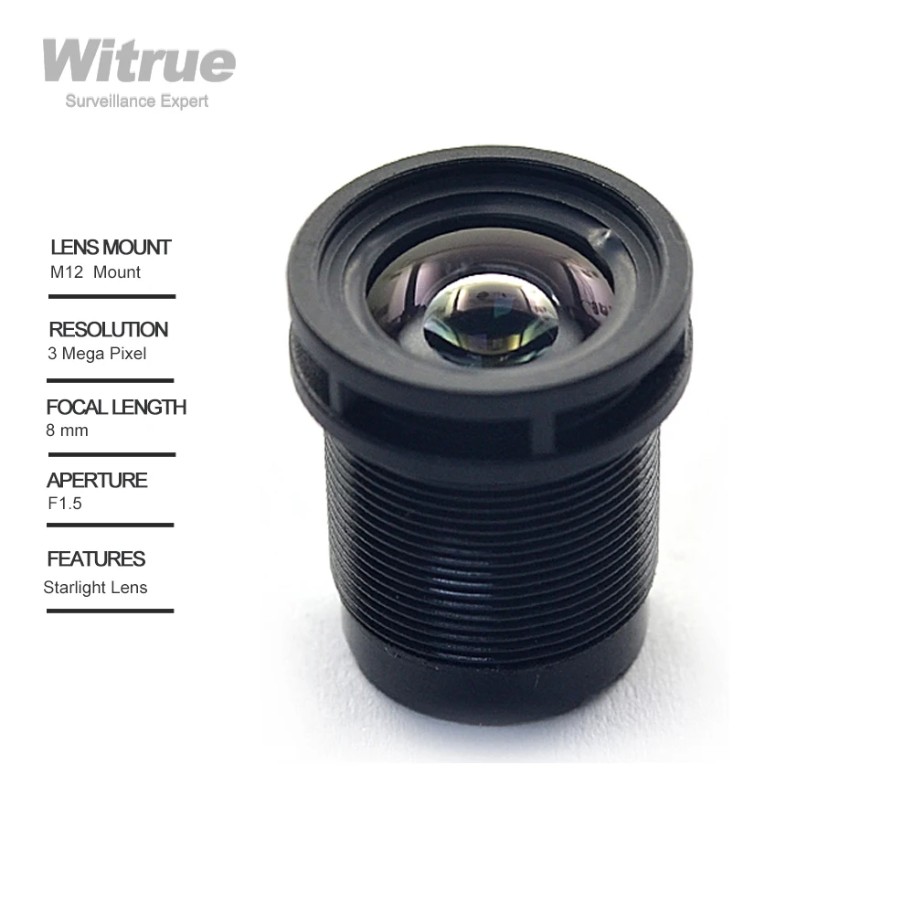

I am looking at short, compact 8mm lenses like this to match the A139 remote cameras:
Witrue Starlight Lens 3MP 8mm Fixed Aperture F1.5 Big Angle For SONY IMX290/291/307/327
I am afraid the 10mm and 12mm lens FOV is too small.
Also we need to balance the lens length, too long does not look good.

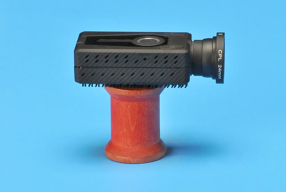

Feels like this set-up needs a polarizer though so you can see the occupants of the vehicle behind you. Perhaps the driver is on a cell phone or engaged in some other distraction.
As a fellow DIY telephoto dash cam enthusiast you know that I find a CPL to be a requirement for these installations. Of course, finding and fitting a suitable CPL to small diameter lenses can be a challenge but it makes a huge difference.
Yes, I agree. Assuming I can find a short enough 6mm lens, I plan to attach a polarising filter to the remote camera housing, similar to what I did here. If the 6mm lens extends beyond the housing I may need to add a simple spacer, such as a VHB pad each side of the lens.

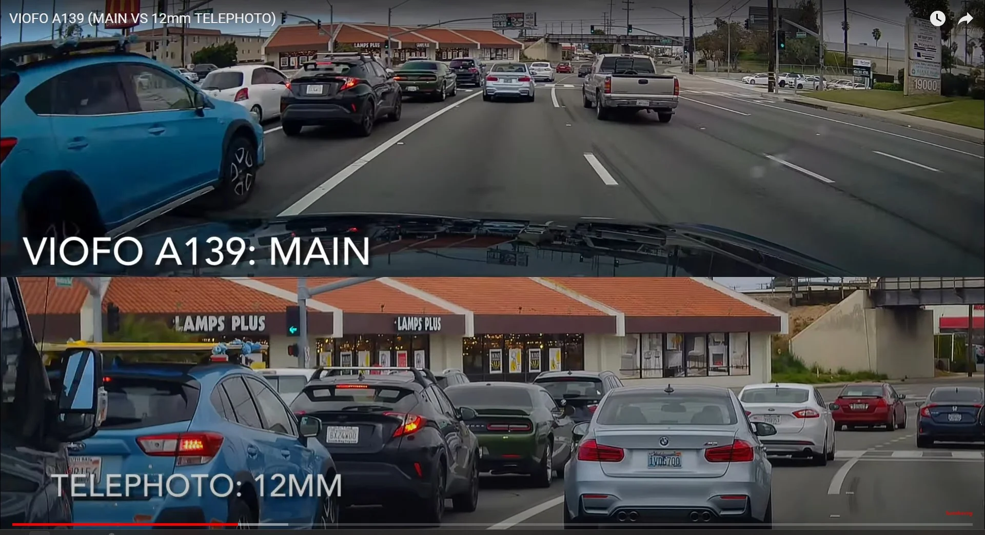

Couple sample images (screenshots of the video footage from my iPad, so quality may not be as good) comparing the standard main camera view and the interior camera w/ 12mm installed.
I personally prefer the 12mm considering how much gap/space I leave when driving behind someone (similar distance to the first photo of the blue car in front on the parking lot).
This gives me the perfect view of the vehicle with the telephoto lens. The 8mm distance was just too short and didn’t have much advantage over the main camera.

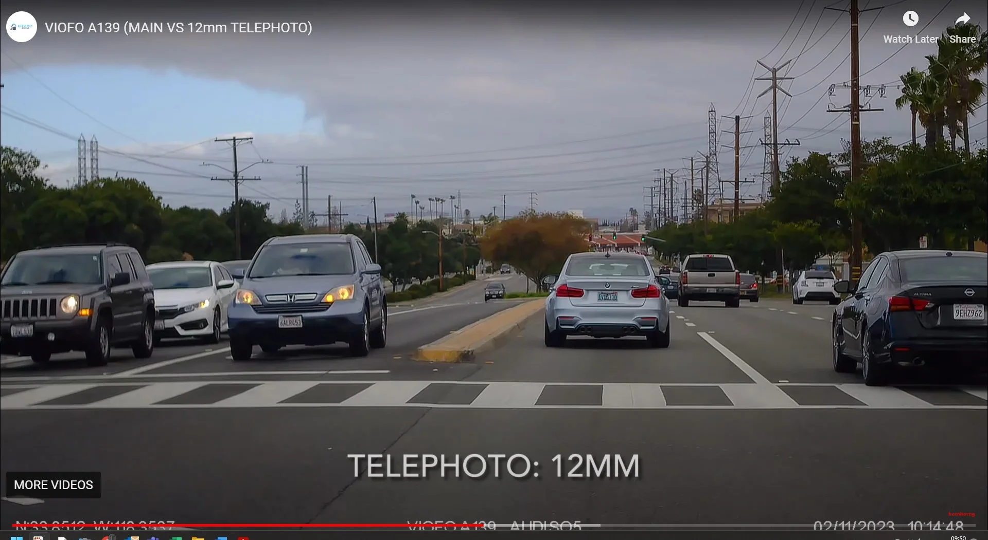

Finally had the chance to capture some daytime videos. Overall, results are great. The depth of field might be too narrow given the aperture of f1.8.
Theres a couple parts of the video. Side by side comparison and identical video in 12mm only full screen so you can see the detailed quality.
Watch it at 4k to get it as close to the real quality due to youtube compression.
I had to reposition the 12mm camera after this video since it’s not centered how I want it to be. Havent tested the new position yet but results should be similar.
The video quality looks good.
Comparing it with the 8mm Telephoto Lens from TonyM I am not sure what I prefer.
Both have their advantages.
The 8mm does capture more of the environment while the 12mm is seeing way ahead.

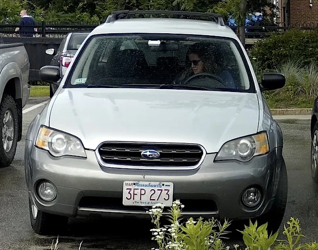

Generally it's looking good. You have better focus on the right than the left side. That's OK for traffic going in your direction, but might struggle with oncoming vehicles on the left side. As you have found, it is often difficult to get everything in focus with these fast telephoto lenses.
I can see why you might want 12mm for those small licence plate characters. Personally I find the FOV is too narrow for anything other than straight roads. On this gentle curve the Silverado is cropped out of the telephoto view. However your 12mm camera can see details that my 8mm did not.
