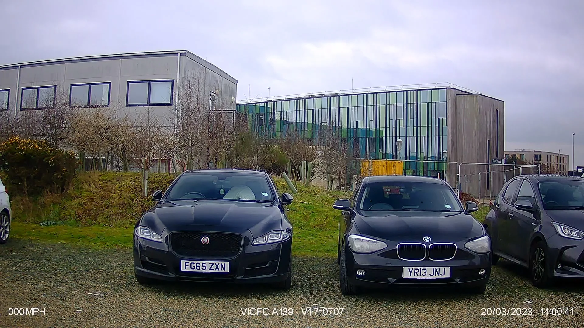

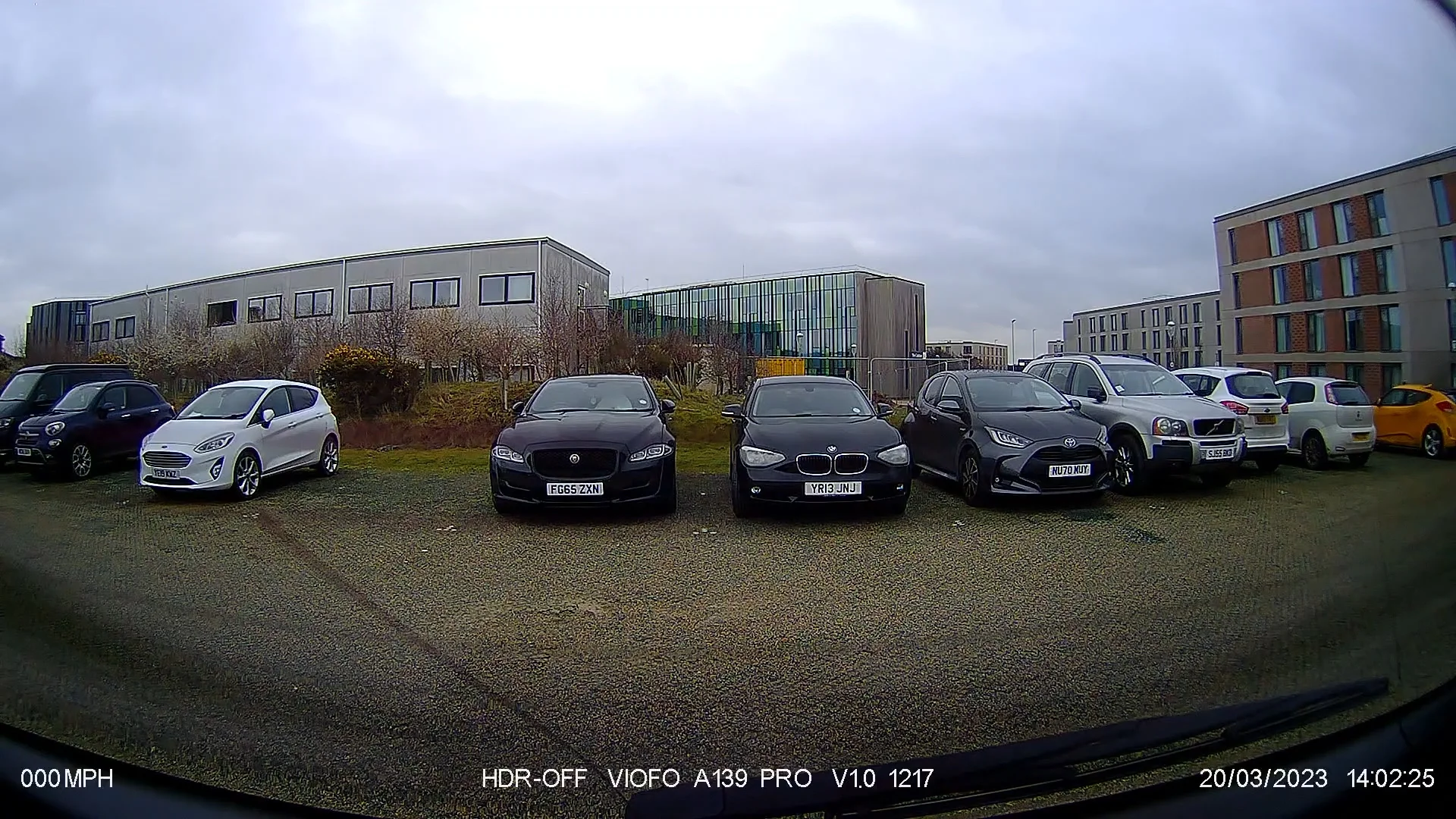

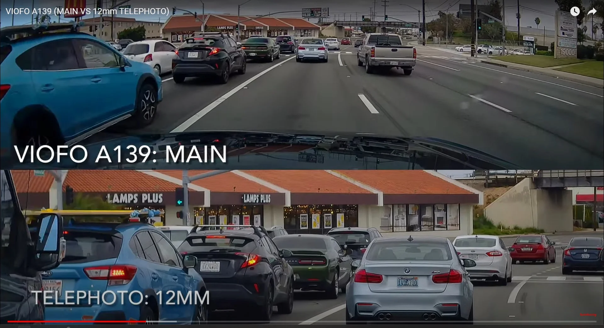

Generally it's looking good. You have better focus on the right than the left side. That's OK for traffic going in your direction, but might struggle with oncoming vehicles on the left side. As you have found, it is often difficult to get everything in focus with these fast telephoto lenses.

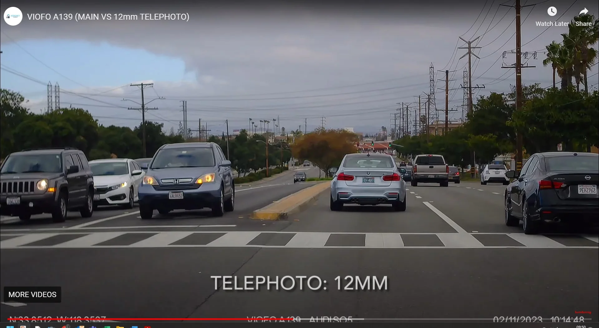

I can see why you might want 12mm for those small licence plate characters. Personally I find the FOV is too narrow for anything other than straight roads. On this gentle curve the Silverado is cropped out of the telephoto view. However your 12mm camera can see details that my 8mm did not.
Yea. I fixed the positioning of the 12mm camera and placed it in a much center position. Now I have a better focus on all sides and is much more centered to the road.
But yes, the FOV is too narrow but it does capture the needed details that the wider lens could not. Both for sure compliment each other.

If you have a main camera + zoom camera pointing at the same direction, then I think the 12mm FOV is perfect as a secondary camera so you can see those details you wouldn’t otherwise see on the main camera.
A 10mm would probably be ideal for the remote camera but I haven’t found any 10mm lens that meets my requirements.

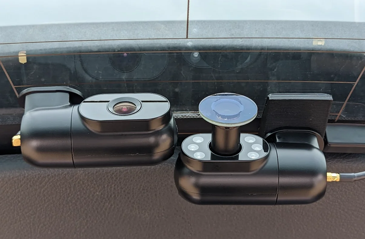

I am fine-tuning my wide and telephoto camera setups. For my rear view I now have 2No A139 remote cameras:
1x original wide-angle rear camera
1x modified 6mm F1.2 telephoto, with CPL filter
I am using a thin wedge as a spacer under the telephoto camera so that the CPL does not hit the window.
The wide-angle camera records a good overall view of what is happening behind me, including the lower edge of the screen as a reference point. The telephoto with CPL has a magnified view of the cars directly behind me, and can see through reflections on the windscreen.

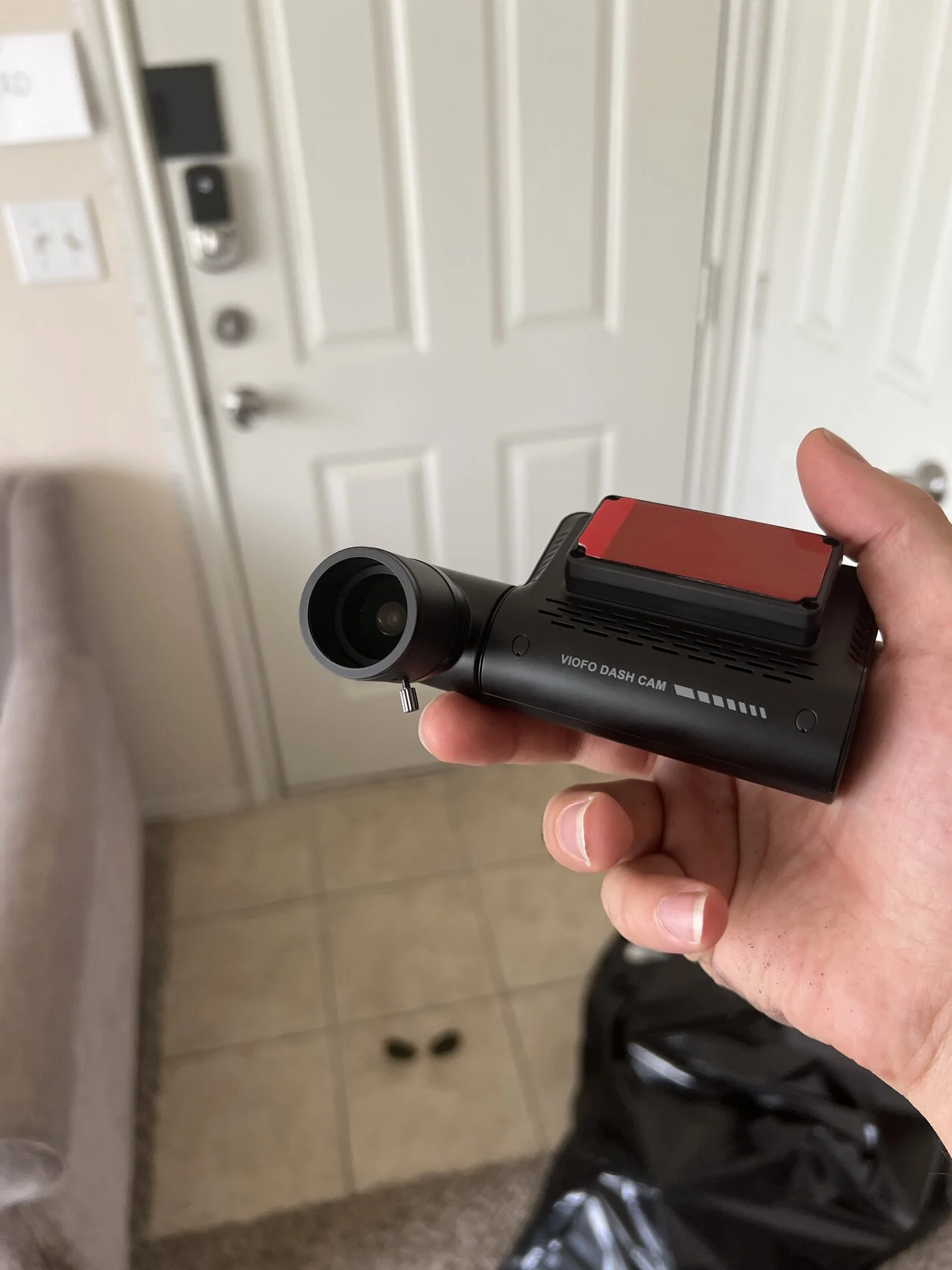

I’m using a 12mm lens.
Here’s the link: https://a.aliexpress.com/_mt5Ta7G

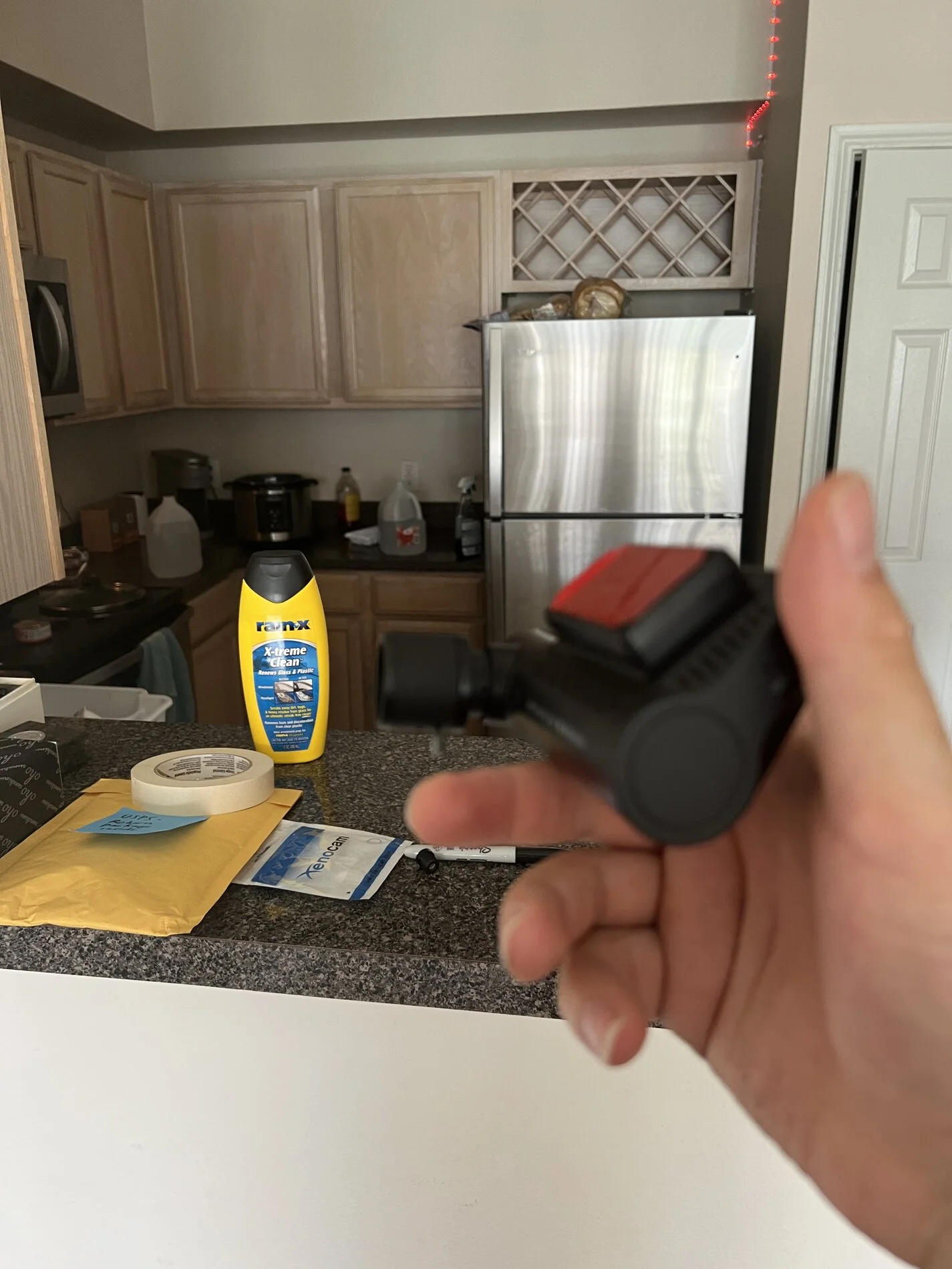

I too ordered the same lens. Came in yesterday and I started to experiment with what would be the original rear camera. Had the lens installed (first time I am doing this) with little problem. I do, however, would like your insight on focusing the lens. I think I got it to a point where it is pretty alright (I aimed it across the street at a neighbor's house and trees), but I am not sure if this is the right way of doing this. Is there a certain distance I should focus it on? Is there a minimum distance, or a distance which is too far away?
I am asking as your picture results look pretty stunning, but when I looked at the live-feed on my iPad it all seemed a bit grainy and not nearly as sexy and sharp as the pictures you posted.
On another note, are you using some sort of bracket or stand-off to mount your camera? Or are the pictures tricking me and it is mounted directly to the windshield as it normally would pre-modification?
Thank you for any insights you can share!
The live view is not the full quality of the camera. You would have to download the video to your device to see the full quality.
Some people have used wedges to gain enough clearance.
