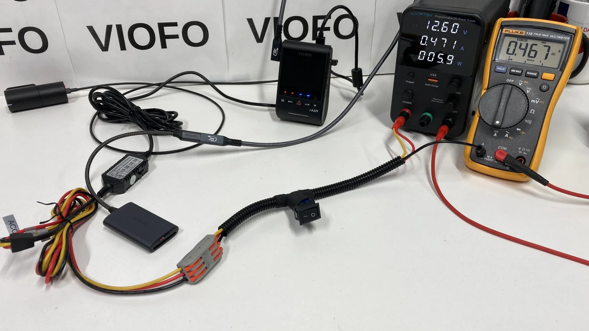

First I need to run a baseline test with the SD card in the A329 as normal.
Then I’ll remove the SD card from the camera, and insert it into the card reader.
I’ve also got the camera connected to my power supply set at 12.60V, and my Fluke 115 in-line for more accurate power consumption measurements.

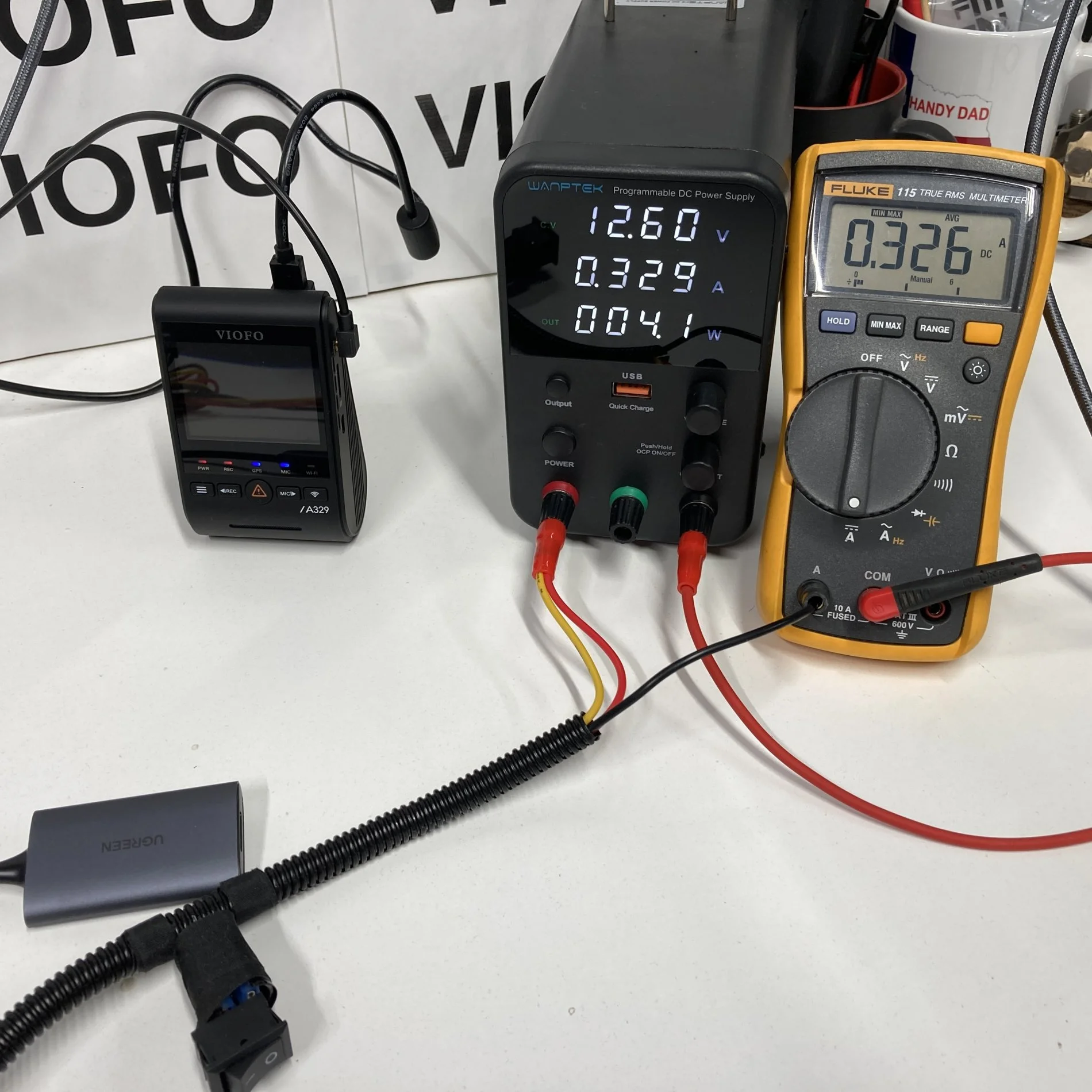

Heat Test & Power Consumption (Internal vs. External SD Card)
INTERNAL SD CARD - 64GB Viofo Brand
Firmware: V1.0 20241009
Low Bitrate Parking Mode
HDR: All Channels Off
Garage Temperature: 60℉ (15℃)
104℉ (40℃) Front
121℉ (49℃) Right
120℉ (49℃) Left
4.11 Watts = 326mA x 12.6V

85℉ (29℃) EXTERNAL SD CARD IN READER
4.11 Watts ÷ 96Wh Battery Pack = 23.4 Hours Recording Time
4.54 Watts ÷ 96Wh Battery Pack = 21.2 Hours Recording Time (2.2 Hours Less)

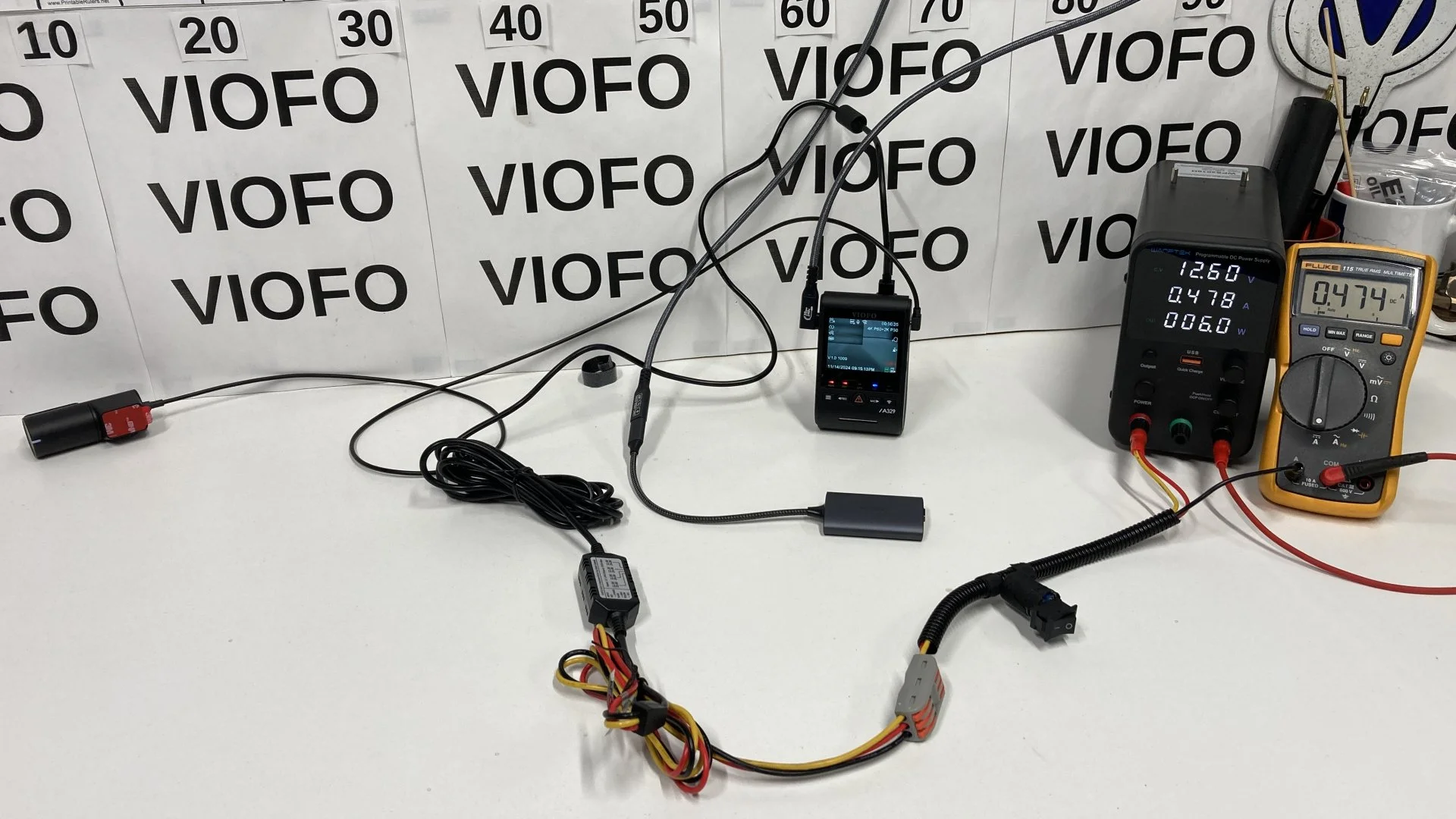

So far, based on the LBR test results, I see the following:
  • The SD reader and 2m extension cable work, (I wasn't sure since it's not a Viofo brand), still need to verify 4K 60fps performance.
  • With the SD card remotely mounted, the camera temperature is slightly lower than the baseline, by about 0°, 2°, and 7°C depending on the location, not as much as I was hoping for, but still something; However the SD Card temperature is much lower, by about 20°C, this will definitely minimize any failure due to SD Card overheating.
  • With the SD Card remotely mounted, the LBR power consumption is 4.54W or about 0.43W higher, than the baseline, but about 0.96W lower than the 5.5W for SSD, as tested by @safedrivesolutions and about 2.04W lower than 6.58W for SSD as tested by @rcg530 (17.5% and 31% more parking time respectively)

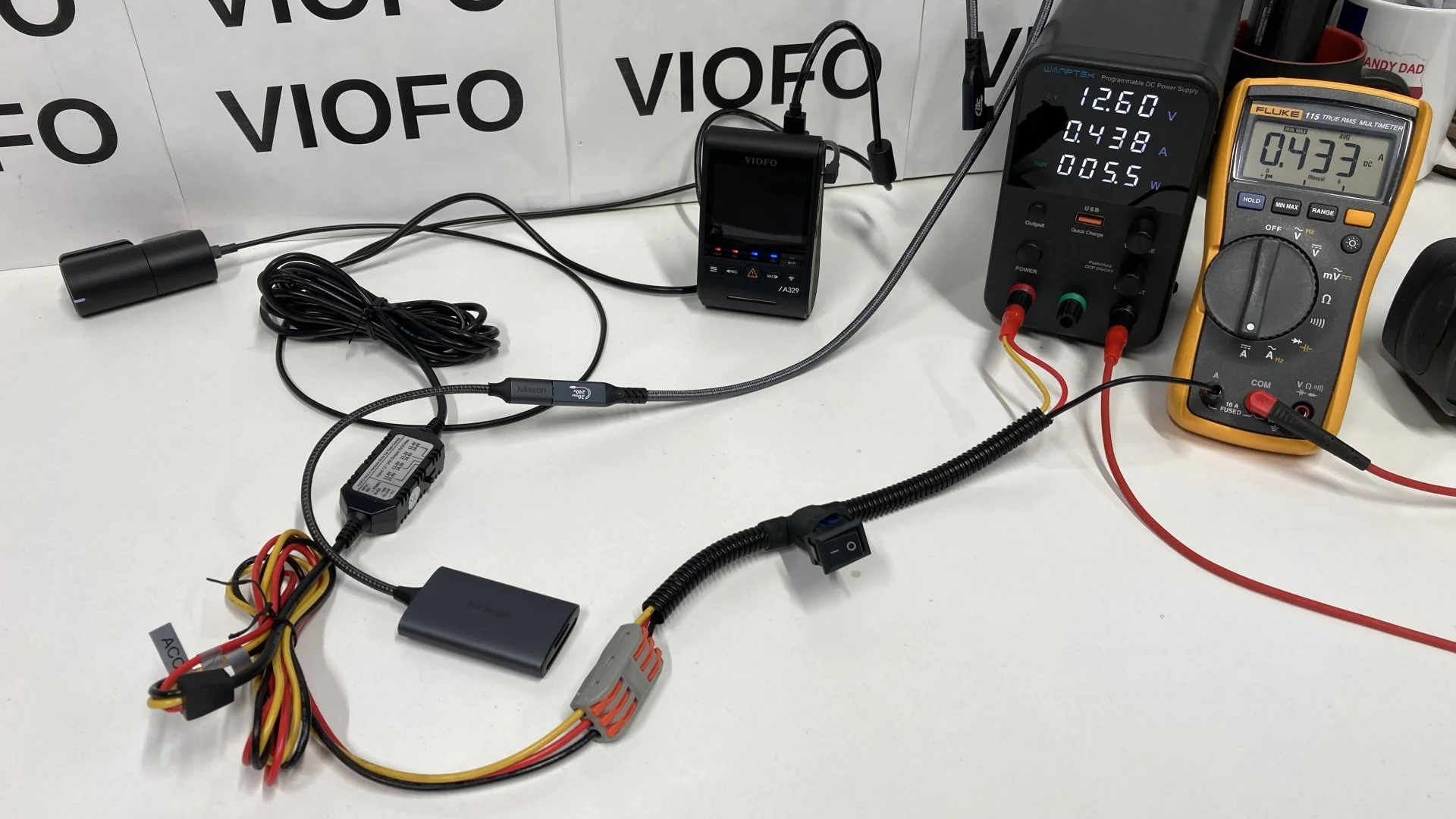

@GPak I just set up for the 4K60fps Heat & Power Consumption baseline test.
It’s going to take an hour, or so to get the camera fully warmed up.
Whenever I watch the power fluctuations on my meter I get hypnotized. lol
Heat Test & Power Consumption - Normal Recording Mode (Internal vs. External SD Card)
2-CH Rear Configuration
Front: 4K60fps
Rear: 2K30fps
Bitrate: Maximum
1 Min File Size: 472MB + 196MB = 668MB
Garage Temperature: 64℉ (18℃)
119℉ (48℃) Front
141℉ (61℃) Right
138℉ (59℃) Left
5.46 Watts = 433mA x 12.6V
EXTERNAL SD CARD - 64GB Viofo Brand
Front: 4K60fps
Rear: 2K30fps
Bitrate: Maximum
Garage Temperature: 63℉ (17℃)
117℉ (47℃) Front
135℉ (57℃) Right
120℉ (49℃) Left
94℉ (34℃) SD Card Reader
5.88 Watts = 467mA x 12.6V
5.46 Watts ÷ 96Wh Battery Pack = 17.6 Hours Recording Time
5.88 Watts ÷ 96Wh Battery Pack = 16.3 Hours Recording Time (1.3 Hours Less)
