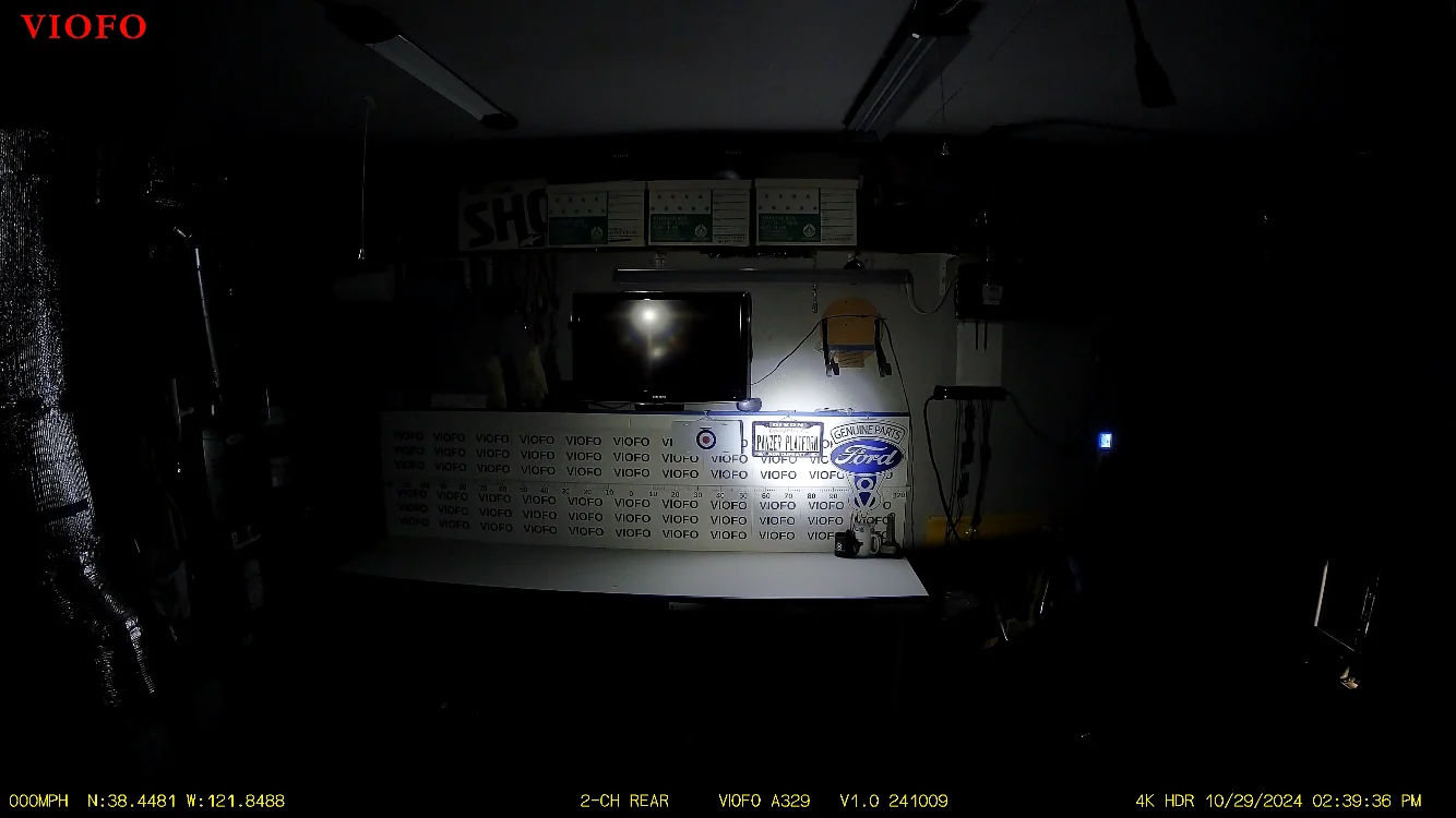

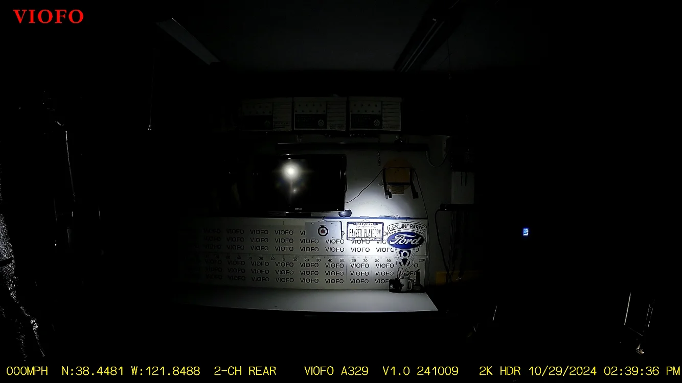

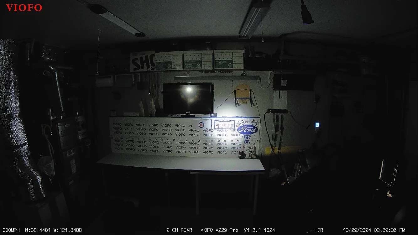

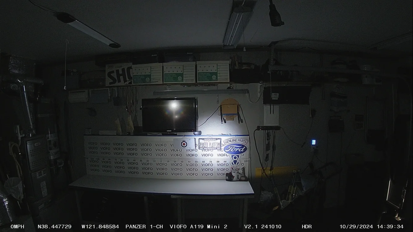

How about some useless stationary testing, (Bill hates this most)? lol
SETTINGS:
ALL CAMERAS HAVE CPL FILTERS EXCEPT A229 PRO REAR
A329 2-CH Rear:
V1.0 20241009
HDR On
Max Bitrate (65 Mbps)
All other setting default
A229 Pro 2-CH Rear
V1.3.1 20241024
HDR On
Max Bitrate (60 Mbps + 26 Mbps)
A119 Mini 2
V2.1_20241010
HDR On
Max Bitrate (30 Mbps)
A329 night time HDR performance is off to a good first start.
Well done, and congrats to Viofo.

Did you have CPL on or off in these clips?
I'm confused. Going by the photos, the older A229 pro is vastly superior to the new A329?
For what reasons do you judge the A229 Pro to be superior?
If you are looking at PP's "night time stationary testing" in his garage, the A229 Pro is seeing far more in the dark areas, and you can judge that seeing more is superior, but it can just mean that it has the exposure wrong. If your aim is to read license plates, then you need the best exposure for that, and being able to see the darkest areas of an enclosed garage lit only by one narrow angle beamed LED torch is not too important. When you are out on a street with street lamps, you are never going to get areas that dark. It is an interesting test, but doesn't match most people's real life, so look at the readability of the illuminated area, not the darkest parts, especially the bit in the main beam, since that will replicate what does happen when you are behind another vehicle and have your headlamps on, directly illuminating their reflective licence plates.

Judging by the images, if we adjust the a329 exposure setting in the + direction and the a229 pro exposure setting in the - direction, they may be equivalent to each other.
Frankly, looking at the two pictures, it is better that the a229 pro is brighter in terms of peripheral vision. because the peripheral vision is set darker to capture the a329 license plate.
The license plate part should be like A329 and the peripheral vision should be like A229 Pro.
In short, a good balancing is required.
Every since 2018 I never changed the EV setting for testing, and comparing cameras.
I always leave the EV default at 0.
When the exposure setting is 0, the brightness or contrast levels of the two cameras and the image they give should be similar.
For the a329, plate sharpness appears darker at the 0 exposure setting.
On the a229 pro it is slightly lighter at setting 0.
I will have a suggestion for this soon and if it is implemented, everything will be better for the image.
