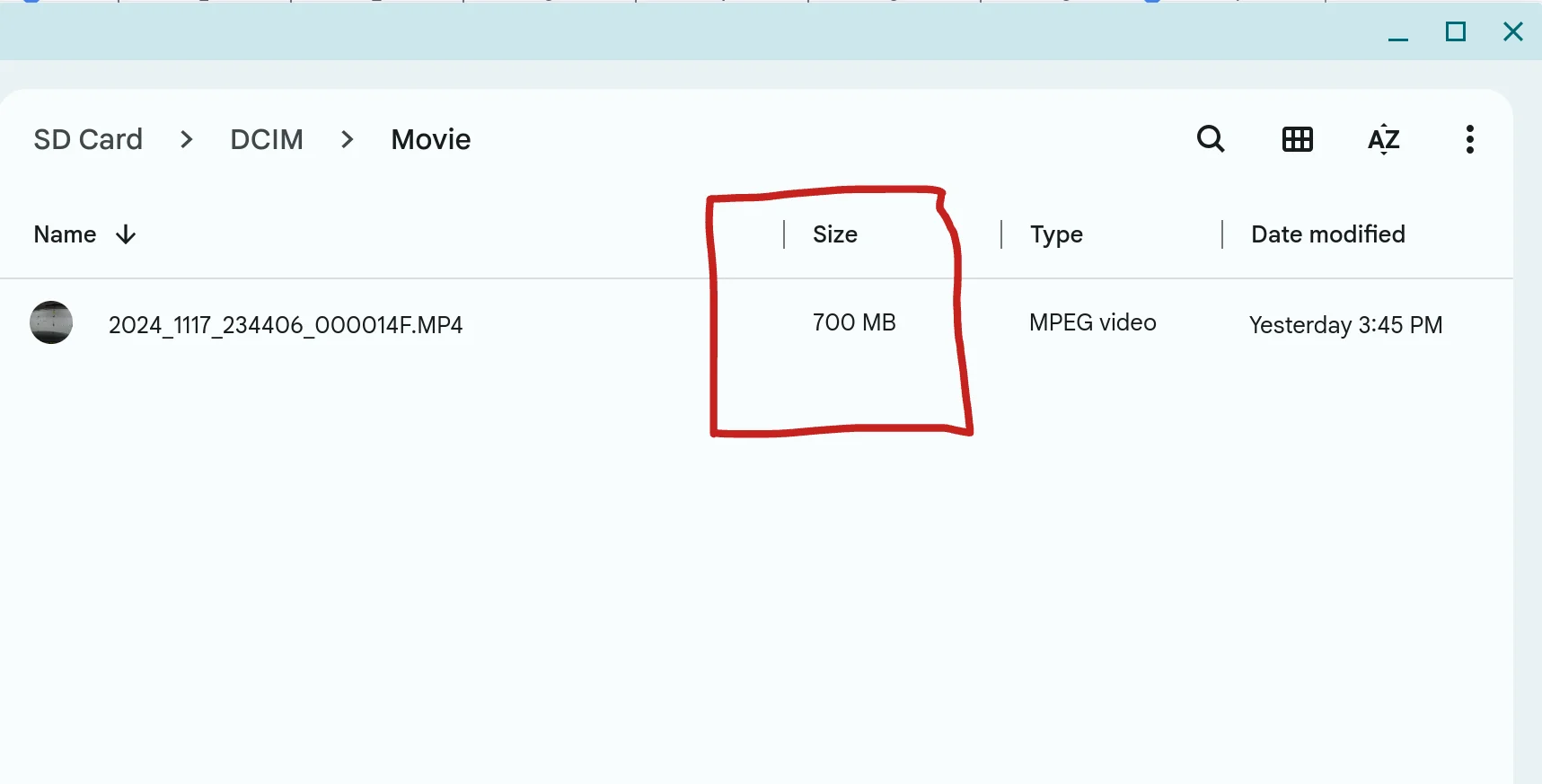

Well that’s interesting.
For as long as I’ve been testing the A329 in every possible configuration it has always recorded a 1 Minute file at 472MB, (approx. 63 Mbps).
I just did a default reset before performing an audio test, and now it’s recording a 1 Minute file at 700MB, (approx. 93 Mbps).
What the heck did I just do?
Btw, I have never updated the firmware.
I’ve been using the firmware that was delivered in the camera V1.0 241009

Have the resolution settings changed?
The Mini 2 has a fixed bitrate when using a resolution of 2560x1080, but not when using a resolution of 2560x1440.
So far I have been using 4K60fps & 4K30fps 16:9.
HDR On / Off
1-CH and 2-CH configuration.
To do the audio test I did a default reset, and selected 4K60fps 1-CH and it provided the 700MB 1 Minute file.
But, I previously used this setting to gather daytime test footage, and it was only 472MB 1 Minute File.
This is 1-CH configuration, even though the STAMP says "2-CH REAR" I did not install the rear camera yet.
Guessing you used the exact same settings like Maximum bitrate and resolution and so on and so forth?
Yes, I always do that.
Except for comparisons of different settings.
I checked my A329 video files all the way back to mid-July 2024 when I first received a prototype A329 to start testing. I did find one instance of 700MB video front video files and that was with firmware v1.0_240716 in a 1-channel configuration, HDR off, 3840x2160 60fps and a 97.4 Mbps bitrate.
A week later with the same firmware, but with HDR off and a 30fps, the front video file size was 472MB with a 65.5 Mbps bitrate.
With firmware v1.0_240913, 3840x2160 30fps, HDR on, 2-channel = front: 472MB and 65.5 Mbps bitrate
With firmware v1.0_241009, 3840x2160 60fps, HDR off, 2-channel = front: 472MB and 65.5 Mbps bitrate
With firmware v1.0_241029, 3840x2160 60fps, HDR off, 2-channel = front: 472MB and 65.5 Mbps bitrate
Thanks for the reply.
It must be a bug that is “unlocked” by a specific settings configuration.
Hopefully it will be “fixed” in the first official public firmware.
According to the following post, the 1Ch mode max bitrate is 97.5 Mbps
Correct.
However, that was pre-production firmware.
It was removed for overheating concerns, and reduced to 65 Mbps in both 1-CH & 2-CH configuration.

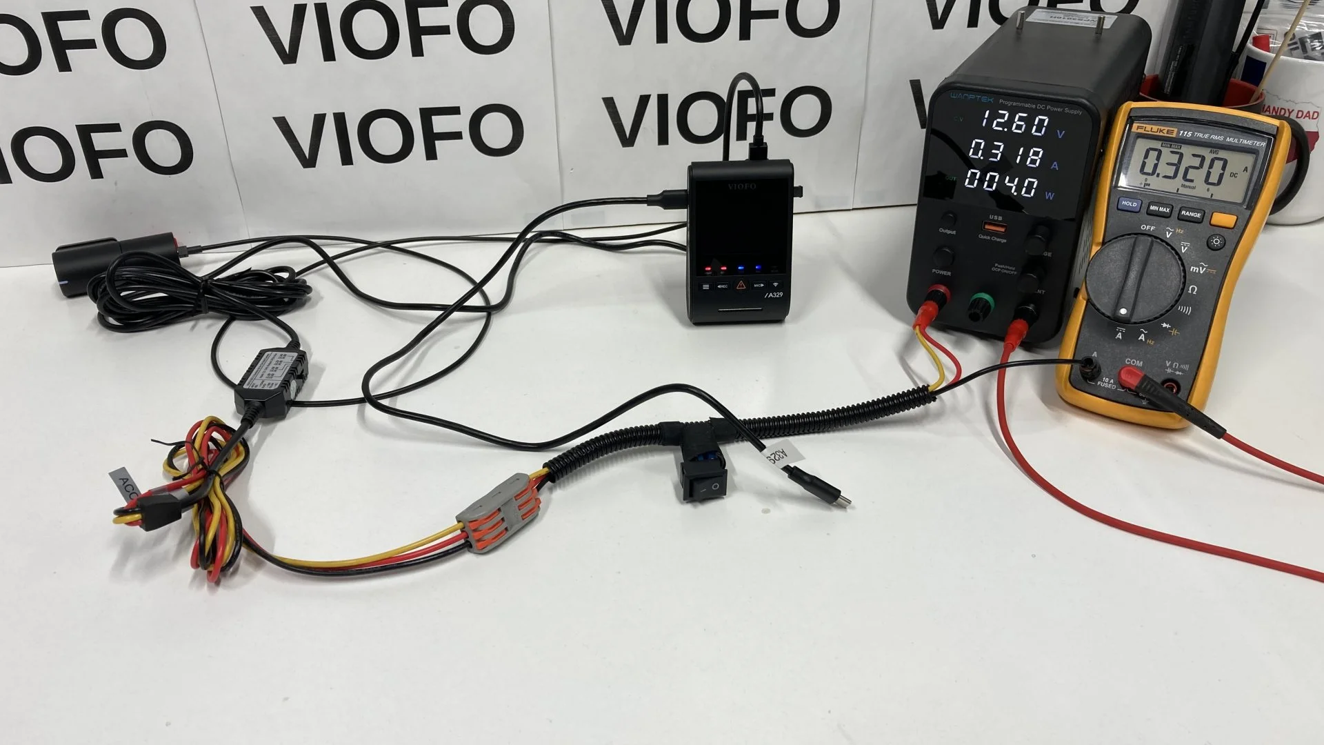

For @Nigel
Heat Test & Power Consumption Comparison (connecting included 50cm Type-C data cable to SSD input)
BASELINE TEST (before)
Internal SD Card - 64GB Viofo Brand
Firmware: V1.0 20241009
Low Bitrate Parking Mode
HDR: All Channels Off
63℉ (17℃) Garage Ambient Temp
106℉ (41℃) Front
121℉ (49℃) Right
120℉ (49℃) Left
3.93 Watts = 312mA x 12.6V

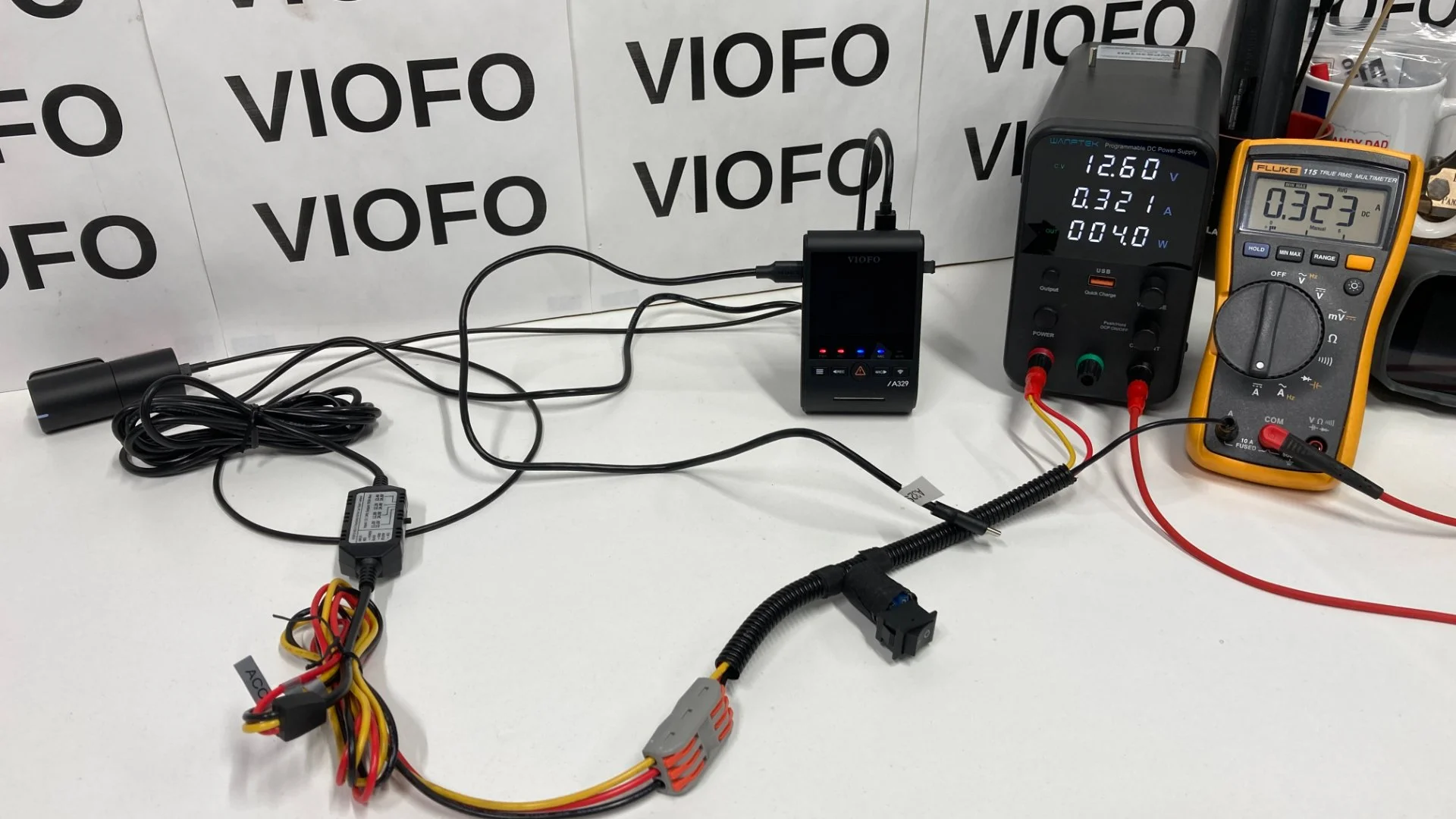

For @Nigel
50cm TYPE-C DATA CABLE CONNECTED (after)
61℉ (16℃) Garage Ambient Temp
103℉ (39℃) Front
117℉ (47℃) Right
108℉ (42℃) Left
4.03 Watts = 320mA x 12.6V
3.93 Watts ÷ 96Wh Battery Pack = 24.4 Hours Recording Time
4.03 Watts ÷ 96Wh Battery Pack = 23.8 Hours Recording Time (0.6 Hours Less)
