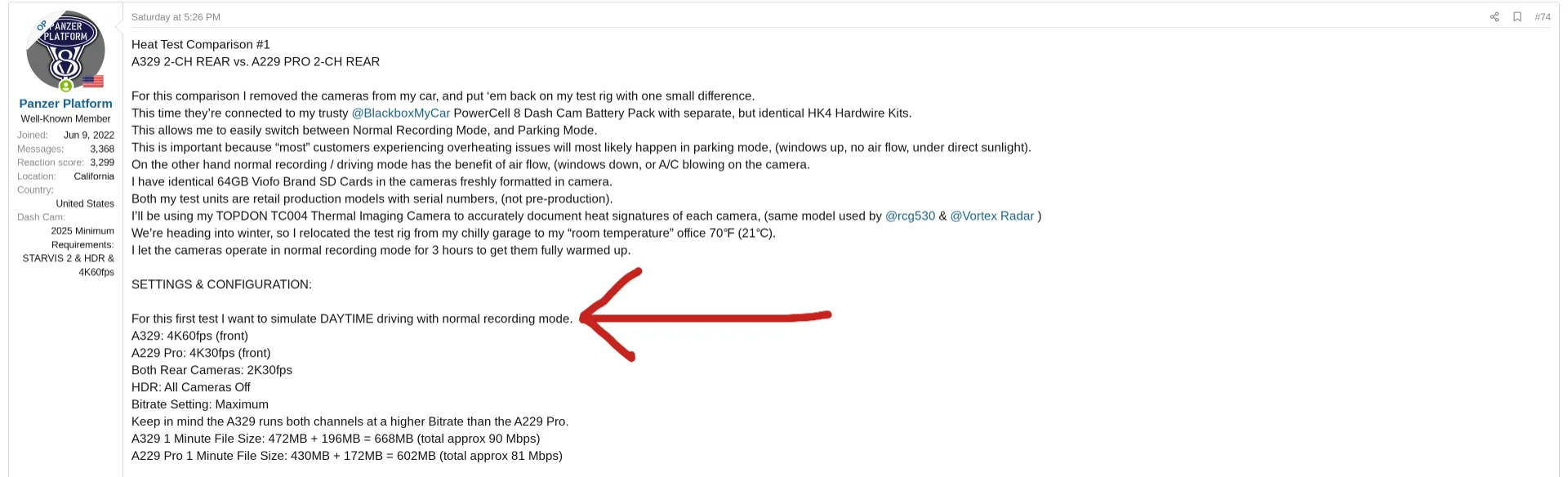

In this test,
You missed the point.
I'm trying to simulate how "most" new customers will use the camera.
DAYTIME: 60fps, HDR OFF all channels
NIGHT TIME: 30fps, HDR ON all channels

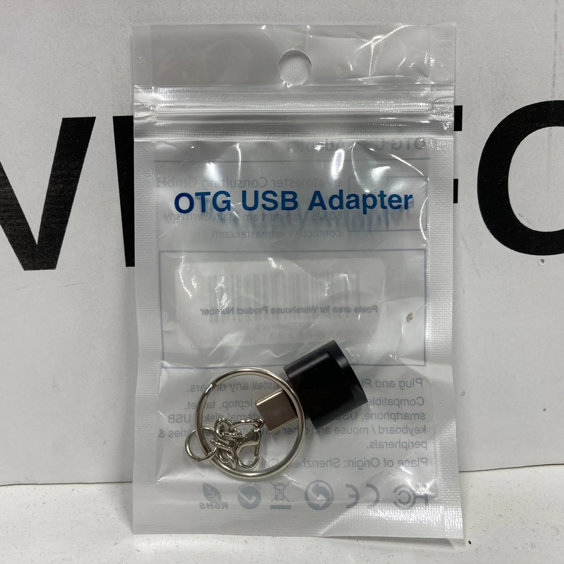

using those types of accessories to keep the card out.
Wouldn't it have a negative impact on the writing speed of the camera?
Taking into account that quite a few writing errors are reported due to not using suitable or writing speed cards, especially if 2 or more channels are used, if this type of accessories lowers the writing speed, writing errors may appear on suitable cards and They didn't give that kind of error.
It is a doubt that arises in my mind.
Some people will buy the A329 because of the 60 fps, others will buy it because it can run cooler, I’m not sure which group is “most”, maybe the cooler group. Currently that group does not know how much cooler it runs, when configured to be cool
So, the test with the USB card reader should be done with the dash cam configured for coolness.

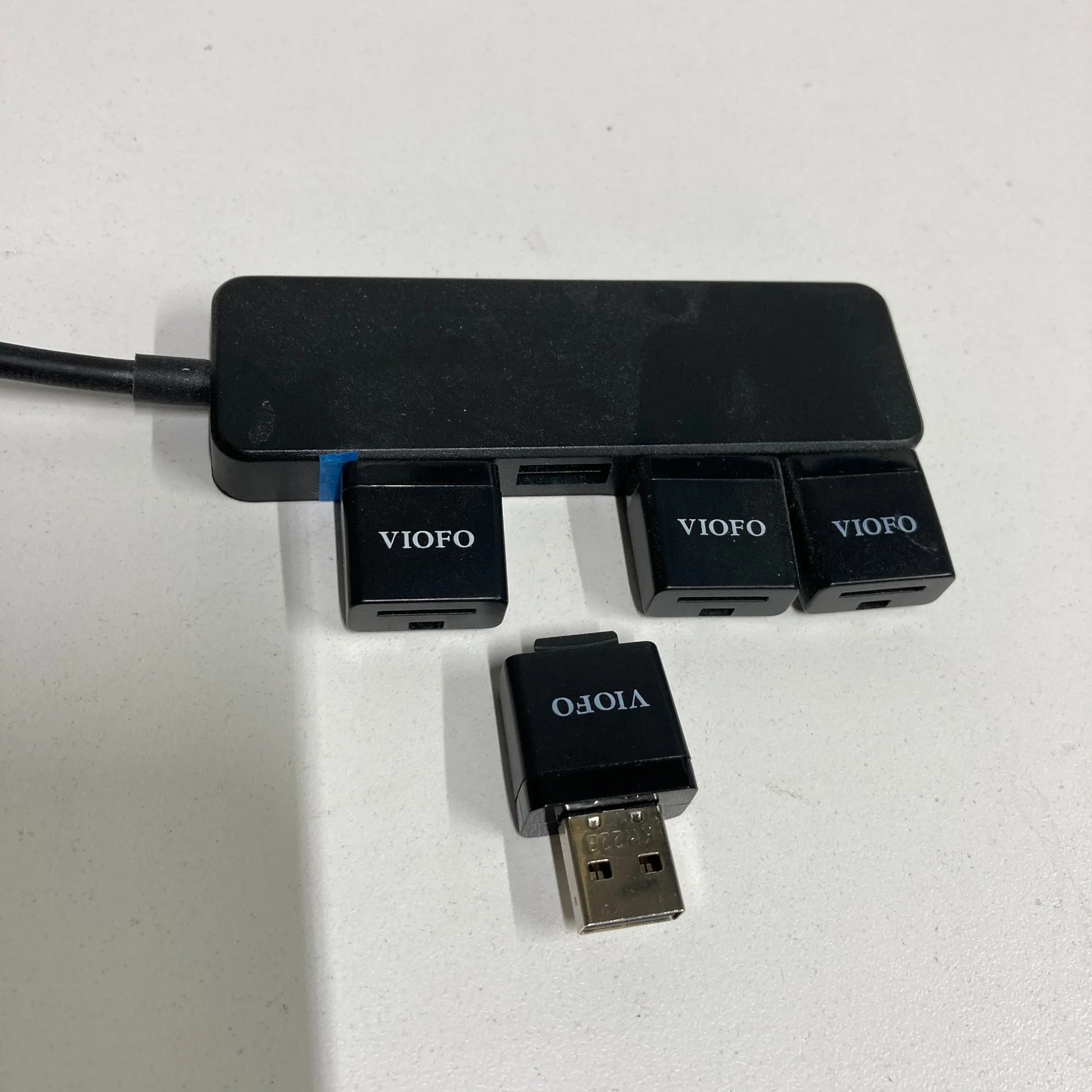

I think the coolest microSD card reader I have is one of the Viofo ones that sometimes come with the cameras. It stays cool because it is not very fast, but the dashcams don't actually write very fast, so maybe that would work?
cheap SD card reader
I was just thinking about that.
When I come back from gathering test footage from multiple dash cams, I use this rig to quickly look at footage from all the cameras, (see attached photo).
It’s very convenient.
Now that we have Type-C SSD on the A329.
I hope @viofo @VIOFO-Support will include Type-C Viofo Brand card readers with every camera, just like they have in the past with Type-A.
C’mon why not? lol
Maybe because it doesn't write at high speeds, then again could just be better constructed. SanDisk thumb drives and card readers, a lot of them run hot, not cos they write fast but cos they're just poorly made lol

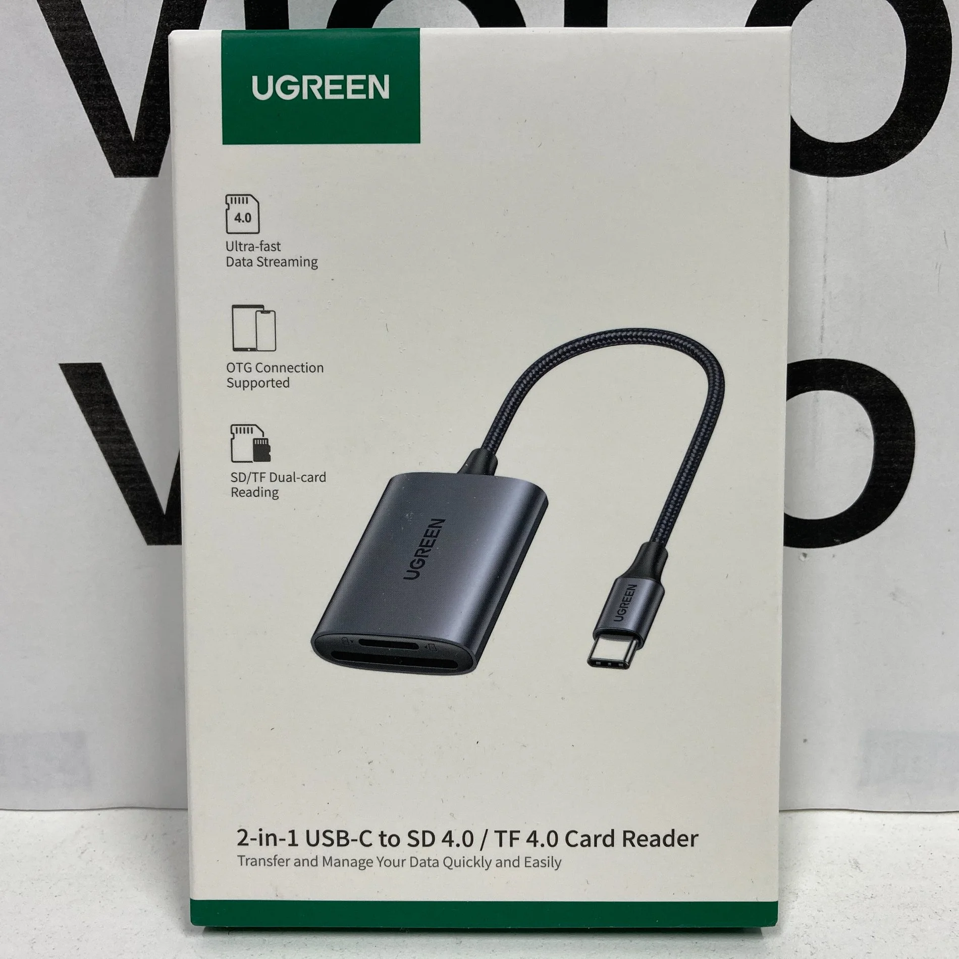

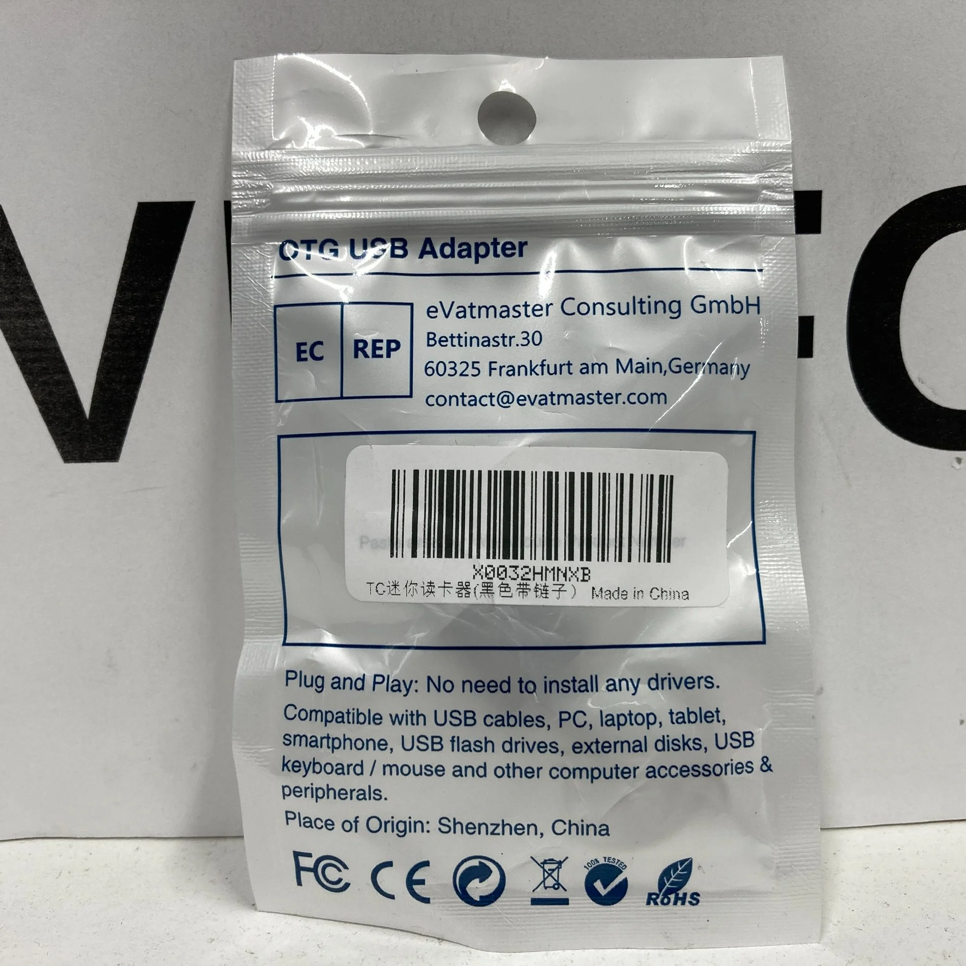

Shoutout to @GPak thank you so much!

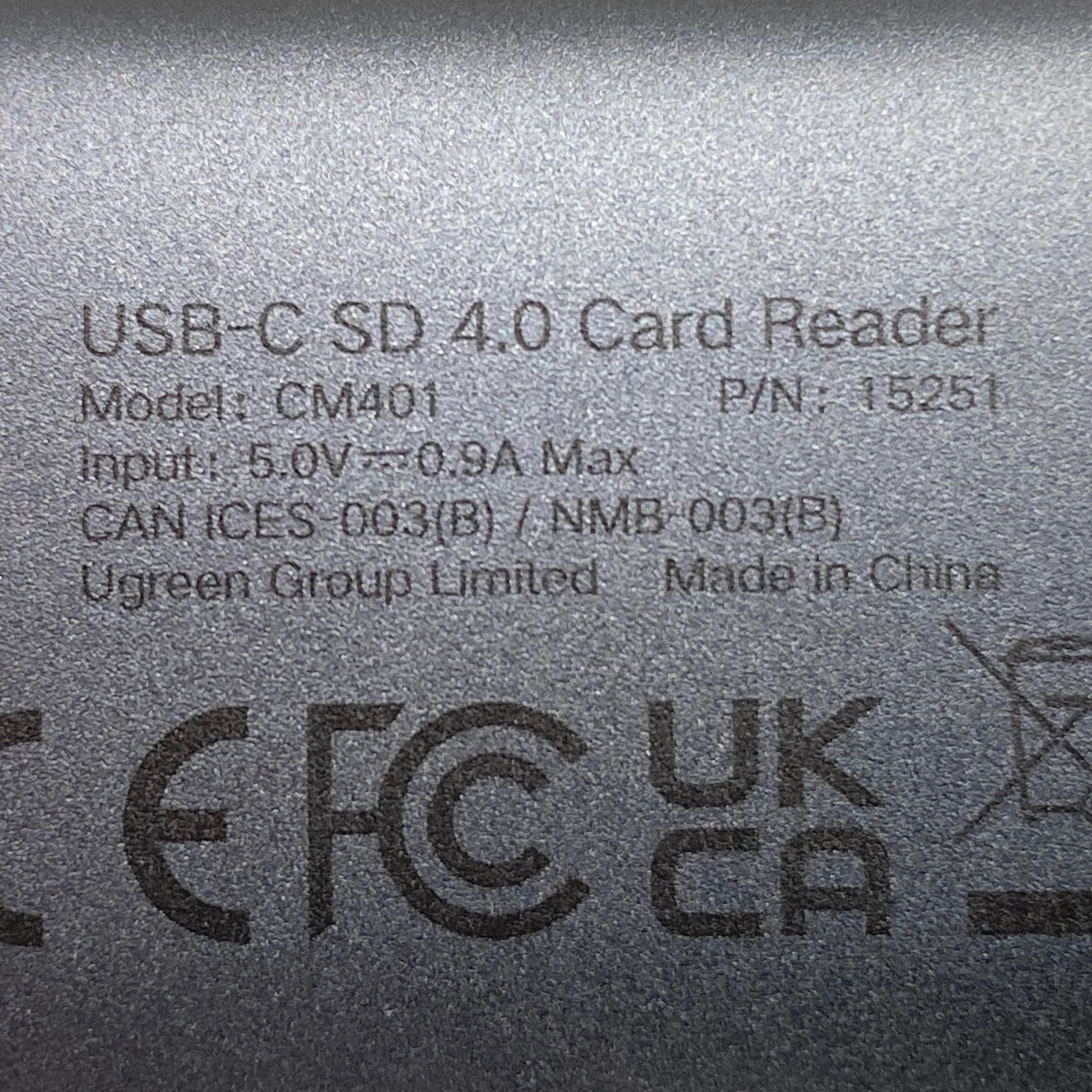

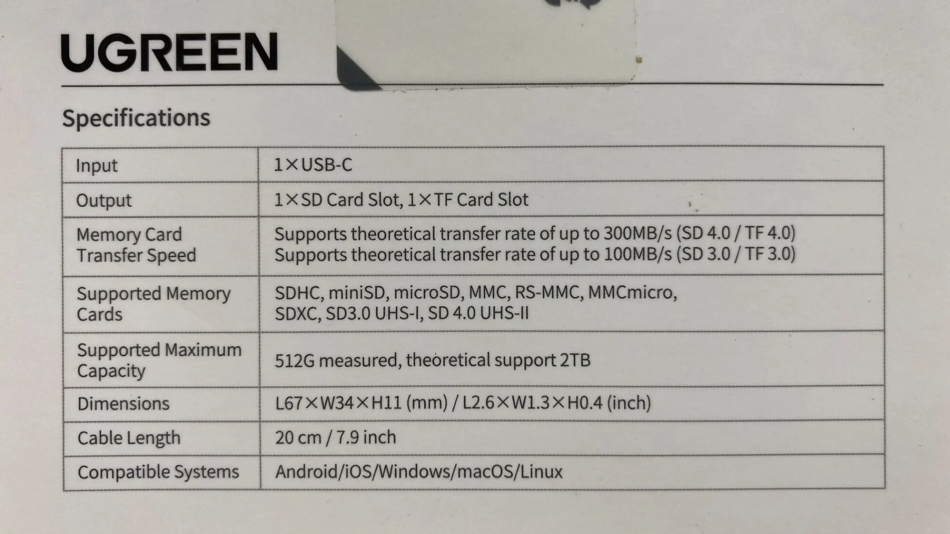

The UGREEN card reader was just delivered;
https://www.amazon.com/gp/B0BNBXVLZS
The 2 Meter Type-C extension cable is scheduled for delivery tomorrow;
https://www.amazon.com/gp/B0D1V76CYB
I also received the $5.50 el cheapo;
https://www.amazon.com/gp/B09L4NDV4X
How do I perform a “speed test” on these card readers to confirm & verify they will be “fast enough” to function properly with the A329?
I plan to use a Viofo Brand 512GB SD Card, (if that makes any difference).

You'd be measuring the card speeds more than anything, theoretical maximum write and read speeds of a product are rarely achieved anyway. If you're getting abnormally low microSD speeds on a decent A2 v30 card like viofo, I'd be suspicious of the card reader first of all
How fast they are depends on what they are plugged into, and on what card is plugged into them, but the only speed that matters is if they are fast enough to work with the A329, so I suggest that you just try them out and see if they record reliably. How fast they are when plugged into a high spec gaming PC is not relevant. How fast they are when plugged into an iPhone might be of interest to some, but that is not what this test is about, and I don't think your iPhone is USB-C anyway.
I think what we are interested in is:
  • How much cooler does the camera run when using an external card reader, compared to internal, and external SSD.
  • Same for power consumption.
  • Are they reliable.
  • Do they work on the end of a 2 meter extension cable, so that you can hide them from thieves somewhere cool near the floor rather than in the heat near the roof, or lock them in the glove box.
