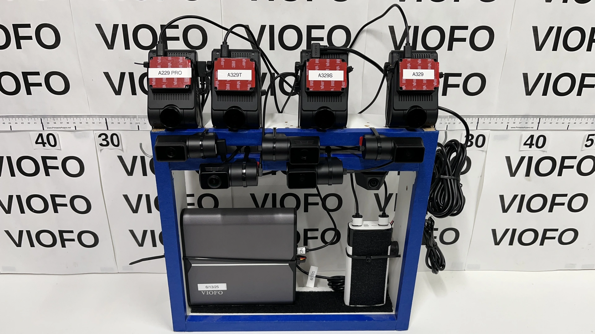

What is the big grey battery pack looking block in bottom left of your test rig?
It has Viofo logo on it. I didn't think Viofo do their own battery packs?
(Just curious)
Apologies for veering a bit off topic, but curious--what is the capacity of the primary and secondary Viofo battery? Are they essentially aligned with the other existing 7500mah options (Blackvue, Powercell, 70mai and Thinkware)? Are there any compelling features that differentiates them from the other options or perhaps features specific to when powering Viofo cams?
(Just curious)
We got a sneak peak at SEMA 2024.
I would love to talk your guys' ears off about it but, unfortunately all test data & specifics is confidential.
No official release date but "very soon".
Yes, and yes.

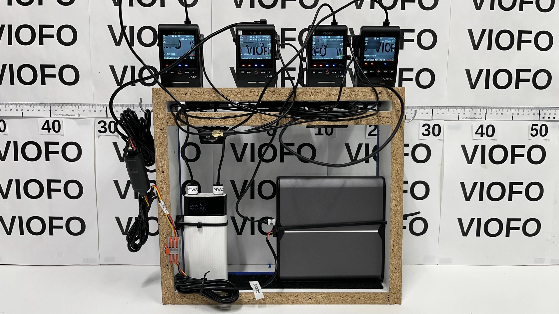

For this heat comparison I set up two “identical” A329S 3CH cameras as close as I could, (what I mean by that);
A329S 3CH (Rear & IR Interior Fisheye) with HK6
A329TW 3CH (Telephoto & Waterproof Rear) with HK4
Both cameras have default settings except;
A329S = LPID
A329TW = LBR
Both cameras have 512GB Viofo Brand SD Cards.
Both powered by “identical” power supplies.
I’ve only got one Fluke Meter, so I’m using my UNI-T 210E Pro Amp Clamp as a “better than nothing”.
We can see LPID when powered by HK6 fluctuates between 39mA - 40mA.
LBR on the other hand is the neighborhood of 430mA.
(LBR) 12.6V x 430mA = 5.4 Watts
(LPID) 12.6V x 40mA = 0.5 Watts
