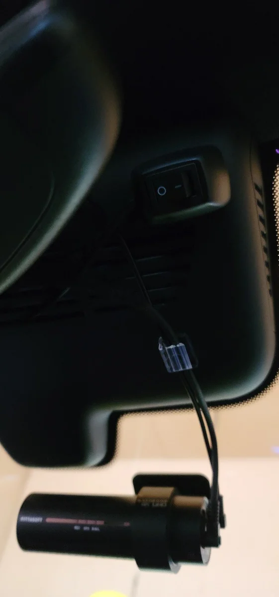

For the DR900X Plus, I found a switch on Amazon.
https://www.amazon.com/gp/B08DXZ84KG
For DR750-2CH all parts from Aliexpress.
The switch
The adapters
