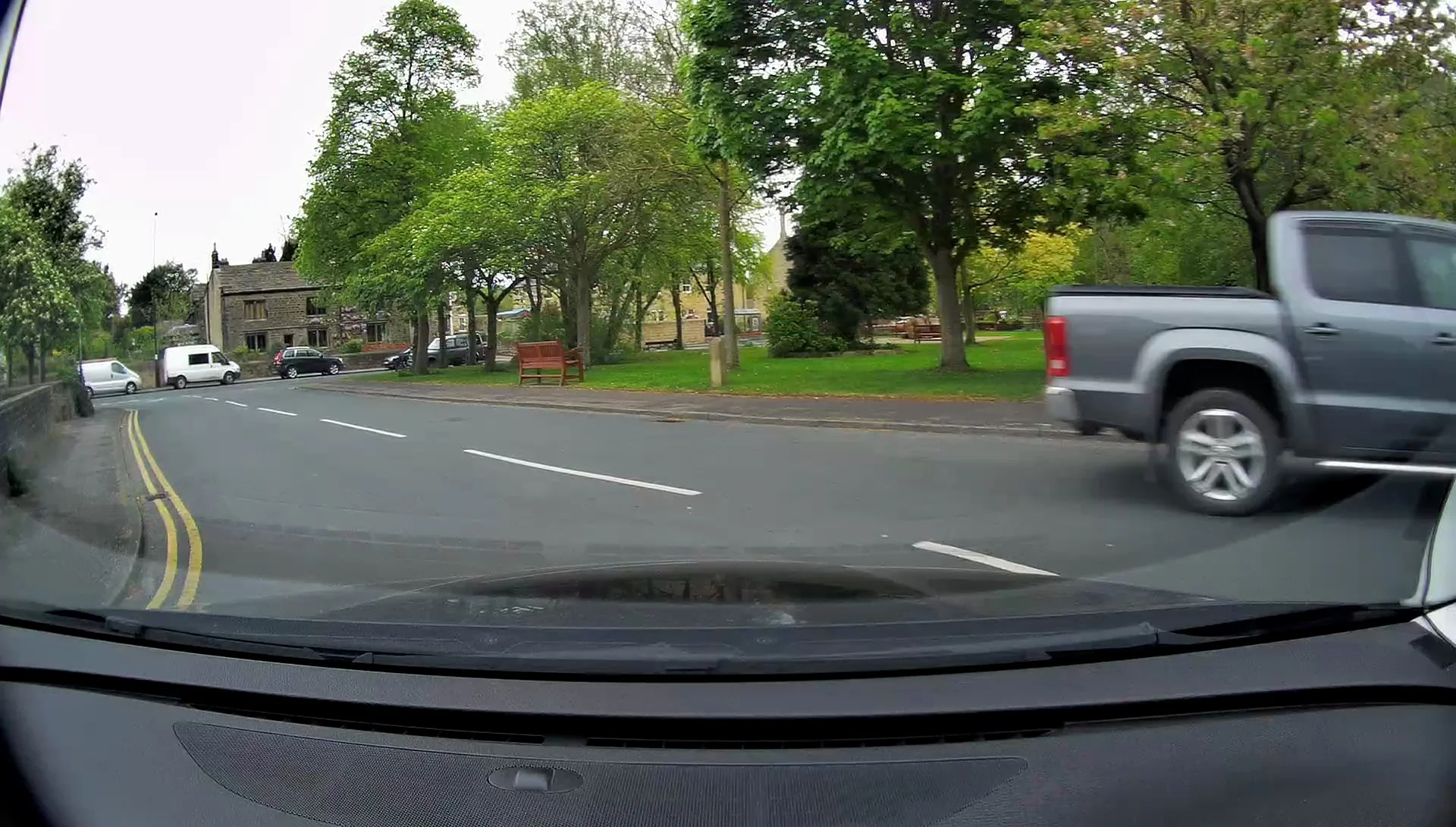

I've just checked the daytime footage with the CPL and with the original generic 0806 CPL we had from MEG for the 0806 testing I do see vignetting like @Nigel at the top left, bottom left and bottom right.
It does sound like they've changed it as you can see there are no vignetting issues in @Viking's screenshots
