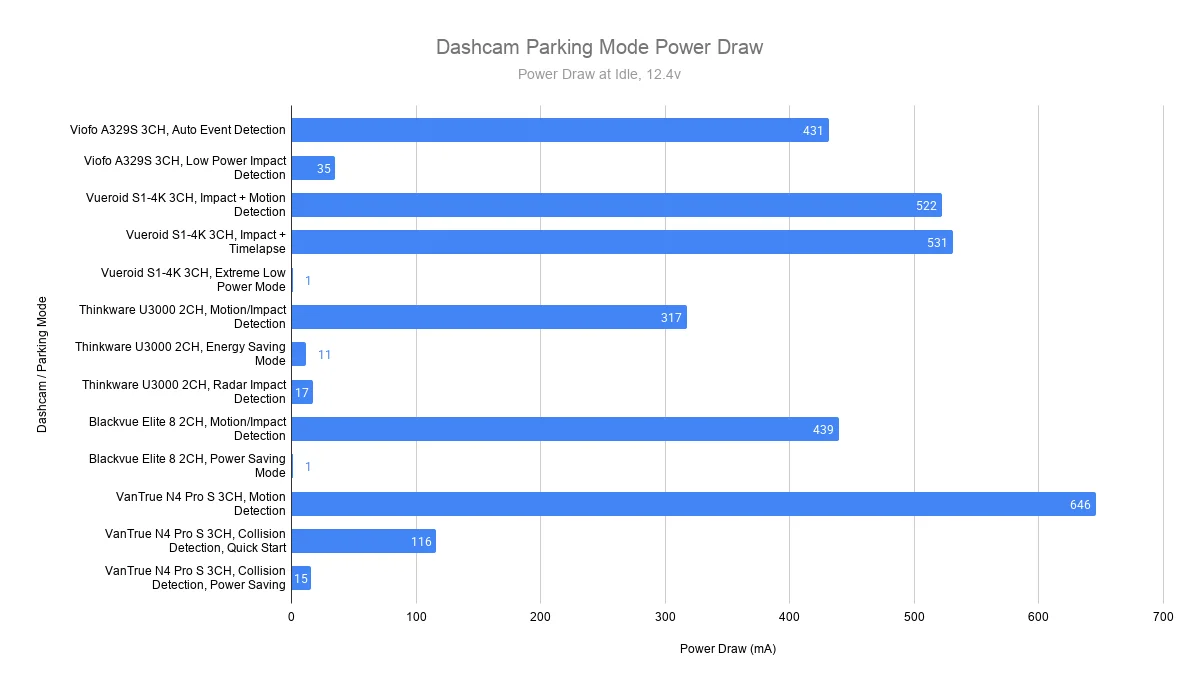

I'd say using a low FPS would be better than impact detection, but that's me. I'm not sure how much voltage a 1, 5, or 15 FPS on vantrue uses or whatever settings are available on Viofo. Op is is Arizona which is hotter than hell. So that's another consideration, too.
Timelapse mode does traditionally draw a little less power than regular video recording modes, but the results are negligible. I'm sure @rcg530 has some great charts he could share the differences in power draw between all the different modes, but here's a quick chart I've got archived showing the differences between traditional parking modes and low power parking modes.

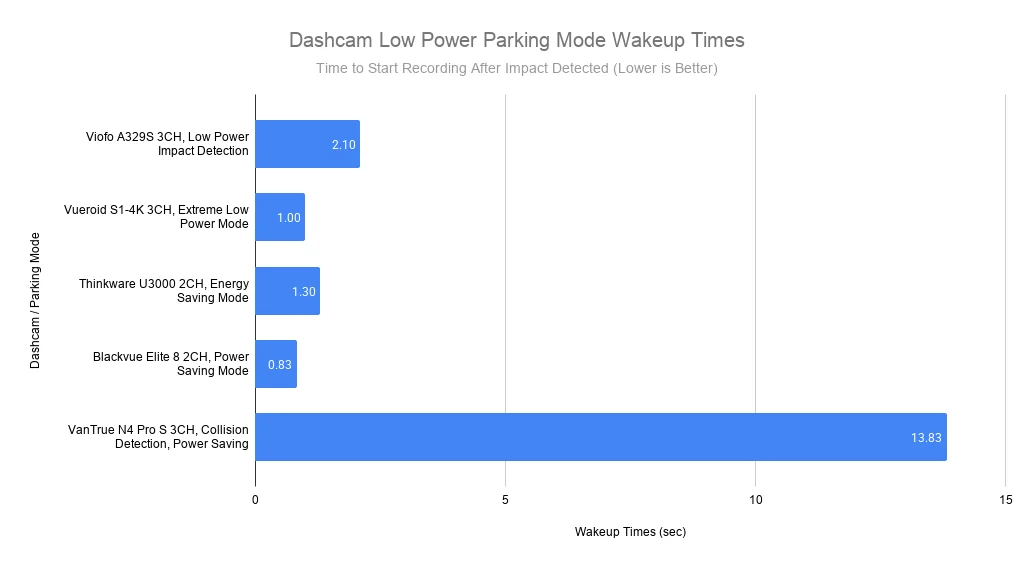

Right, it's in a sleep mode where most everything is powered off except the G-sensor. When an impact is detected, it wakes up to begin recording, then powers back down. Because of this, there is no buffered capability. Thinkware's radar allows it to wake the dashcam up while it low power mode to record motion and sometimes before an impact is detected. It draws more power than non-radar mode, but still far less than traditional parking recording mode.
Wake up times vary between models.
Here's a video so you can see the wakeup times for yourself.

Alternatively you can just go to his testing threads and look at where he's already posted that exact information.
A329S 3CH, IR LEDs off:
Auto Event Detection (regular buffered motion / impact detection): 5.73 W
Timelapse: 5.46 W
Low Power Impact Detection: 0.43 W
So like I said, timelapse recording mode is technically a little more efficient, but the results are pretty negligible and thus wouldn't solve the OP's problem. Low power parking mode is an order of magnitude better.
