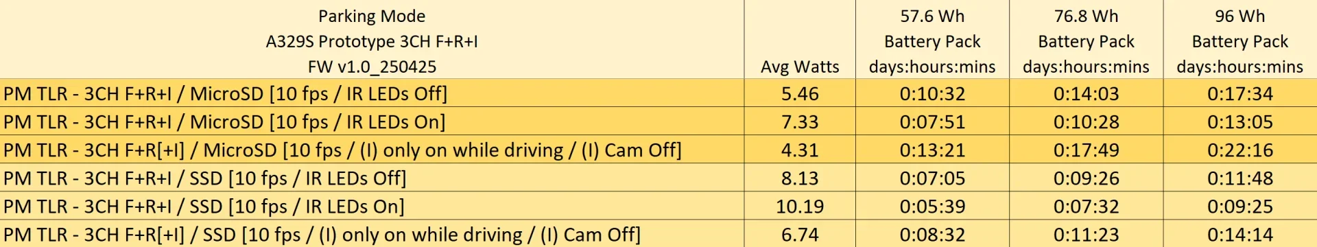

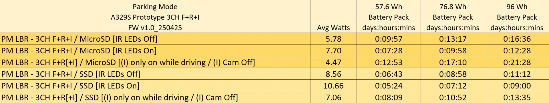

Doing some quick back of the napkin math on a 96 Wh battery based off of RCG's numbers, that would give somewhere between just 2-3 hours of parking record time in a traditional parking recording mode.

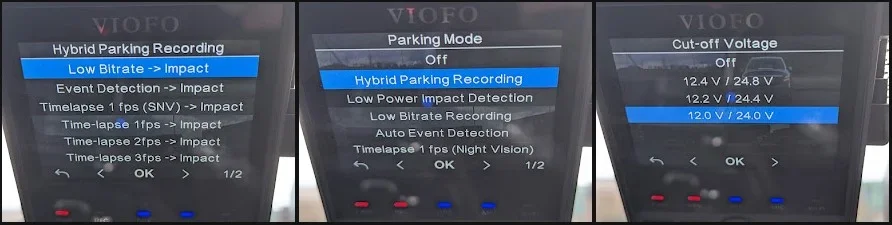

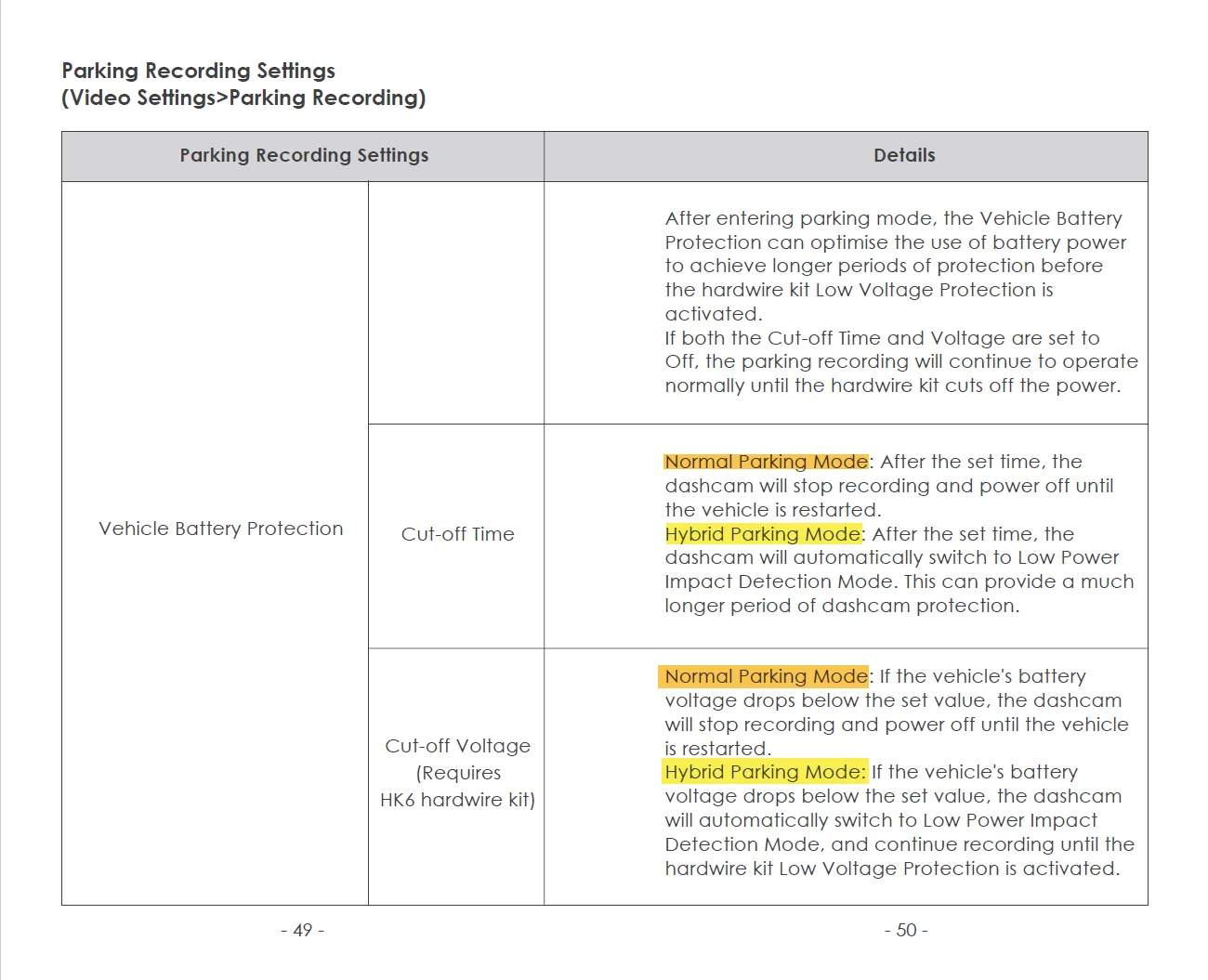

Can you please elaborate, as I don't understand what you wrote. Viofo uses the HK6 that gives the ability to monitor voltage and set a software based cutoff or hardware based cutoff (via hardwire kit). I'm not sure if the two are independent of each other or if the hardwire kit itself overrides the software setting on camera.
I presume the Vueroid uses a hardwire kit, too. Does their kit not have a voltage cutoff? Is their camera regulated by a software setting?

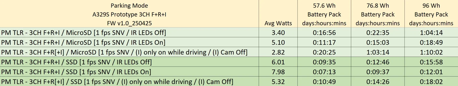

I'm going to use my dash camera battery pack projected parking mode time estimates with a 96 Wh battery pack.
My time estimates are based on a simplifying assumption that 100% of the dash camera battery pack's stored capacity is available for use. If the dash camera's hardwire kit has its own low voltage protection feature, the hardwire kit's low voltage protection feature will almost always turn off power to the dash camera before the dash camera battery pack would have turned its DC output power to the dash camera/kit. You might be able to get 85% to 90% of the estimated time based on those restrictions.
A329S consuming 30 mA in LPID: 10 days 12 hours 37 minutes
A329S consuming 35 mA in LPID: 9 days 2 hours 10 minutes
A329S consuming 43 mA in LPID: 7 days 9 hours 46 minutes
Other dash camera consuming 1 mA in its low power impact detection mode: 400 days [in theory]
