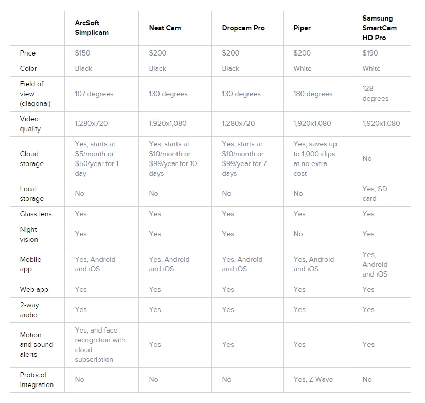

A bit of a random one but this shows how aggressive Xioami are on pricing of these things.
The Yi is $30, has local storage via microSD, night vision with IR, a mobile app (but no web app I've seen although there may be a Chinese one), 2 way audio and motion alerts through to the camera app. It's 1280x720p - the quality probably isn't as good as some in the above table but again this is $30!

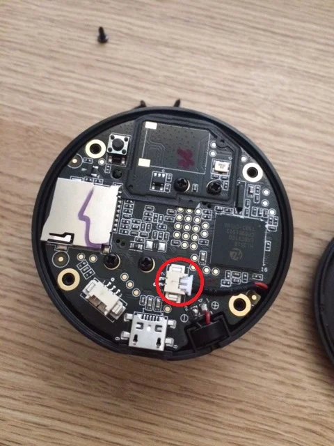

For the IR I'm currently running it behind a window - turns out it's really easy to just drop the four screws off the back panel and then disconnect the IR lights from the system board so I've done that for now to see how it goes tonight 🙂
Here's the IR connector circled:

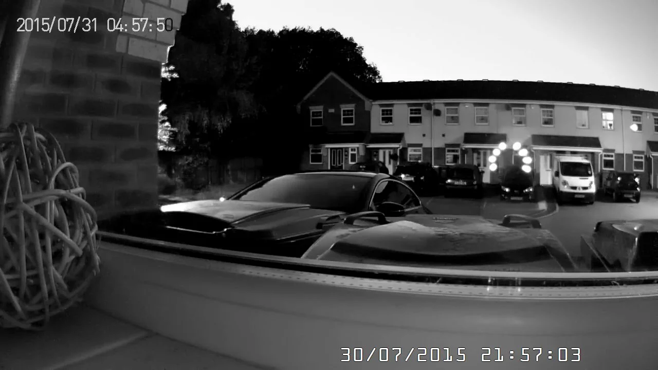

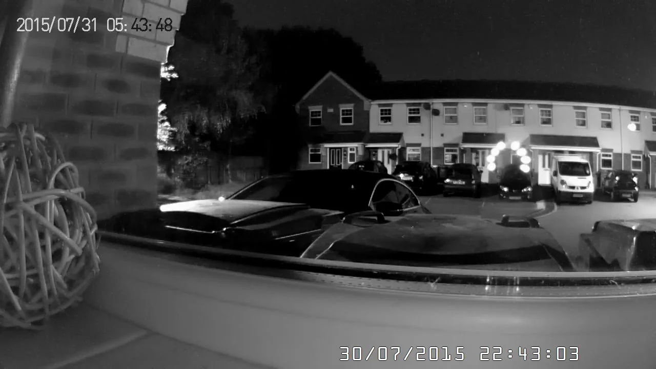

I've just checked out the view from this camera since I disconnected the IR connector and it looks very good indeed - although there are still some low powered IR lights reflecting back that you can see:
And now it's even darker it looks pretty much the same - this OmniVision OV9712 is a very nice night performer without IR!
