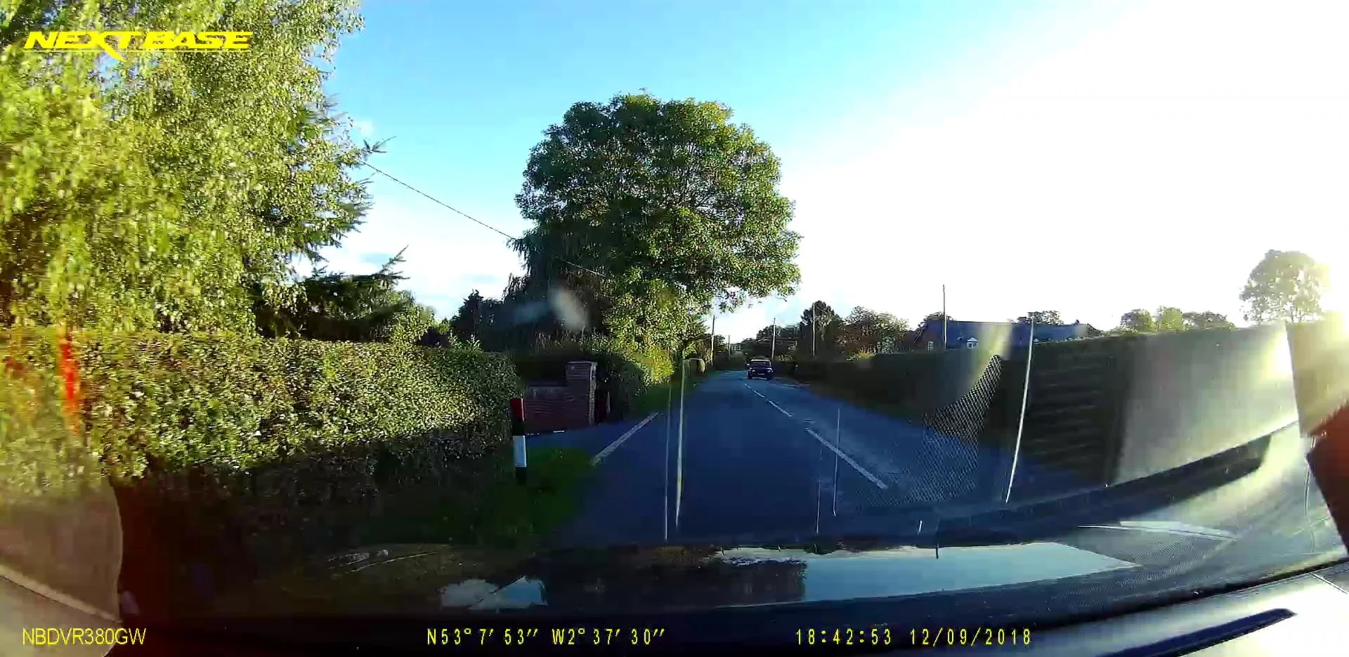

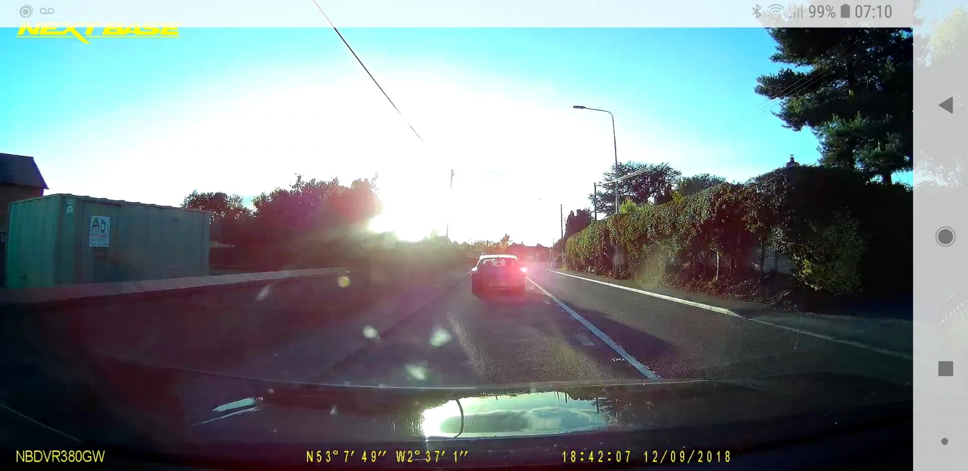

I do agree. I like the mounting option.
I've attached (hopefully) a few snap shots from last evening. This is normal for the capture I see.
Any recommendations for improvement?Screenshot_20180913-071006_Cam Viewer.jpgScreenshot_20180913-071119_Cam Viewer.jpgScreenshot_20180913-071222_Cam Viewer.jpgScreenshot_20180913-071247_Cam Viewer.jpg

You are getting more glass glare than I'm getting into the sun.
I've scoured my trip down to Eastbourne last week and this is the worst shot I can find. I've circled the sun as it's not that easy to see exactly where it is as the cam seems to have compensated slightly:

There isn't anything that we offer at the moment, I did 'make shift' one which worked but was unattractive.
What do the images look like when not pointing at the sun? Can you upload a screen shot so we can take a look?
Tiffany.
The last shot is out of the direct sun. I get an enormous amount of reflection..
I've even consider using an old lens from a set of cheap sunglasses.. I would imagine it would work.

@NextBase Tiffany
Use any of the test clips in my Dropbox link. They are still there.
Those clips are from South to North so the sun was semi behind me.
Looking at those sample shots above I can see why they appear worse than mine, the camera can see the bonnet whereas my bonnet drops away so can't be seen.

Got it :) thank you.
Yes the glare is pretty substantial there in comparison to yours.
