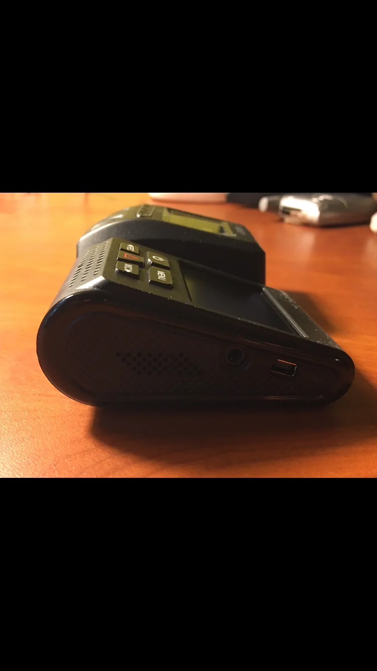

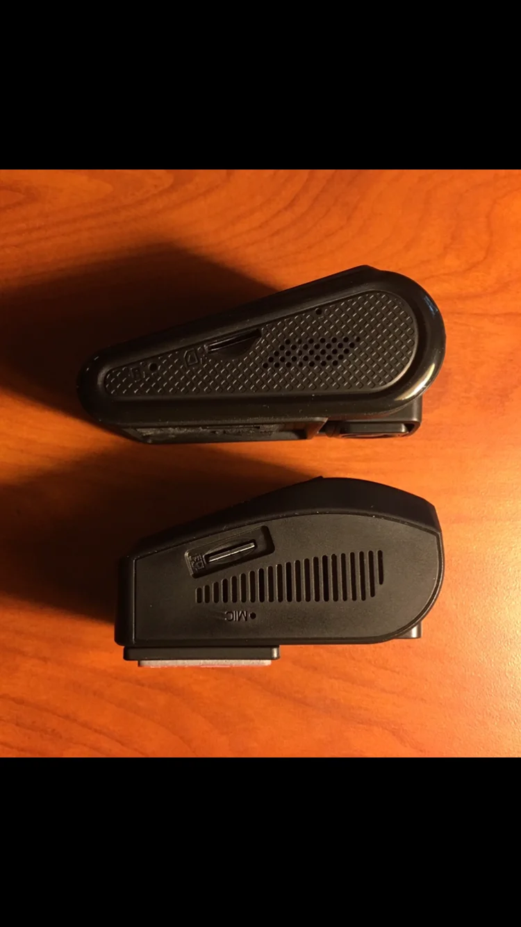

I haven't done any video comparisons yet, but the build quality and packaging are quite comparable to the A119. DR-02 is shorter but thicker than the A119 and overall feels "smaller".
It look like one "short" version copy A119S!:(

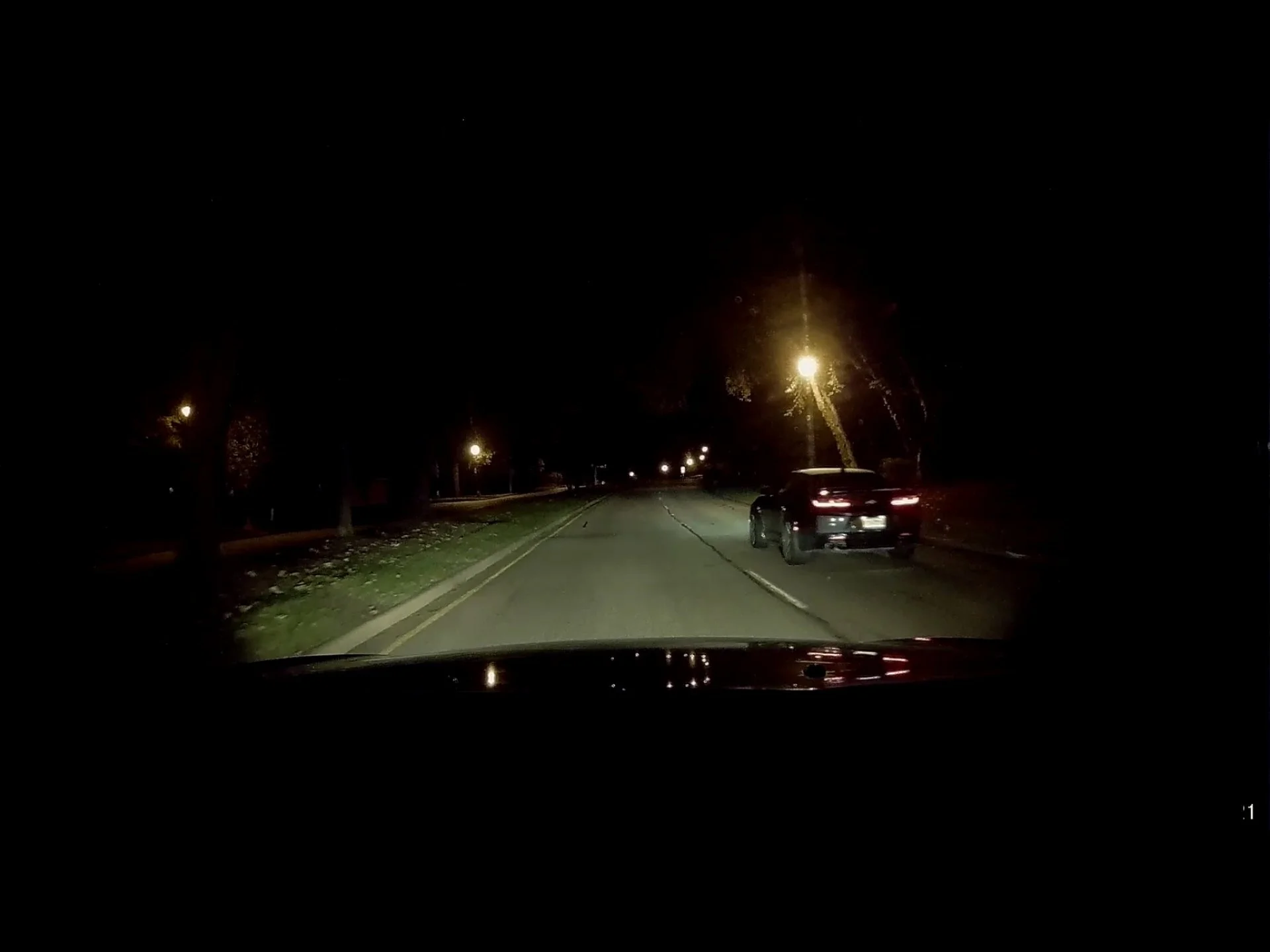

Very early in my testing but ... let me ask you guys, which do you think is which? Or which do you think looks better?
A119 vs DR-02: night around 9PM
- Group A is from one cam. Group B is from the other. I’ve blacked out date/time/other/info identifiers.
Group A (Edit: this is the DR-02 at 1080p/30fps with no WDR)
Group B (Edit: this is the A119 at 1080p/60fps with WDR-ON)
A = DR02
B = A119
Assuming the DR02 is like my DR01 ;)

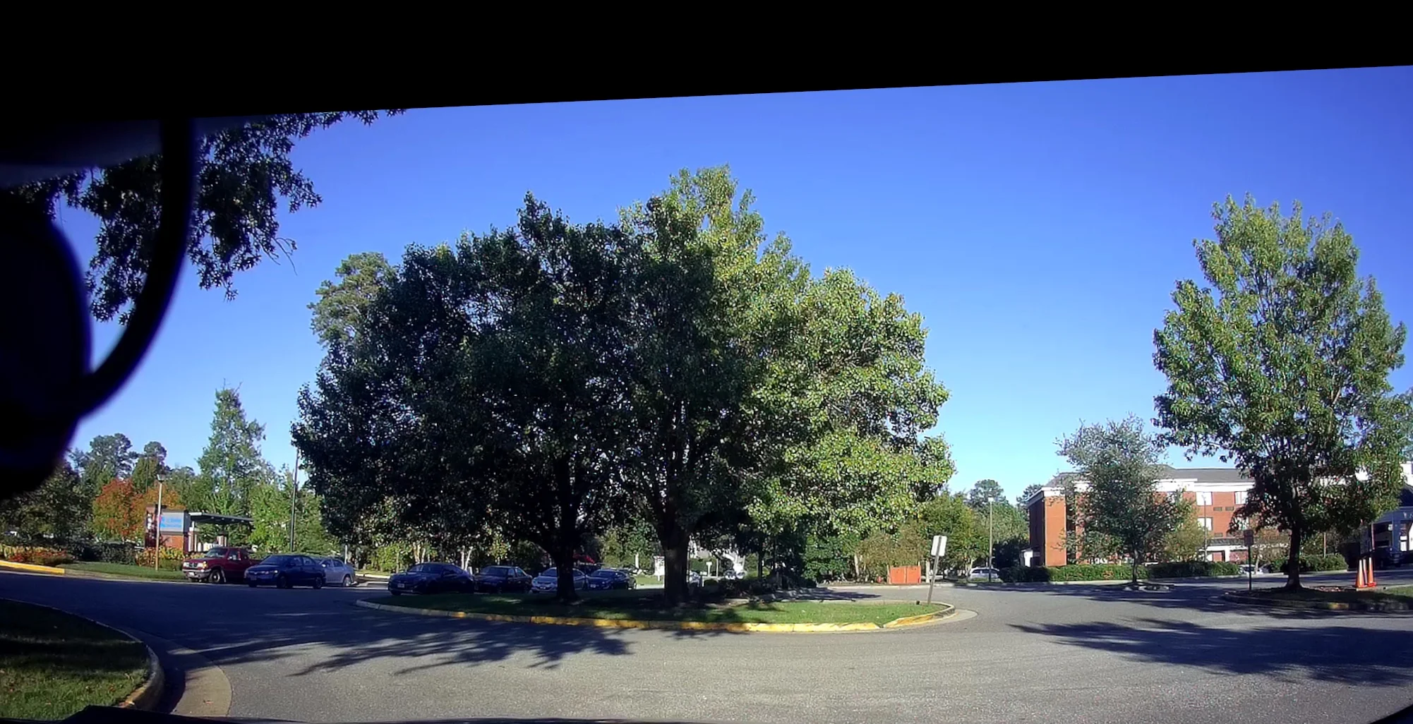

Couple more images from late afternoon, around 5PM.
Group A (top); Group B (bottom) (Edit: Top-A119 at 1080p/60fps with WDR-ON; bottom-DR-02 at 1080p/30fps with no WDR)
Looking at your first set of video frames, camera A (on the right) has more texture detail than camera B in this static scene. Camera B has better highlight control.
In the night driving scene (camera A on left this time), again there's more apparent detail from cam A, but cam B has less motion blur and better control of highlights.
I prefer the output from camera A, but camera B has its merits.

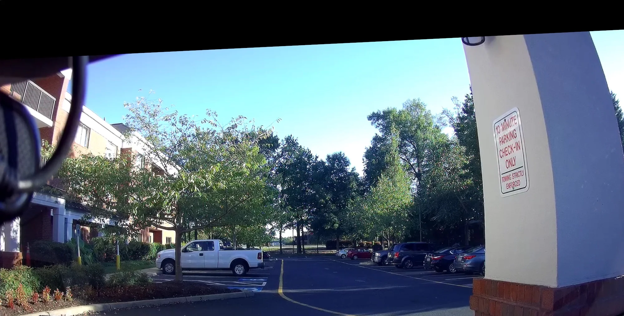

Did you intentionally swap group A and B this time? :sneaky: It was confusing me until I worked it out!
Hint: you can see one camera in the view of the other....;)
This time I prefer camera B, though both have managed a good exposure across the bright and shadow areas.
