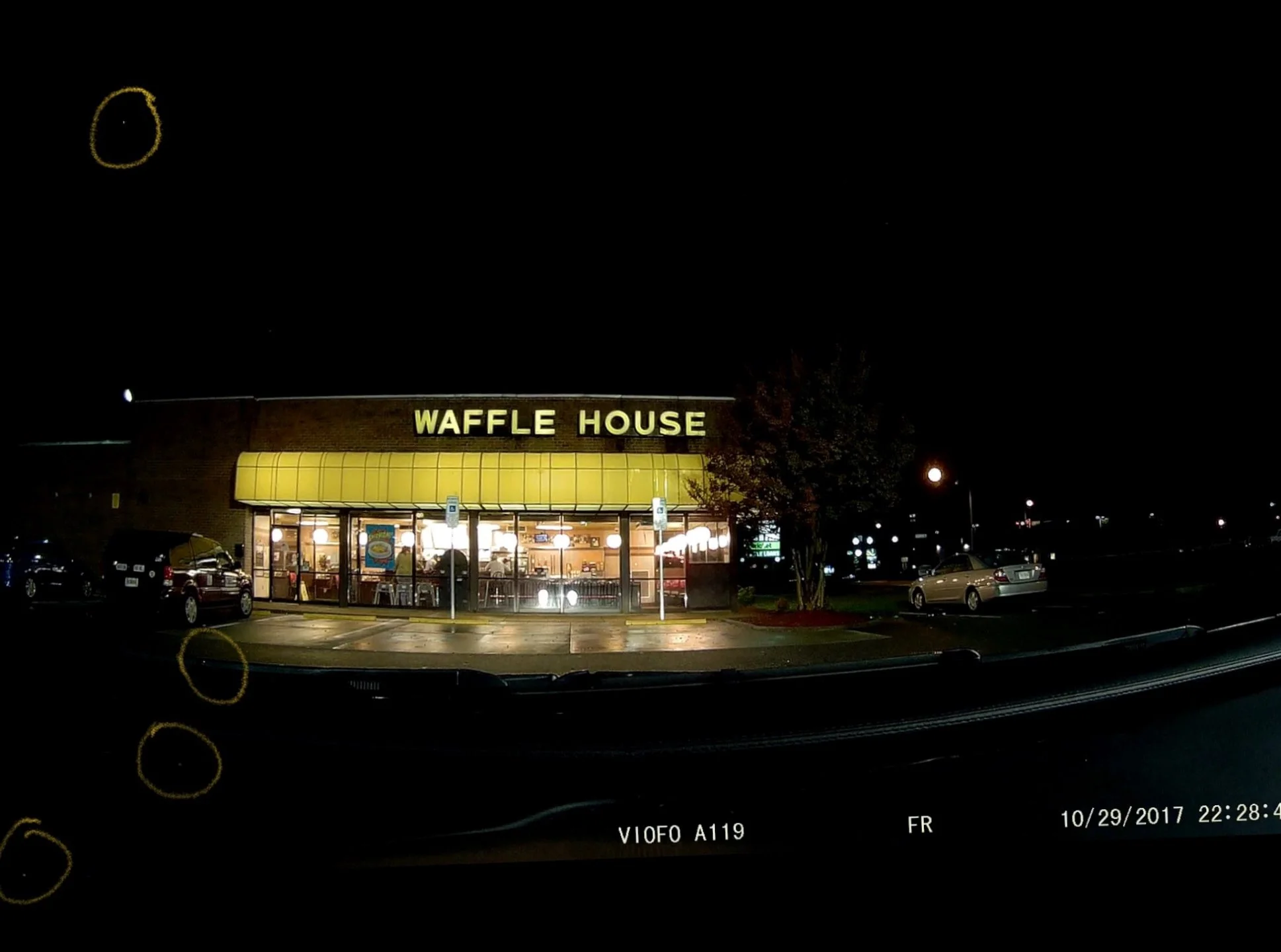

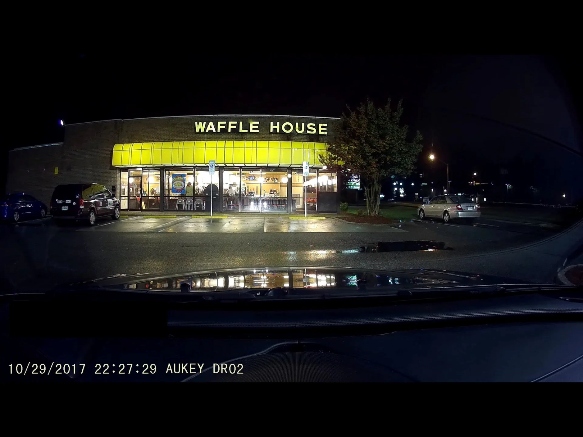

It’s been raining non-stop around here so been hard to get some good video, but these pictures say lots.
Both at 1080p/30; WDR Off.
One comes with free hot pixels. Even the Waffle House staff couldn’t give me those for $$$. (“Sir, is you wantin’ some hawt grits? Or what the heck do you want.”)

Just looking at the details of the parking lot in front, the Aukey looks better. The colors even look better. The Viofo looks like it has a yellowish tint, and the fisheye effect is more apparent throughout the picture. By comparison, the fisheye effect is barely noticeable on the Aukey.
Glad I went with the Aukey yesterday.
