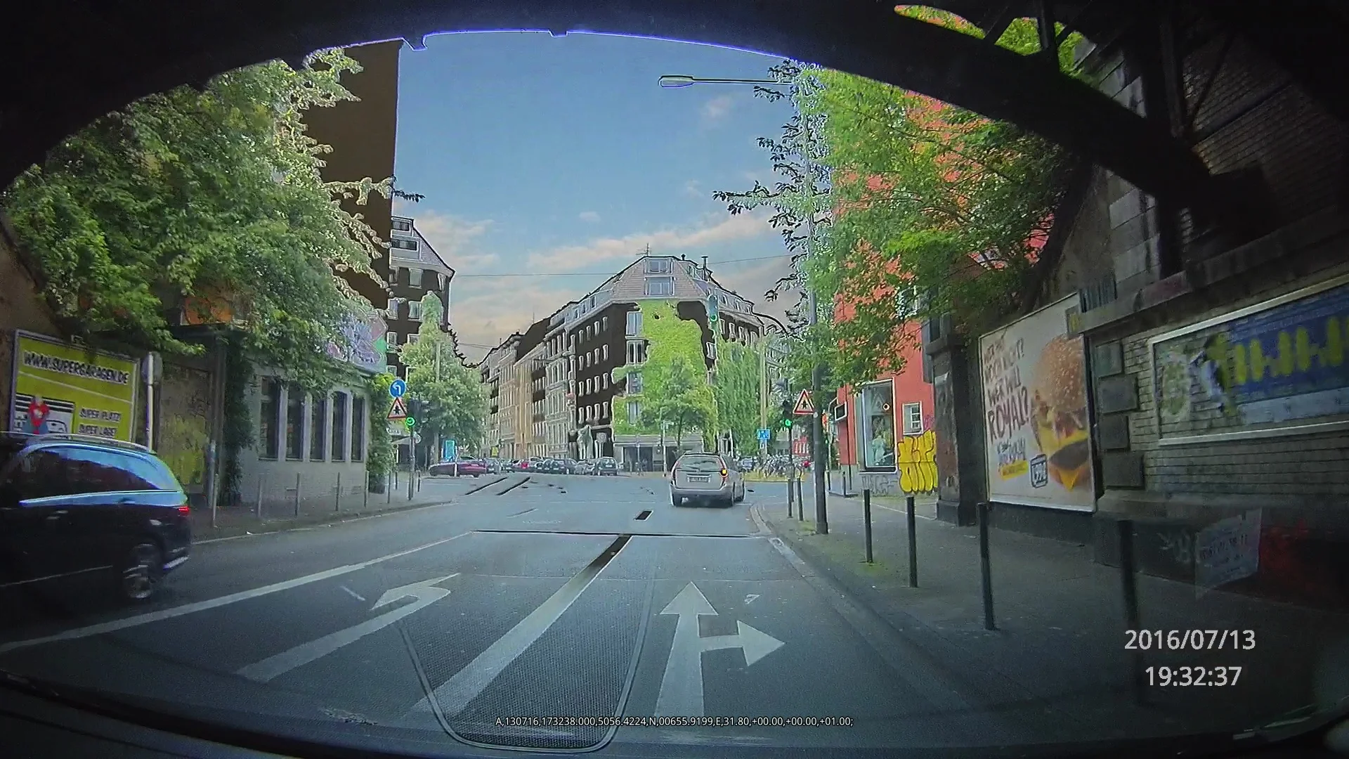

1920x1080 with HDR enabledIs HDR on?
What is the resolution?
No special reason just wanted to test the video quality. I saw this problem once on youtube but forgot what the solution is. Anyway I'll test under other resolutions today.What is the reason behind using HDR during the day? I will check the same thing with the same resolution and will post here.
But I believe the HDR feature avoids overexposure in highlight area of the photoI strongly believe this is due to HDR option. Normally this phenomena makes dark areas more visible during night time. If you use it during day time, it may distord the image. Use HDR under low light conditions only.
I will post the version later tonight cause the cam is in my car and I'm away from car now.Can you type your firmware? Mine is![]()
We have the same version. And I didn't found the same issue under 1296p and 2160x1080 resolution. So I guess is the HDR that produced the issue.I will post the version later tonight cause the cam is in my car and I'm away from car now.
