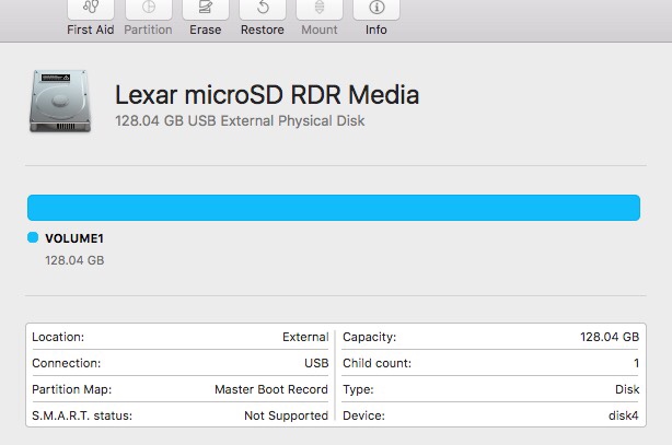

I got my Lexar 633x 128GB card but I couldn't format it using my DR650S. It kept trying to initialize over and over. I used SD Formatter and then copied the contents of my 64GB 300x Lexar that was giving me problems to it and inserted it back into the dash cam, bypassing the "initializing SD card" message. It has worked fine for 5 days straight. With parking mode off and connected to my PMP (for testing) it has gotten overwritten twice. No issues. I'm happy with it.
I'm glad the Sony one worked fine for you.

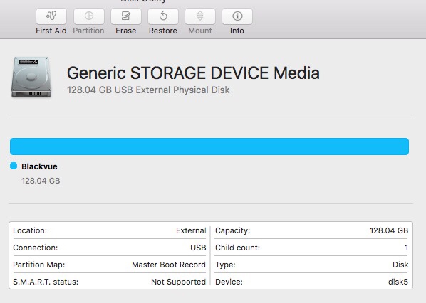

This is what I used and what worked for me. The first step may not even be necessary but I did it anyway.
Step 1: Use SD Formatter as described on this page https://www.blackvue.com/sd-card-formatter/
Step 2: Use the Blackvue viewer to format the SD card
Step 3 (may be unique to me): Copy the contents of the SD card that worked. This may be the original/smaller Blackvue card that you are migrating from.
Your mileage may vary.
