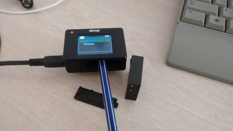

I'm not 100% sure but if the gitup is like the SJ4000 then provided it's connected to power by cable, it should work without the internal battery being fitted, and coming on/off with the cars ignition, I'll have a look later and see if the gitup2 works from car power without the battery inserted,
Pen added to illustrate the lack of battery. Works just fine only on USB power.
Sent from my XT1068 using Tapatalk
But does it save the file being recorded when external power is cut? Which would be the crucial file containing evidence of what happened in a car accident. If that file is lost or corrupted, then the camera battery must not be removed if the Gitup is to be fit for purpose as a dashcam.
That will be solved with the super cap battery.
That's fine if @ArgusMcJohnsten uses supercaps instead of the standard battery. If, however, he uses the Gitup as a dashcam without either, he may regret it in the event of an accident in which the vital clip is lost or corrupted when external power is cut.
