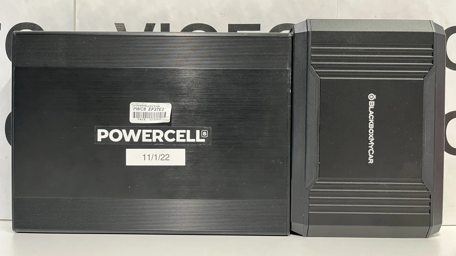

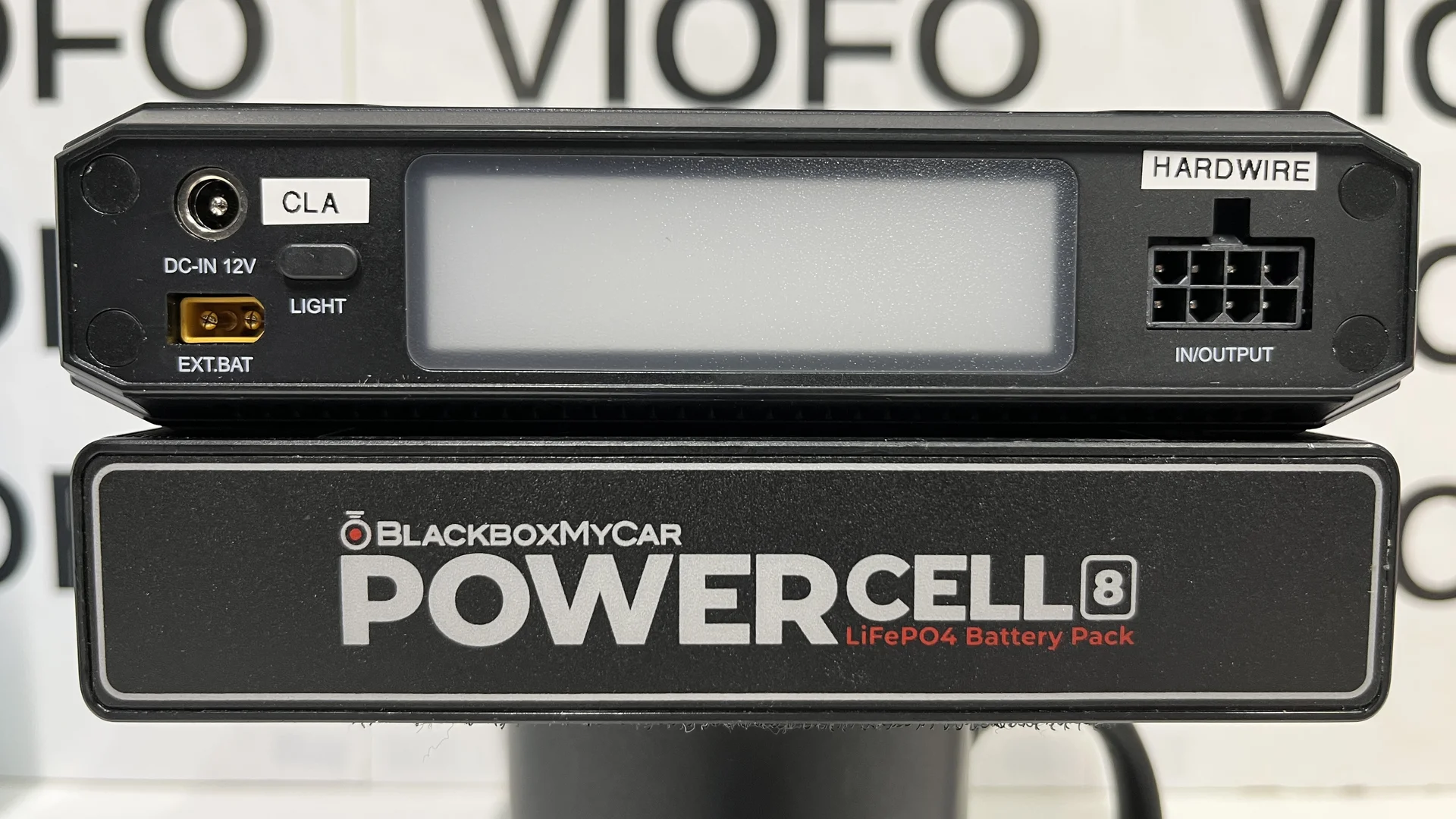

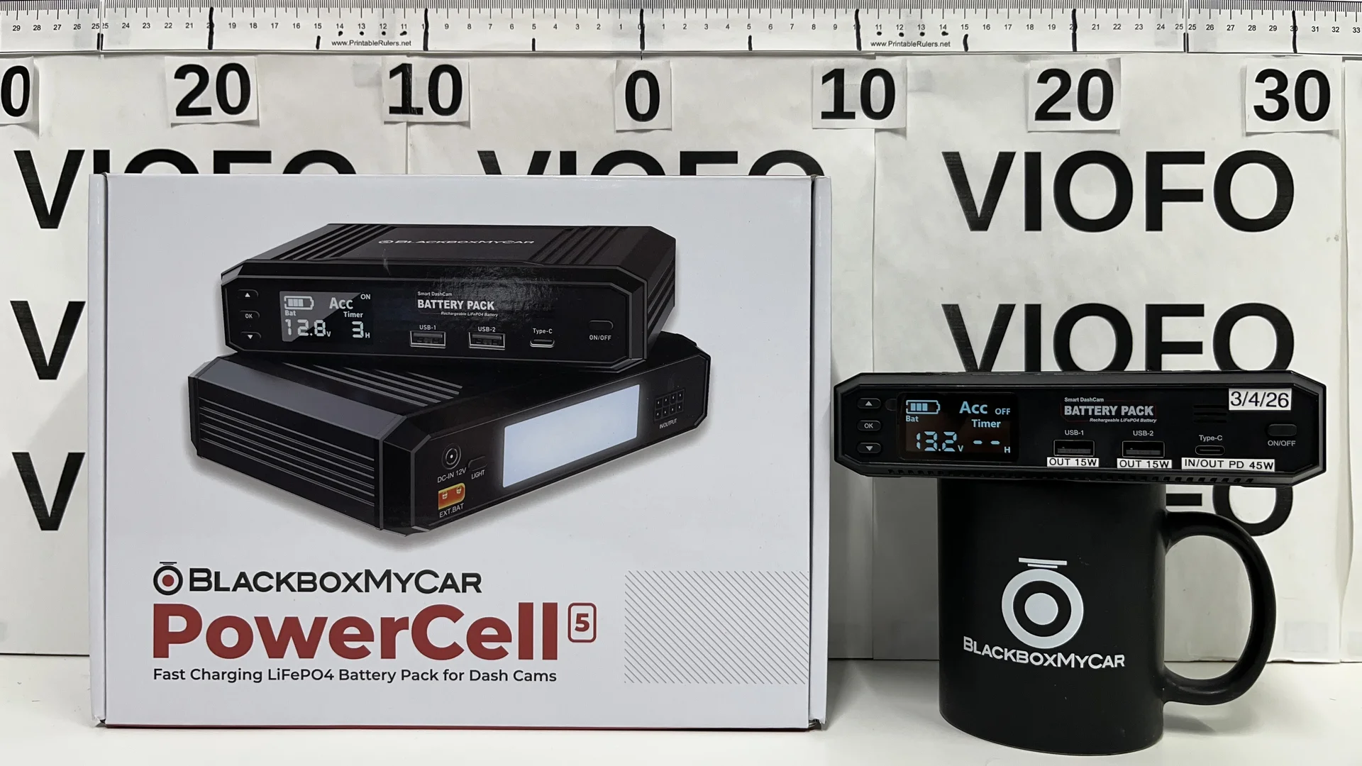

This is the 5th Dash Cam Battery Pack I’ve tested.
Oct 2022 BlackboxMyCar PowerCell 8 (EGEN Korea) BBMC PC8 TEST & REVIEW
Dec 2022 BlackVue B-130X (EGEN Korea) BLACKVUE B-130X TEST & REVIEW
Sep 2023 Thinkware BAB-95 (EGEN Korea) not tested
Sep 2024 70mai BL96NNX (70mai China) 70mai BL96NNX TEST & REVIEW
Nov 2025 VIOFO BP100 (Viofo China) VIOFO BP100 TEST & REVIEW
Mar 2026 BlackboxMyCar PowerCell 5 (EnergyWell China)
Jun 2026 Vantrue Power D1 (Vantrue China)
I’ve been following the “global” release of @Energywell Dash Cam Battery Packs since November 2024, and they’re finally available for sale in USA through www.blackboxmycar.com

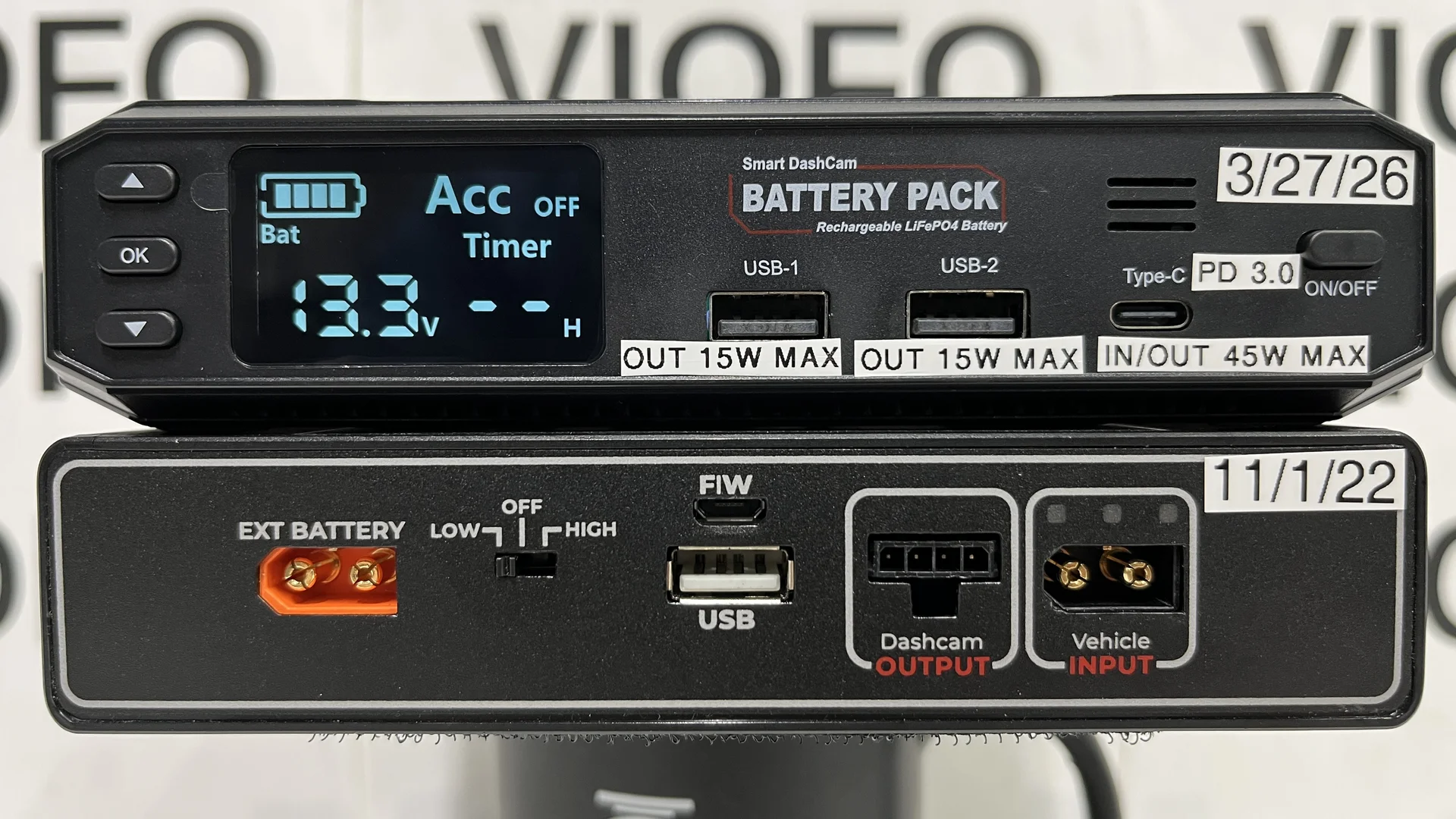

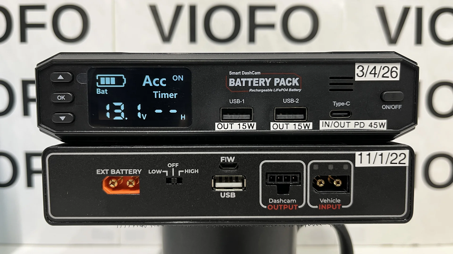

BBMC PC5 interests me because it does 3 things no other dash cam battery pack currently does;

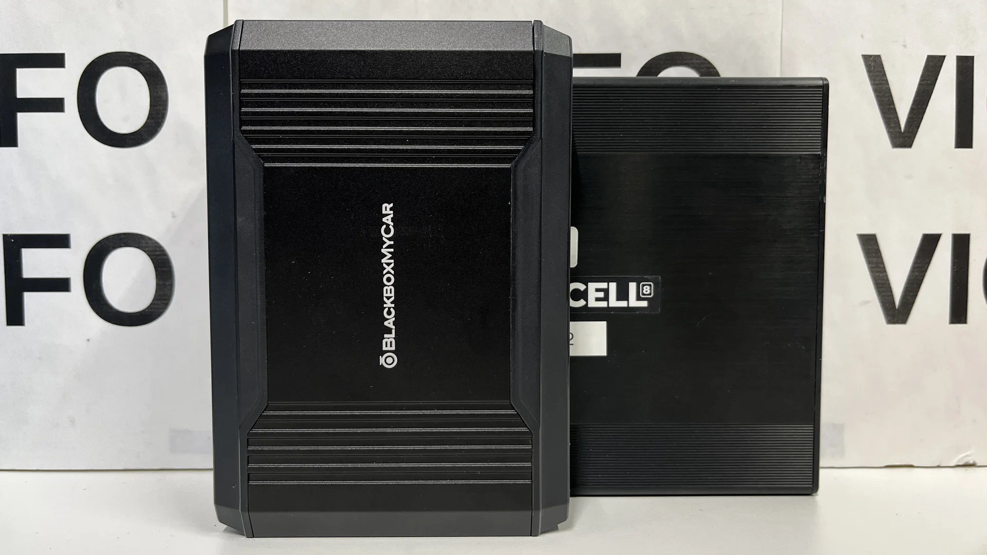

1.) SMALL SIZE (half size of BBMC PC8, should fit anywhere)
2.) Type-C INPUT CHARGING:
For the first time ever, customers can charge their dash cam battery pack with a laptop / smartphone charger they already own, instead of having to buy yet another "expensive single-use device” like an AC/DC Power Inverter;
https://www.blackboxmycar.com/products/blackboxmycar-power-inverter
The number one question I see from first time dash cam battery pack customers is;
“How do I charge the battery pack if I don’t drive long enough, or often enough?”
EXAMPLE #1: “My commute is only 5 Minutes long”
EXAMPLE #2: “I work from home, I only drive my car once a week”
3.) AUXILIARY CHARGING INPUT:
In addition to traditional hardwire configuration, BBMC PC5 has a second auxiliary HIGH AMPERAGE CHARGING INPUT.
This opens the door for Solar & Power Station Charging.
Location & weather permitting, this means the dash cam battery pack can remain fully charged at 100% during the day, and only begin to discharge when the sun goes down.
This should extend parking mode operation run time.

How to configure HIGH / LOW charge speed configuration?
HIGH = 8 Amp (33 Minutes)
LOW = 4 Amp (65 Minutes)

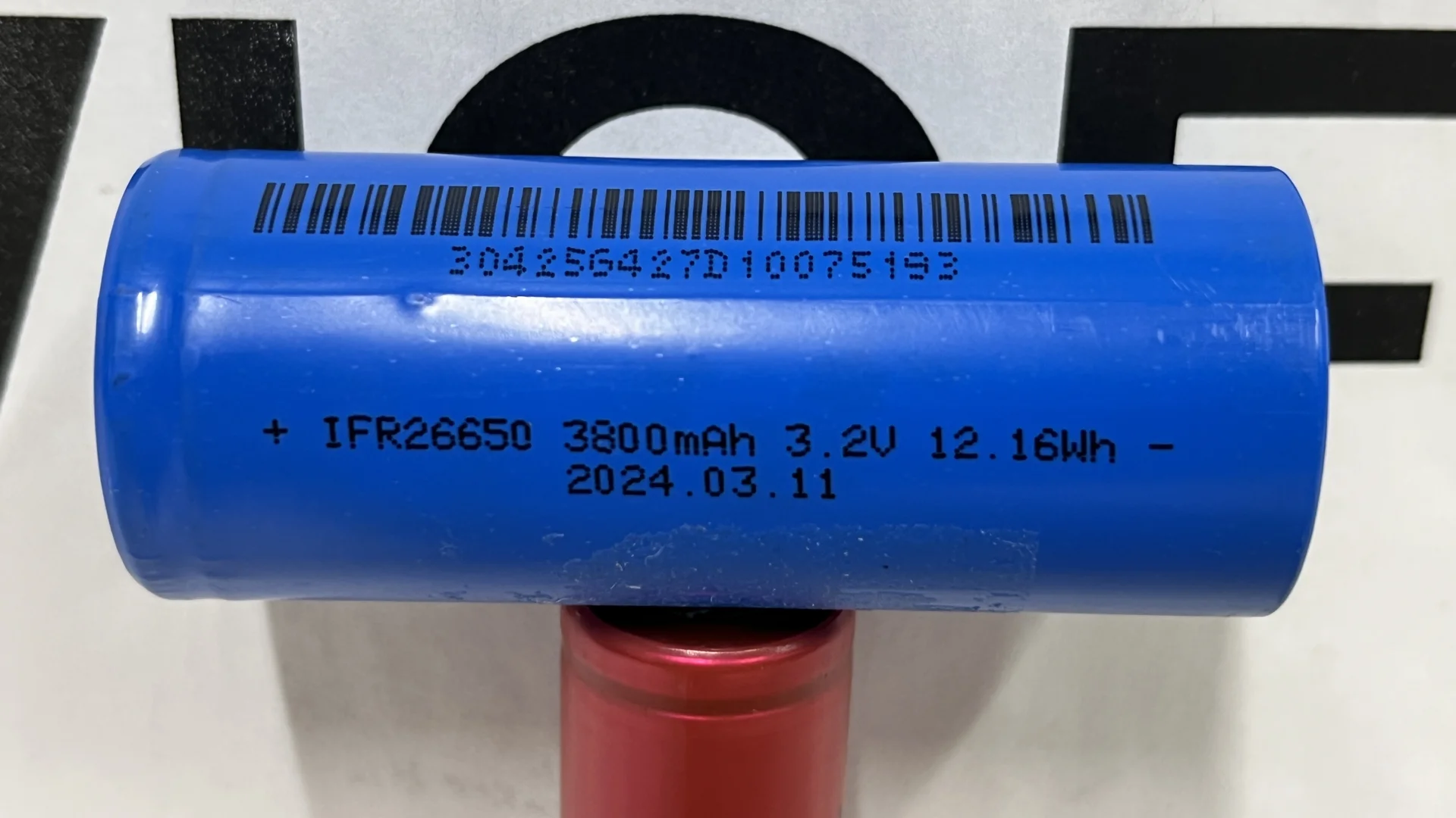

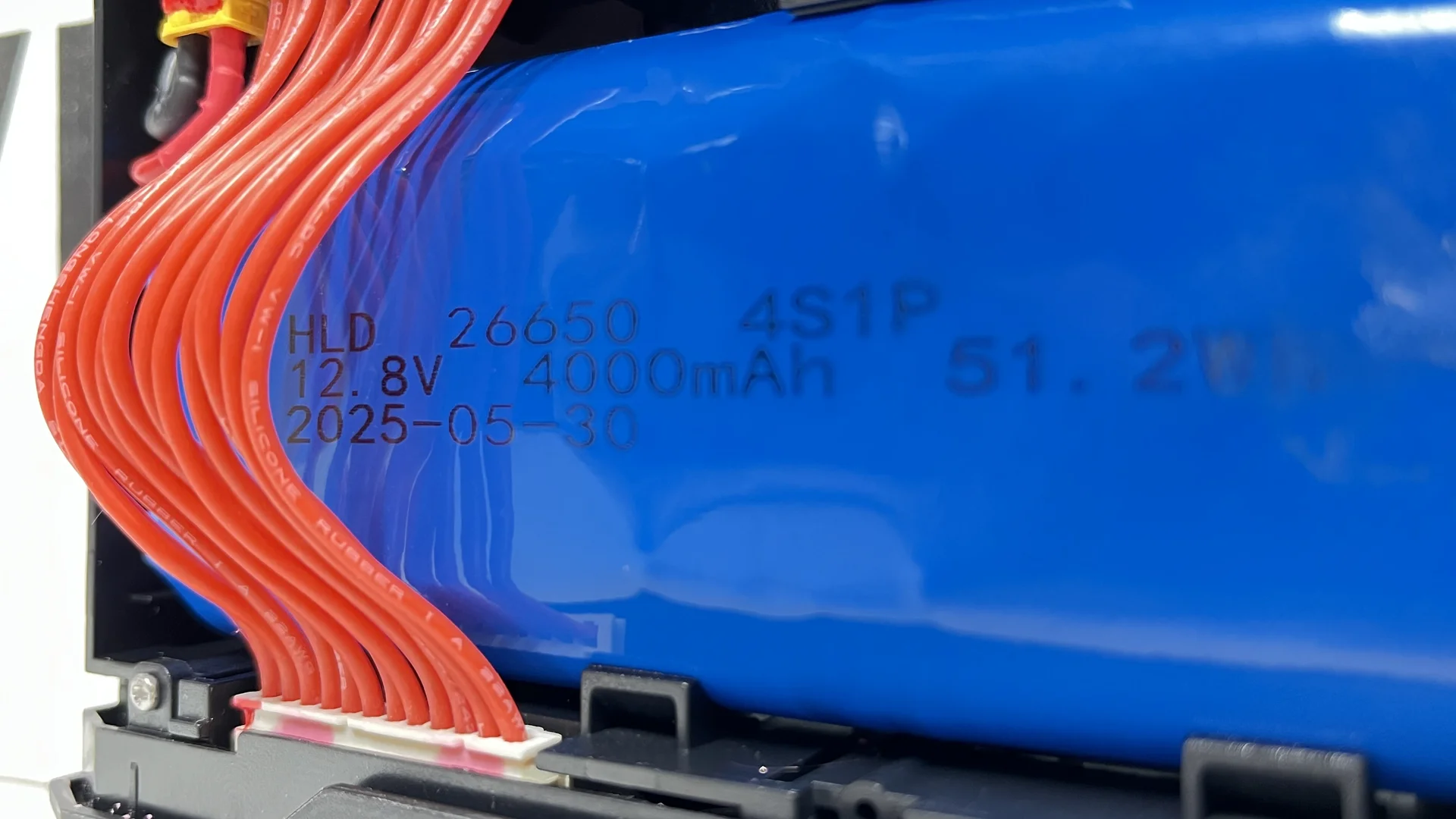

I am curious to know what grade of LFP cells they are using (automotive-grade? or something else?), since a charging current of 8A for a 4Ah battery corresponds to a charge rate of 2C - which is quite high for ordinary LFP cells.
Reply function not working.
Chuck said:
Yo GPak, I thought you’d never ask. lol

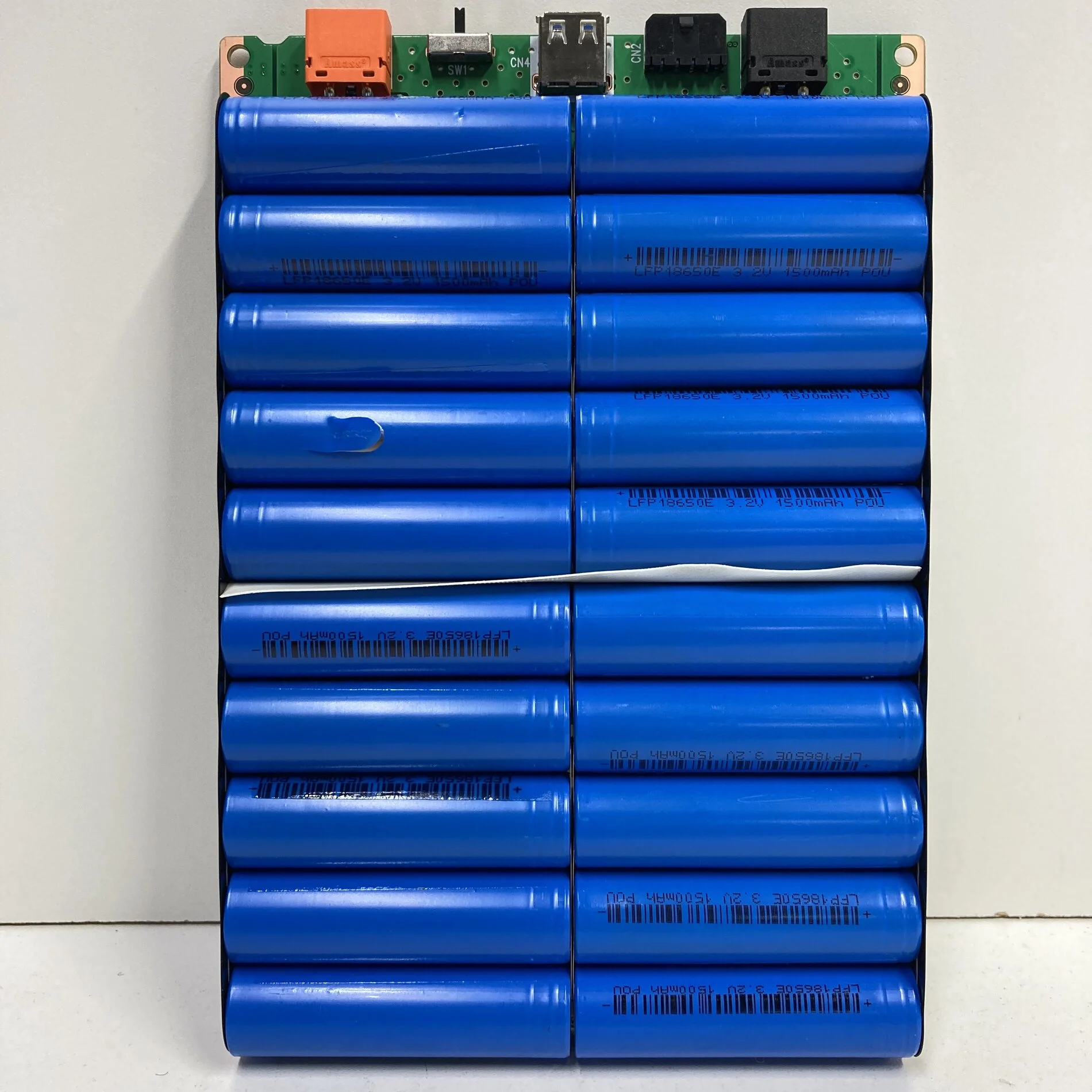

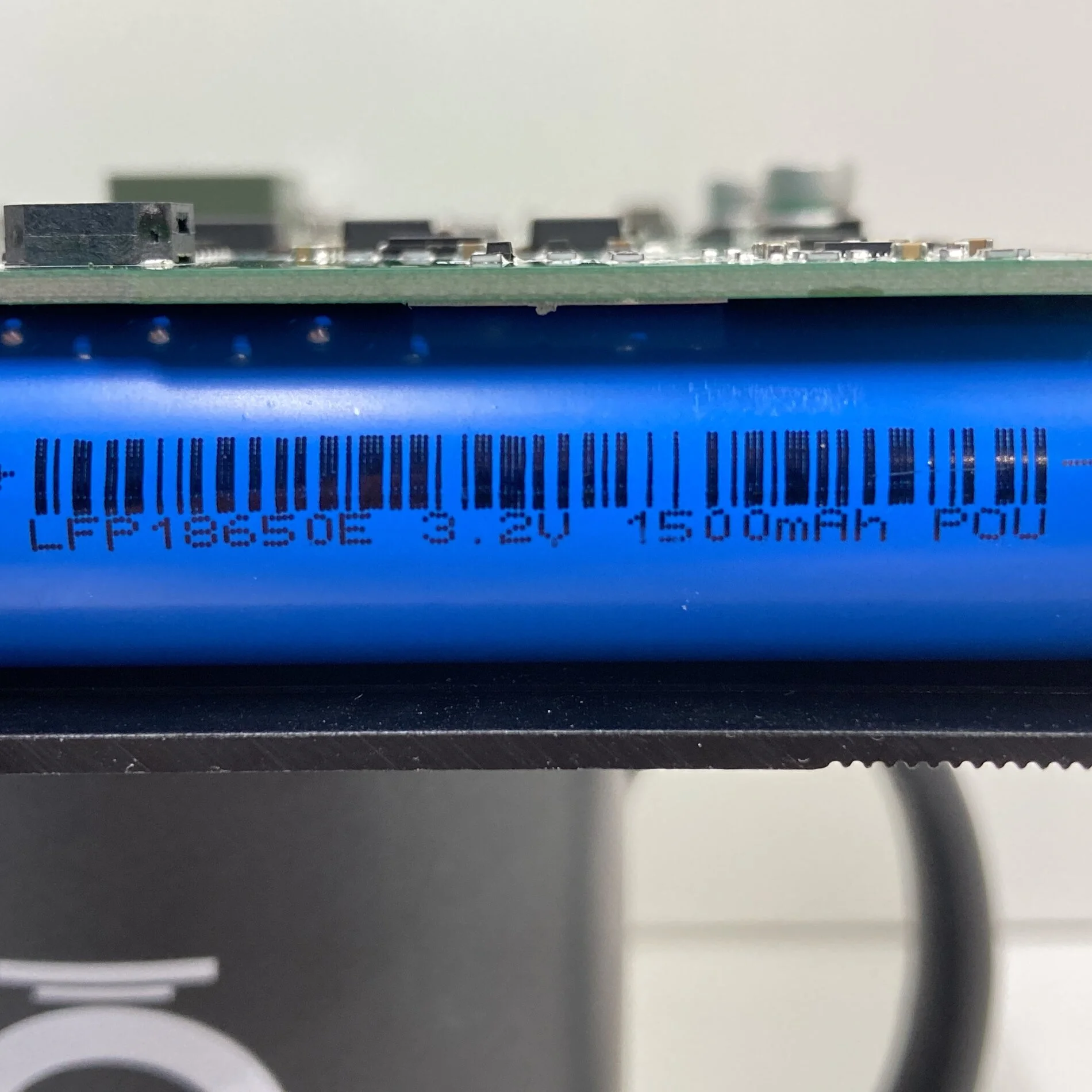

A little birdy told me all LiFePO4 (lithium iron phosphate) cells in all Dash Cam Battery Packs are coming from the same handful of factories in China, (even Korean made units).
The BlackboxMyCar PowerCell 8 (2021), and BlackVue B-130X (2022) both made by EGEN Korea use (20) 18650 cells.
2024 the first Dash Cam Battery Pack made in China available for sale in USA, (70mai BL96NNX) used (8) 26650 cells.

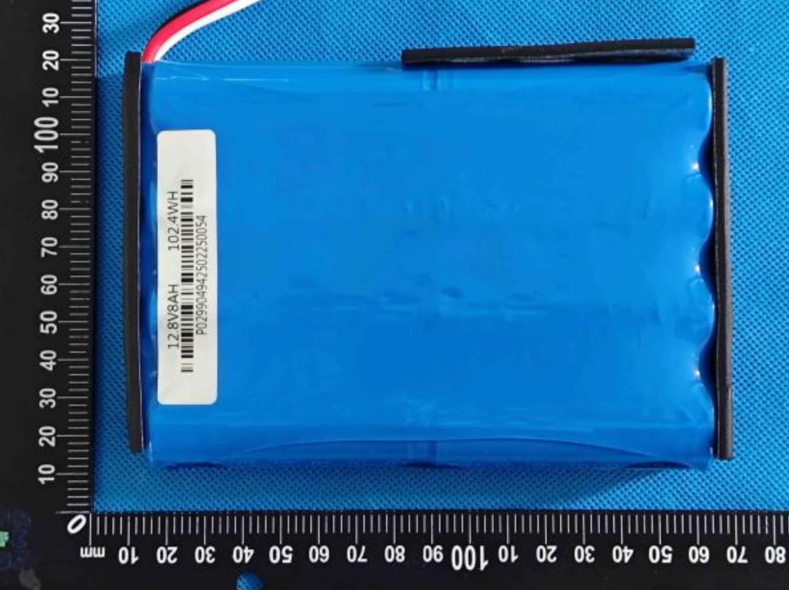

2025 Viofo BP100 also uses 8 Cell configuration.
Here’s a photo of a cell I removed from one of my 70mai Dash Cam Battery Packs, (it was DOA, would not charge).
Instead of waiting 3-Days to ship it back to Hong Kong for diagnosis, they asked me to take some measurements, and photos of the guts.
Sure enough, there was a little black burn spot on the circuit board next to the input charging connector.
The cells were OK so I took it apart, and use the cells in my 26650 rechargeable flashlight. lol

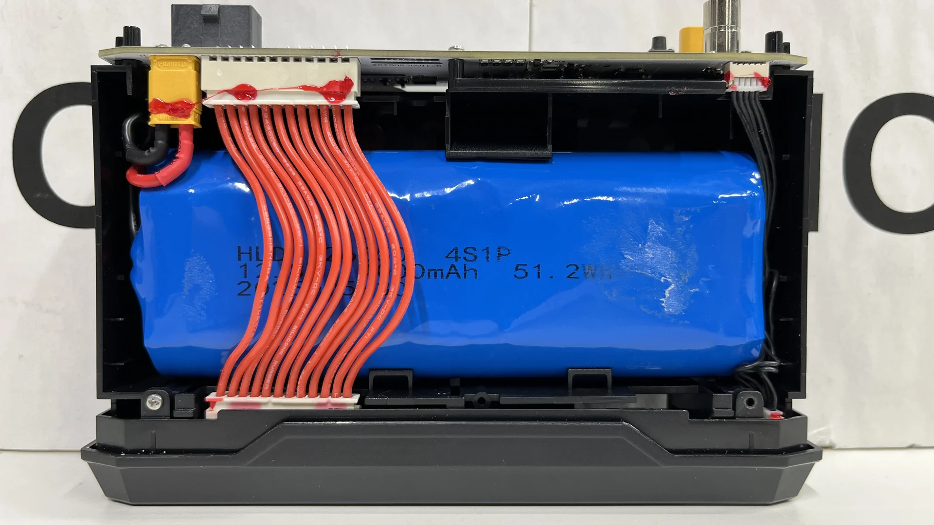

Maybe I will try to take apart the PC5 to see what (4) cells are used without damaging it.
-Chuck
LFP battery cells can be produced at the same factories, but with different technical specifications.
Standard LFP batteries are able to handle charge rates of up to 1C (allowing them to reach full capacity in approximately one hour); however, when charged at a rate of 2C, they degrade significantly faster.
LFP batteries capable of withstanding a 2C charge rate (which allows them to reach full capacity in approximately 30 minutes) typically represent specialized designs in which the physical and chemical structures of the electrodes and electrolyte have been optimized to enhance conductivity and reduce internal resistance.
These are likely more expensive.
The ideal source of information would be the battery cell's datasheet; otherwise, BlackboxMyCar might be able to clarify this.

@GPak
I tried to take a peek, but this was all I could find.
HLD 26650 4S1P
12.8V 4000mAh 51.2Wh
2025-05-30
The only thing I’m not familiar is HLD.
26650 = Cell Size
4S1P = Cell Configuration
HLD = ???
Thank
@GPak
HLD 26650 4S1P
2025-05-30
26650 = Cell Size
HLD = ???
This is good enough info! Thank You, @Chuck McCoy
This confirms my assumption regarding the high-quality of the battery!
The HLD designation typically indicates a High Load/High Density classification.
Generally, these are very high-quality LFP cells characterized by minimal internal resistance and other structural improvements, making them suitable for use in Electric vehicles.
These cells are capable of charging and discharging at rates higher than standard, which explains 2C charge rating! (about 30 min for a full charge)
The other advantages may include (but are not limited to): - Longer life cycles, wider operating temperature range, low self-discharge, deeper DoD (Depth of Discharge) without compromising cycle life, etc.
