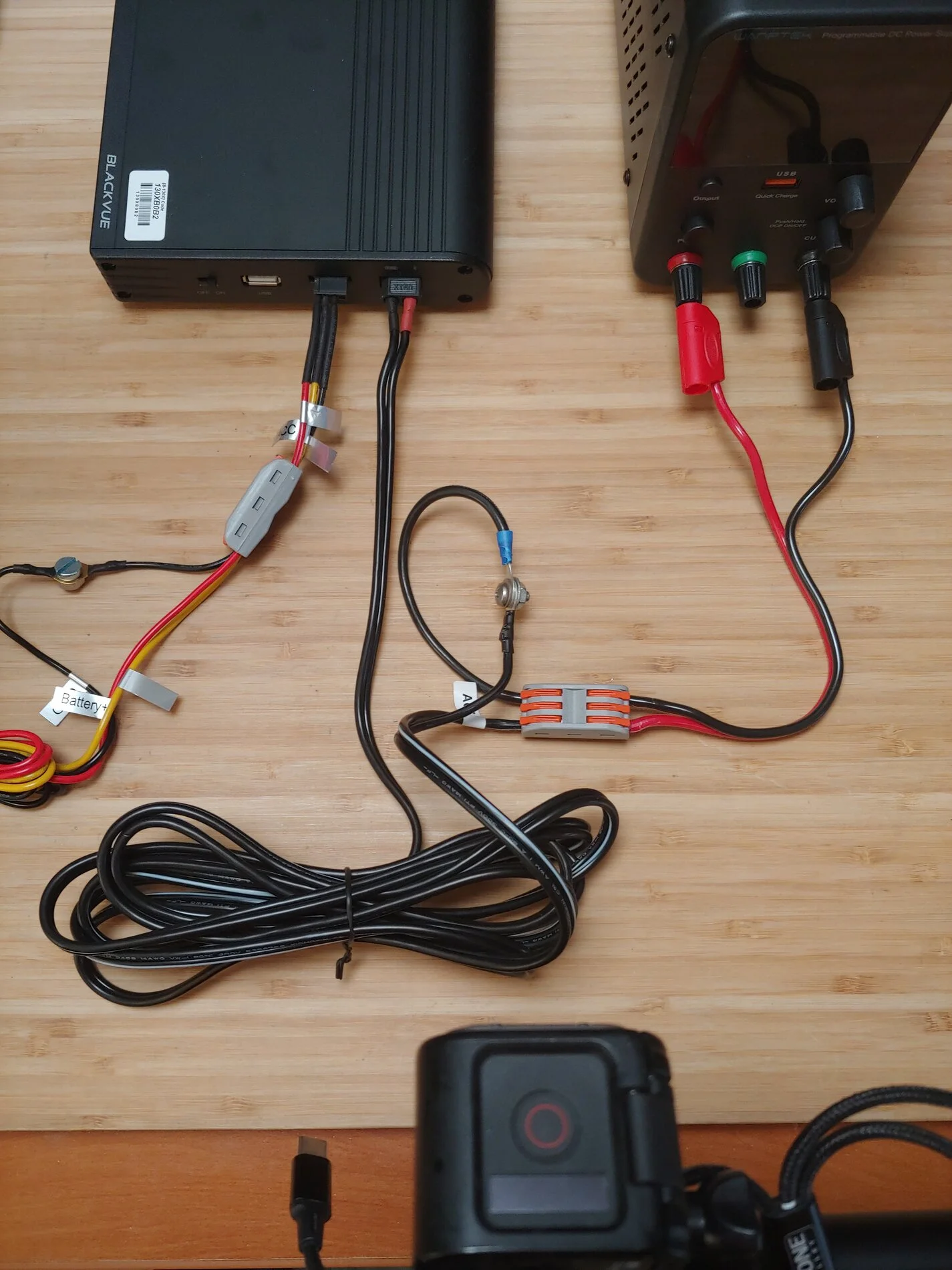

This morning, I ran a hardwired charge cycle test. DC power supply set at a 14.2 volts with a max amp setting of 10 amps. The room temperature was 68F/20C. I have 12 AWG wires coming out of the power supply and use a 12-28 AWG lever connector to connect the 12 AWG wires from the DC power supply with the 14 AWG hardwire cable wires providing power to the B-130X.
I used a VIOFO A139 Pro 3CH dash camera as the "load" on the B-130X during the charging cycle. This is to replicate a dash camera in a vehicle that had depleted the charge level to its minimum level in parking mode and the vehicle is then driven to charge the B-130X and power the dash camera load attached to the B-130X.
  • Charge Cycle Test Minutes / Charge Level / Estimated Full Charge Time
    • 0 mins / 1% / 49 mins
    • 7 mins / 10% / 45 mins
    • 14 mins / 20% / 40 mins
    • 21 mins / 30% / 35 mins
    • 29 mins / 40% / 30 mins
    • 36 mins / 50% / 25 mins
    • 44 mins / 60% / 20 mins
    • 49 mins / 70% / 15 mins
    • 53 mins / 75% / 13 mins
    • 59 mins / 80% / 10 mins
    • 61 mins / 81% / 10 mins
    • 67 mins / 81% / 10 mins - Stats in the BlackVue Battery app remained at 81% charge level and 10 minutes remaining for eight minutes at this point
    • 67.5 mins / 100% / Fully Charged
The PowerCell 8 required just under 60 minutes to reach a full charge level with the same load applied to it during its charge cycle. Both exceeded their 50 minute estimated charge time when using the hardwiring cable at the max amp charge level of 9.0 amps.
The load on the DC power supply (from the B-130X) ramped up to 9.2 amps fairly quickly and remained in the 9.15 to 9.20 amp range during most of the charge cycle. After reaching a full charge level, the load of the dash camera would cause the charge level to decrease (but not shown in the app) just enough to require a short charge cycle every 25 to 30 seconds (similar to the PowerCell 8) where it quickly jumped up to 8.5 to 9 amps and then it would ramp down quickly.
The 14 AWG hardwire charge power cable for the B-130X did stay a bit cooler than the PowerCell 8's 16 AWG wire, but there's only a 4F degree difference. The 16 AWG wire used with the PowerCell 8 reached a temp of 103.8F/39.8C while the B-130X's 14 AWG wire reached a temperature of 99.8F/37.6C.
I’m confused.
Did you already get your XT60 connectors delivered?
This is not how I meant to perform this test.
Why are you still using the included 14AWG cable “in-line” with the 12AWG wire?
The 10ft 12AWG wire with XT60 connector is meant to “replace” the included 14AWG cable.
Like this;
My temperature reduction was from 94℉ to 73℉.
Like this;
Can we get some non-thermal photos?
I have not received the XT60 connectors yet (maybe later today or tomorrow). This was not a test using 10ft 12 AWG wires running directly from the DC power supply to the B-130X.
This was a test using the B-130X supplied 14 AWG hardwire charging cable connected to my power supply via a lever connector which then has short 12 AWG wires going to my DC power supply. I included a thermal photo of the B-130X 14 AWG charging cable. Here's one of the B-130X.

Chuck, the short 12 AWG leads from the DC power supply to the grey with orange levers (quick connect) allow me to quickly/easily connect the product supplied power cable without having to install any connectors on the product supplied wiring.

Here's a photo of the wiring I currently have configured for the B-130X. I have 4mm banana plugs soldered onto 12 AWG wires which are 9 inches in length. I then have the lever connector joining the 12 AWG wires from the DC power supply to the product supplied cable. I have a 4 inch run of 12 AWG wire for the ground on the other side of the lever connector since the product supplied cord has a 1/4" ring connector and I join 12 AWG ground pigtail with the product supplied cable's ground using a screw/washers/nut. The product supplied cable (16 AWG for the B-130X) then connects to the product.
When I get the XT60 connectors, I'll create a 3m (9.8 ft) run of 12 AWG which will have the XT60 connector on the battery pack end and 4mm banana connectors to plug into the DC power supply. The 4mm banana connectors are rated for up to 600V/Max 32A.

OK, now I understand.
The regular photo made all the difference.
It looks like what you did is so you can use banana plugs.
I just put an O-Ring on the positive end of the included hardwire cable, and connected it directly to my power supply.
Sorry for all the extra work.
I'm so jealous of your new homemade 10ft. 12AWG charge cable.
I've been wanting to make one for a month, but I've been making due with a homemade 1ft 14AWG charge cable.
