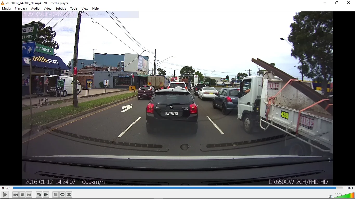

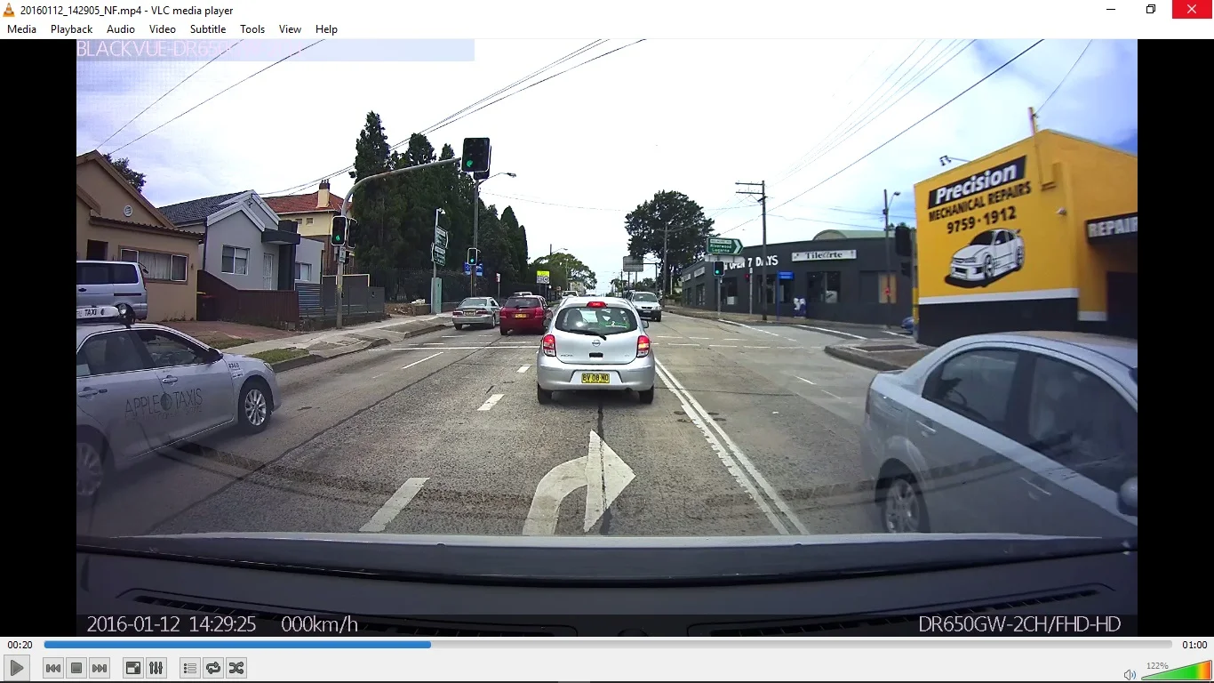

Now I've had a chance to review the footage with the replacement dashcam, it appears to have the same lens fault as the first one. Here's a couple of screenshots where you can clearly (pun intended 🙂 ) see the blurred image on the right side. Both images are still shots (vehicle not moving, so it's not blurred from pixilation/movement). Notice the blurred tree and text of sign on truck & building on RHS, but crisp text on taxi and sign on building on LHS.

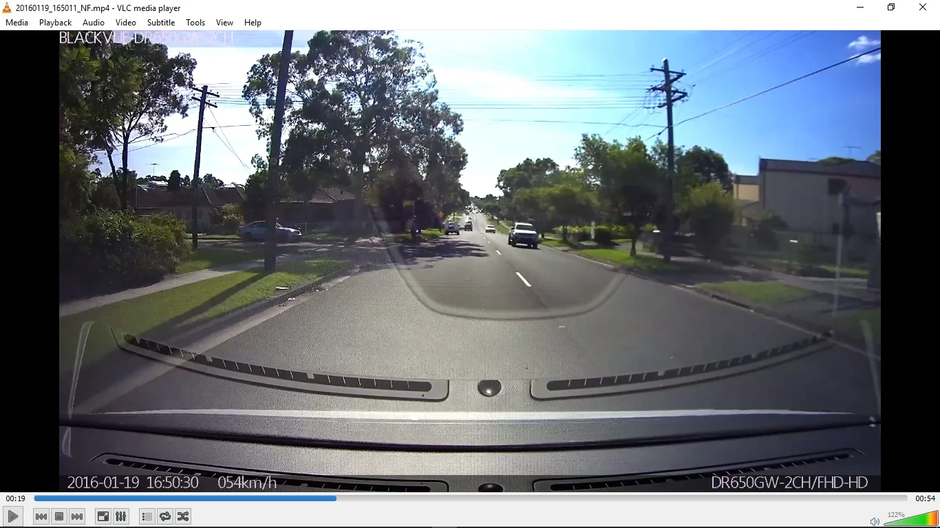

CPL filter doesn't appear to have much affect on the blurry image (still on the RHS as per the original cam). In the attached screen-shot you'll also notice the lack of clarity in the dash-vents on the RHS of the image (especially when compared to the sharpness of the vents on the LHS).
Off-topic, but CPL filter also doesn't appear to work as expected - notice reflected dash on windscreen in attached screen-shot. Perhaps it's effectiveness depends on angle of sun?

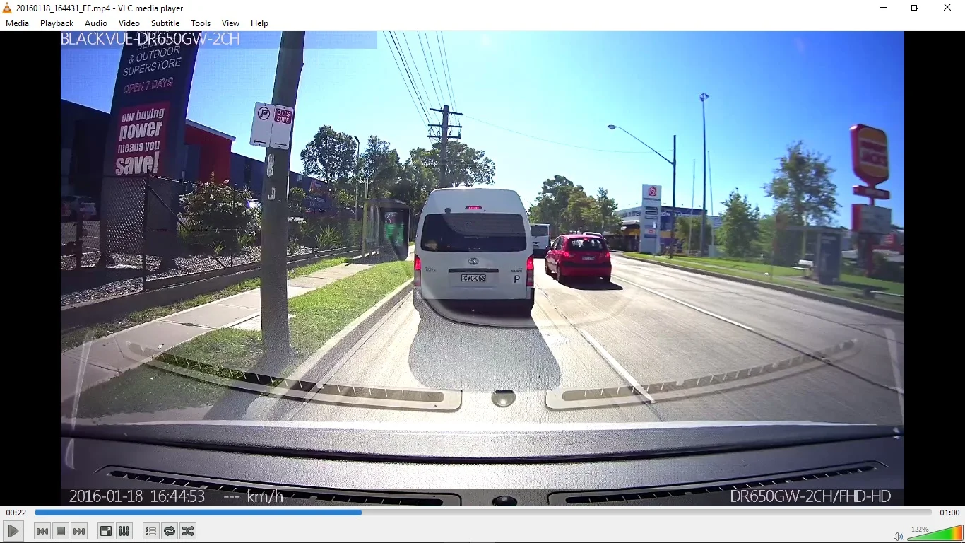

Another shot of the blurry RHS - notice the Hungry Jacks sign compared to the other sign on the LHS (without the CPL filter fitted - also compare reflections to above image WITH filter fitted).
I agree the RHS looks blurrier but the objects are at different distances (and lighting) from the camera so may influence some of the differences. A good way to check for blurry spots is to face square on to large brick (or concrete block) building.

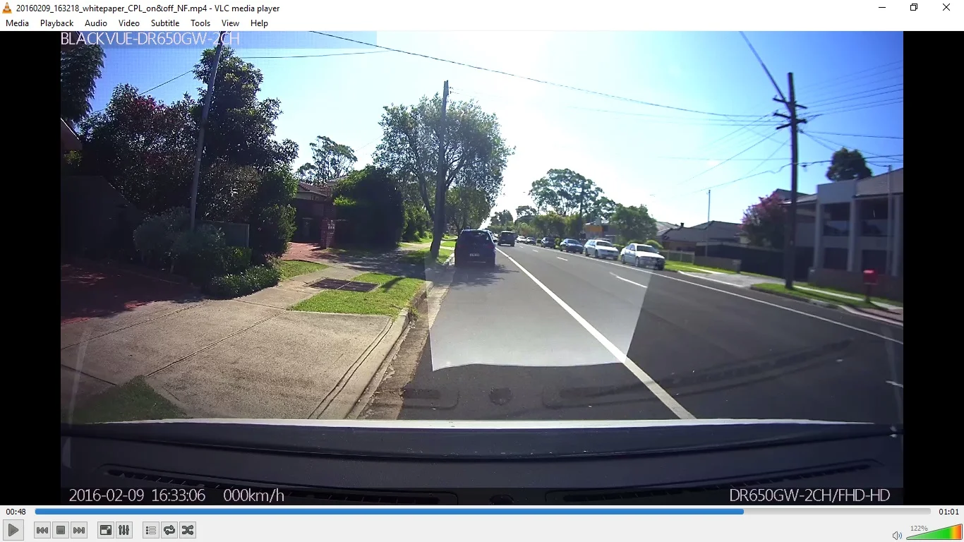

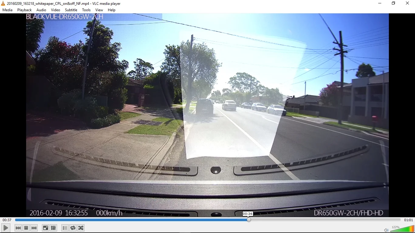

OK I've done some testing today and can confirm blurry image still present with and without CPL filter (and proved CPL filter works - but strangely doesn't appear to correct the lower half of the image where the "test" white paper was very clearly reflected).
Two images attached - one with and one without CPL filter. You will note on the one WITHOUT CPL filter that the right side edge of the paper has two reflections - either confirming focus problem, or something strange inside the windscreen glass (laminate/layers?). Only removing and repositioning the dashcam will confirm this (hopefully try tomorrow).

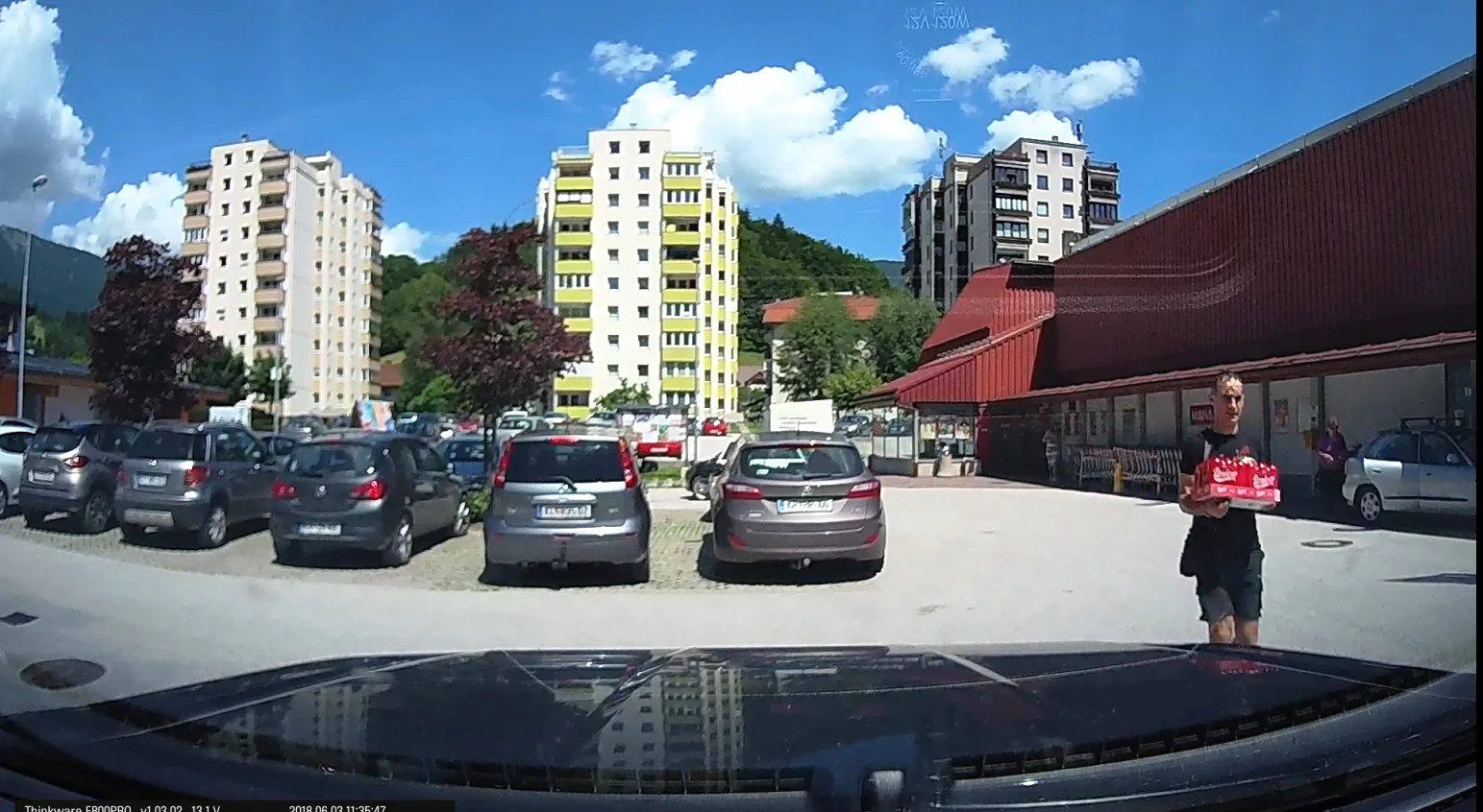

I have the same problem, but with Thinkware F800 PRO.I've already tried clean windshield, lens, reset camera, update firmware. I ll try to mount outside the car.
